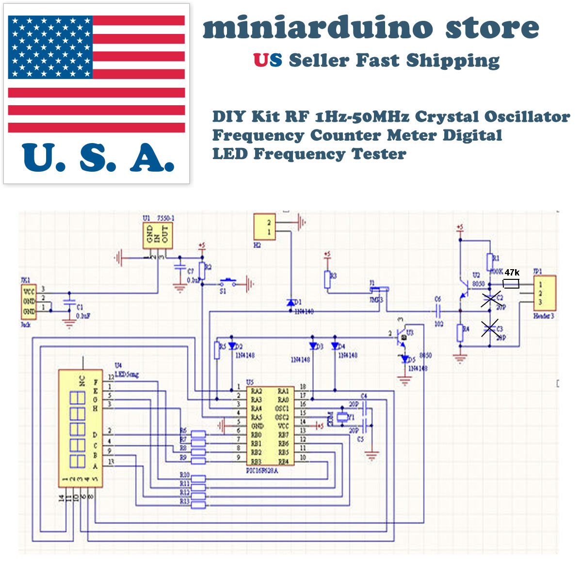

      bought this kit and soldered. in-general, this is a working set. but I got a stab 5 V, in TO-92, non-working. so first check the power. The stab was heated very much. I then directly connected it to the source and it just warms up and gives out 7 volts. Stab 7550 - the pinout is not the same as that of the 78L05.
      temporarily soldered 78L05. for a simple frequency meter, the board does not have a jumper to quickly switch the stone from the generator to an external frequency measurement. so you need to solder the capacitor that connects the emitter of the transistor generator to the pin of micro. the signal through a capacitor - so as not to burn the PIC. either from the generator on the transistor, remove all the capacitors except the output so that it does not generate.
      the scheme can not be found and the kit goes without it. but it's almost like a link. there is no jumper, on the diagram it is JMP3

                          • moded to simply a counter. its easely. just put SMD resistor in a track severing. desolder caps. change C6 on 1-10uF.
