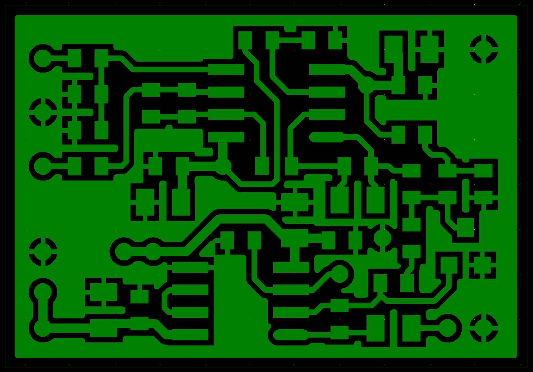

    As I understand it, isolation routing removes minimal amount of copper just to define the tracks/pads etc.
    Really cool stuff. There are specific bits used for this purpose. I think it is best way to make prototype PCB for projects.
    But CNC router must be very good one, not cheap China flexible.

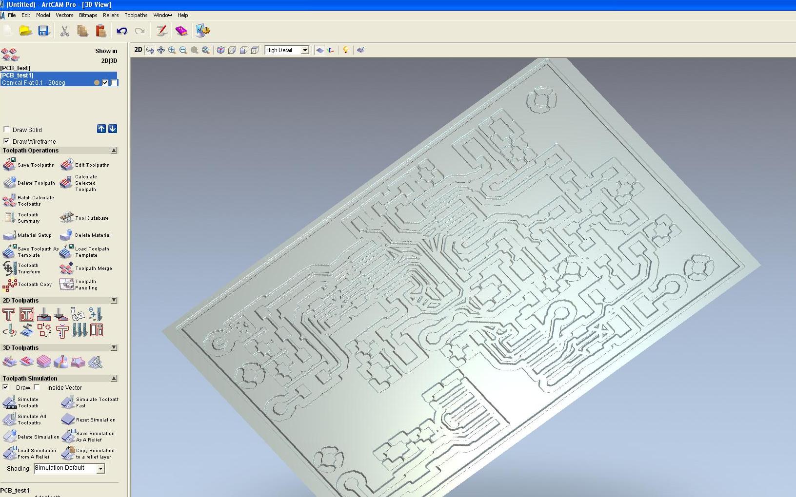

        I do all my single and doubled sided prototype boards using isolation routing on my CNC mill and either Artcam or occaisionally Flatcam software, the latter being free. It has a learning curve but not that steep.
        Artcam takes a good quality image file (Jpg, tif etc) and allows you to generate vectors then Gcode to drive the cnc.
        Flatcam takes a Gerber file and allows you to produce a Gcode file directly. I prefer Artcam but it comes at a cost...but i do a lot of prototypes so for me is Ok.
        Any reasonable quality (even China built) will work...the trick is to make it as rigid as you can and Very importantly have a good spindle and SHARP engraving bits..0.1inch 30deg type are fine.
        For some reason when I try to upload finished PCB photo it is all black...anyways, you can do some fine pitch work with isolation...if your 3D printer is sturdy enough you can even attach a spindle to that..something around 4-8,000rpm is fine.

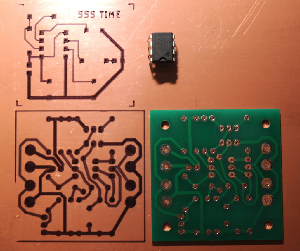

            0.5mm are the bits I ordered, im pretty sure any smaller then that, ill have a hard time drilling. Here some improvement to the drawing pcb, seems like most of the Cnc software that open .gbr Gerber files do isolation routing rather then masking, Even eagle seems to be big on having use make a board that way. Is there a good reason for this? other then it is probably easier to ink transfer or UV masking lol
            When I do my prototypes which are mostly SMD but often include TH components, I avoid drilling where possible unless its absolutely required for connectors or mounting holes etc, most things, even TH ICs can be soldered to topside copper, even wires and I use liquid latex to hold wires in place and as a strain relief. For me, they are only prototypes for proof of concept etc.
            Oh, and when I want holes, I use the engraving toolpath generated for isolation milling, to 'peck' centre marks for each hole and then drill as Waltr has described, then you don't have a wandering .2mm bit at drill time and less chance of offset holes and snapped bits.

                  I also use flatcam, But only to open a .gbr file and use it to make a SVG , but ill defently look in too Artcam.
                  This is the end of the line, as far as using the 3d printer as a direct ink pcb tool, Im actually rather happy with the results seeing it being done on a 4 year old printer that hasn't gotten a lot of maintenance over the years.
