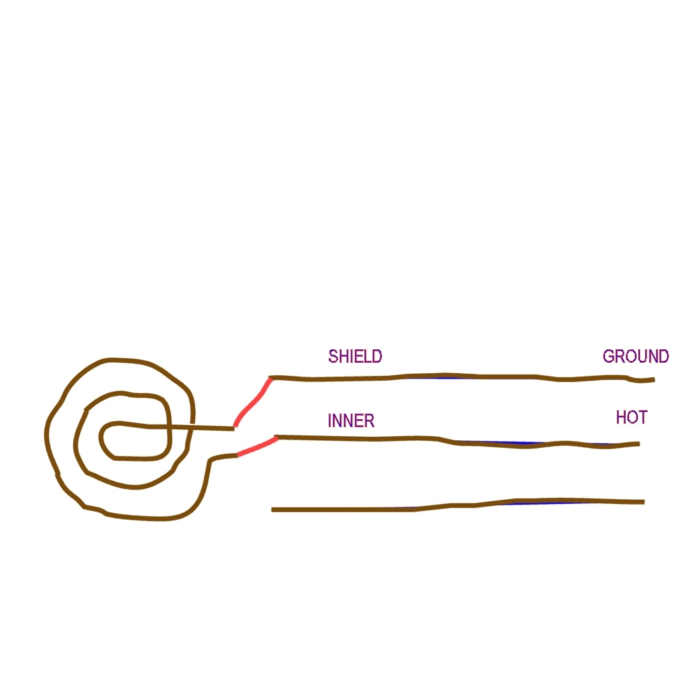

    1) I want to 'finish' it nicely. I tried to connect an RG6 cable instead of using regular single strand wire. I haven't been able to get it to work and here's where my lack of electronics knowledge comes in...to the right of the 'coil' pins on the pcb, it says "GND". I assumed this meant that the right pin was ground and so I was connecting the RG6 outer mesh there and it wasn't working. When I look up 3296's on the internet, it looks like pin #3 is ground, which I think means that my assumption about which "coil" pin was ground would be wrong. Which pin is ground, and how can I tell - I tried to follow traces but still wasn't sure? Is that why the RG6 didn't work for me?

        If you take your multimeter in continuity mode and put one probe on your ground connection on the PCB and then test both coil connection points the one that gives you a tone will be the one that your cable shield should connect to.

            Thanks for the info! I've read the adrianandgenese more times than I will ever admit to. It covers a lot regarding building the surf pi, but he doesn't answer a lot of questions that I've had (and still have). I originally tried to make the coil with stereo wire like he did. I think I did a decent job (after a couple tries), but I couldn't get it work, however when I used plain enamel coated copper wire it works fine. And when I try to use a RG6 cable like he did, I don't get a response from either coil I've made. Stuff like this confuses the hell out of me and makes me wish I studied engineering instead of useless business! But seriously, thanks for the tips.
              The one I have has a thick, single copper wire in the middle. Then the plastic-y stuff (dielectric?). Then the outer mesh.

                      RG6 is over kill for this project but use what you have , check the cable and coil for continuity, make sure its not open circuit or short circuit
                      here our grand son made you a picture.

                          What should I use to connect the board to the coil. It works with just regular 24 gauge, multi strand wire...but that can't be the optimal, can it?
                            Haha! Please thank your grandson for me! Maybe I misunderstood, but I thought that the guy who sells the kit told me it didn't matter how it was connected since it was just a simple mono coil. ???
