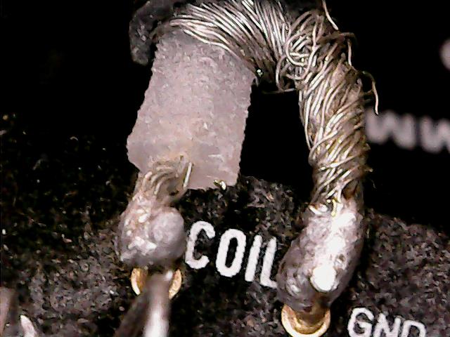

    Well, I thought I'd just throw it all together and try to go use it outside. Apparently, I KILLED IT (again) somehow, maybe playing with the coils.
    I don't know much about electronics, but here's what I found so far with multi-meter. The battery inputs to the board shows about 11.5 volts. The ICs all seem to have both positive and negative ~4.5 to 4.97 volts. When I turn it on, there's a beep then silence. the offset is tuned to roughly 0.00 volts. So those things are good. When I wave metal above the coil, the voltage doesn't change.
    So I'm not sure what's next...Previous times I replaced the transistors which was really just a guess and sometimes worked. This time I'll probably try the same thing unless someone else can teach me something else...

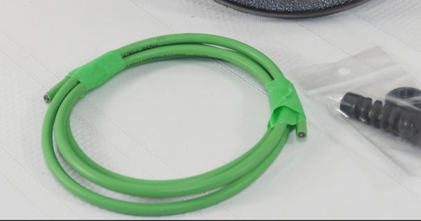

      Thanks for the link. Can you please explain, just so I understand, why is RG58 better than RG6? Is it because it's copper? I can't tell if it's multi stranded or not...

        I just replaced the 2n3906, the 1N4001 diode, and the LM78... Now I have no sound when turning on or off or turning delay. I hope I'm not overlooking something obvious. I replaced the batteries and they test fine.
          Also just replaced LM358 and the 555. Nothing... I was so proud of myself that this thing was working...that'll teach me!

            RG58 is light and flexible, has a tinned copper shield that is easily soldered no foil, multi strand inner conductor, non magnetic, its no harder than the picture.
                RG-58CU
                https://www.westmarine.com/buy/ancor...02?recordNum=3
                If you read the specifications chart in the link it clearly shows the differences between the cable types which is why I posted it. RG58 is multi-stranded as shown in the table.
                    Thanks everyone for the info about cable. Unfortunately I haven't been able to figure out why the device no longer works at all. I'm not sure what l broke, but I suppose using coax cable doesn't matter much of I can't figure out what is broken, and it seems silly to just keep replacing parts hoping it will fix the problem.
