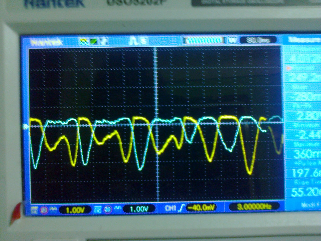

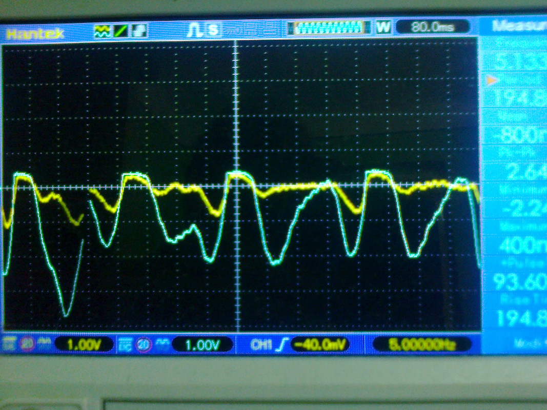

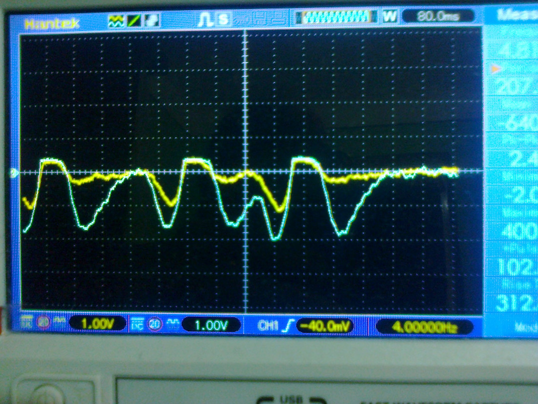

                      Did some measurements today, and had some interesting results. Using the oscilloscope it's easy to see the differences between the reaction of Geb and Disc channels to different targets that pass the coil.
                      These are: Iron screwdriver, Alu pulltab, 1Euro, and an old Silver coin.

                      There is amplitude difference between non ferrous targets, and there is amplitude phase difference between the 2 channels if ferrous objects are detected. I think this needs to be measured somehow apart from signal difference to discriminate iron with analog VDI.

                          I have tried it , really happy about my o-scope! Forgot to tell, Blue is Disc and Orange is Geb channel. Pure ferrite makes some insane amplitudes in the Disc channel only, so I think even the VDI should be ground balanced somehow, will see. I was thinking about a phase difference detector to cancel out ferrite and iron objects with logic gates, I don't want to copy Whites stuff.
