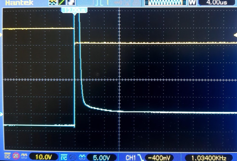

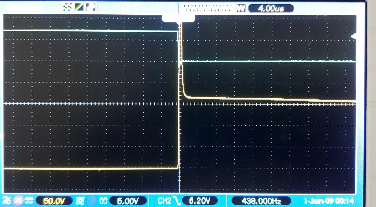

                  The first suspect was the floating signal ground as you suggest. But it's actually quite steady, it stabilizes at 4us from the switch-off. That's far from the 40us delay I'm getting at the amp.
                  Top: gate signal.
                  Bottom: floating ground.

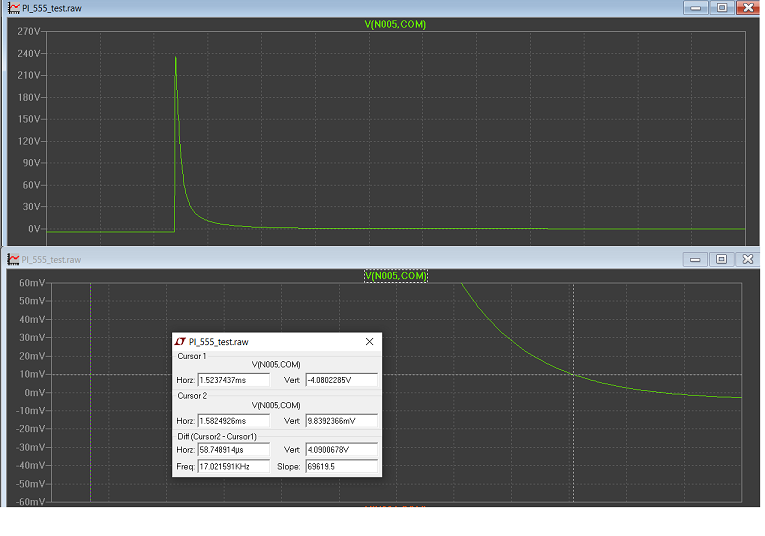

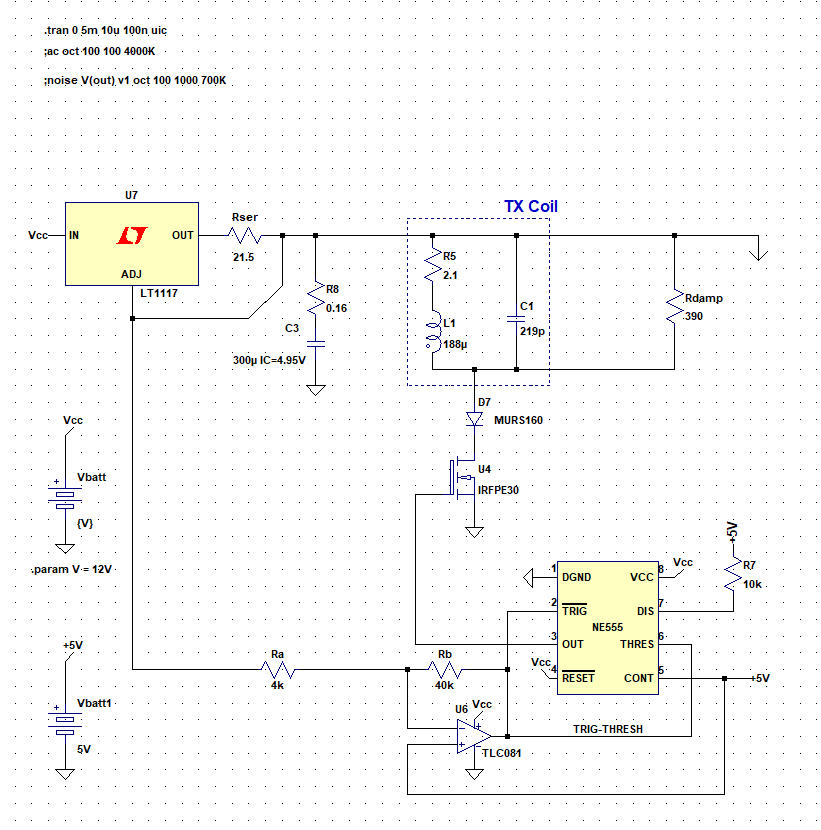

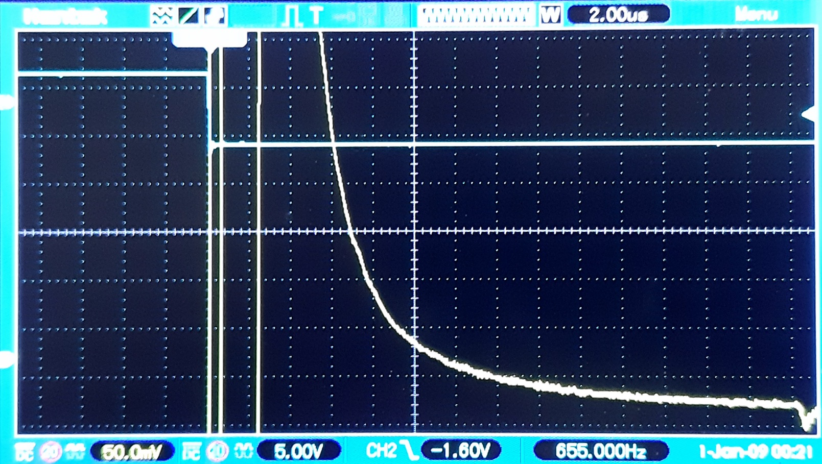

                  Next I disconnected the amplifier and just placed a 390 Ohm damping resistor across the coil as in this schematic:
                  The coil decay looks strange, not like an exponential. The reference is the signal ground, so any variations of this ground are cancelled.
                  The voltage at the node between the drain and the diode settles from 650V to 150V in 4us and then slowly drops. There's nothing funny between 4us and 40us, so it cannot be the cause.
                  I've tried adding parasitic caps and inductances to the circuit in LTSpice to try and duplicate the fenomenon but to no avail.
                  I have no clue as to what is going on!

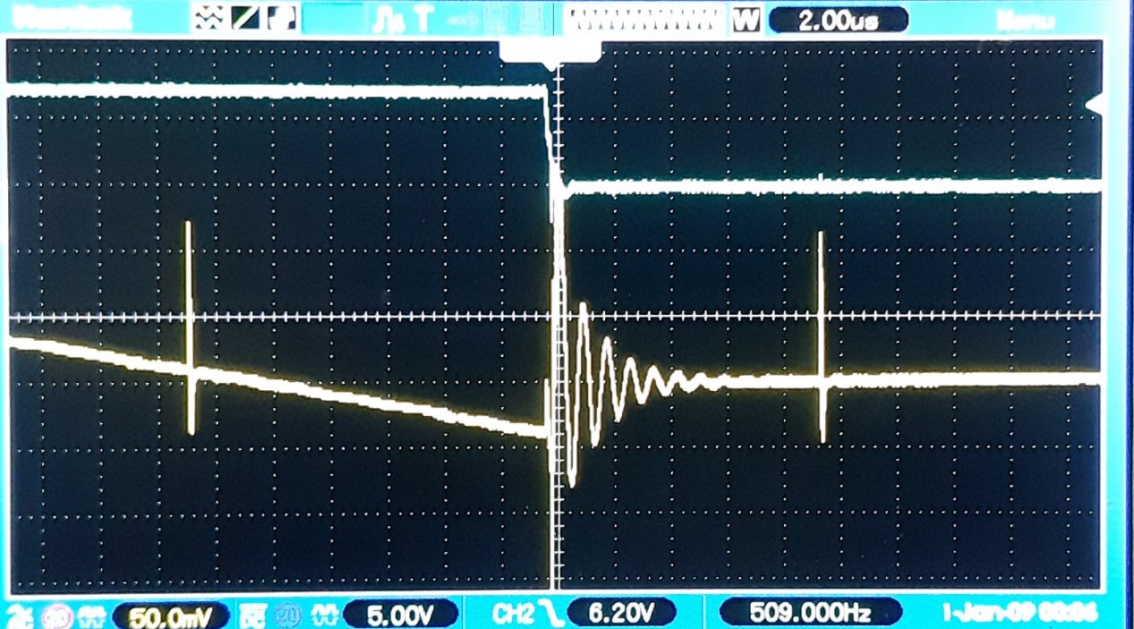

                    This is the timing I got now. It has improved from 40us to about 10us
                    See the glitch on the lower right corner? That happens whe the charge at the drain, isolated by the diode, stabilizes.
                    I replaced the MOSFET by an IRF840. The problem was the original MOSFET had a too low capacitance! This caused a fast decay of the charge, especially at the beginning of the transient, that was feeding through to the damping resistor.
                    It is very important for early sampling that the charge at the drain be as stable as possible. A larger capacitance helps, a paradox. Probably it would be even better to use an external snubber.

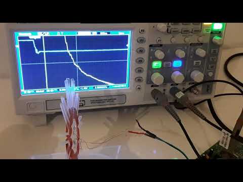

                        Update: after all it might have been the flux.
                        The blocking diode I've used is SMD and as a result of my soldering attempts it was bathed in flux. Because of the high voltage involved and the carbon content through burning there's a very good chance it became conductive.
                        So I went to LTSpice and placed a 10K resistor across the diode and ... voila! the signal took more than 40us to decay to the 10mV level.

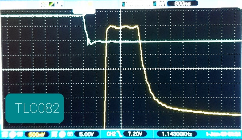

                            After removing all the flux remains I've soldered back the original components: SPB17N80C3 MOSFET, Logic_level 800V, 0.3ohm in series with a diode MURS160, 600V, SuperFast 50ns, 10pF. It works fine now.
                            A 90uH basket coil and a TLC082 as preamp gives the following trace:
                            This configuration is able to see my test gold nuggets of about 0.1 g.
