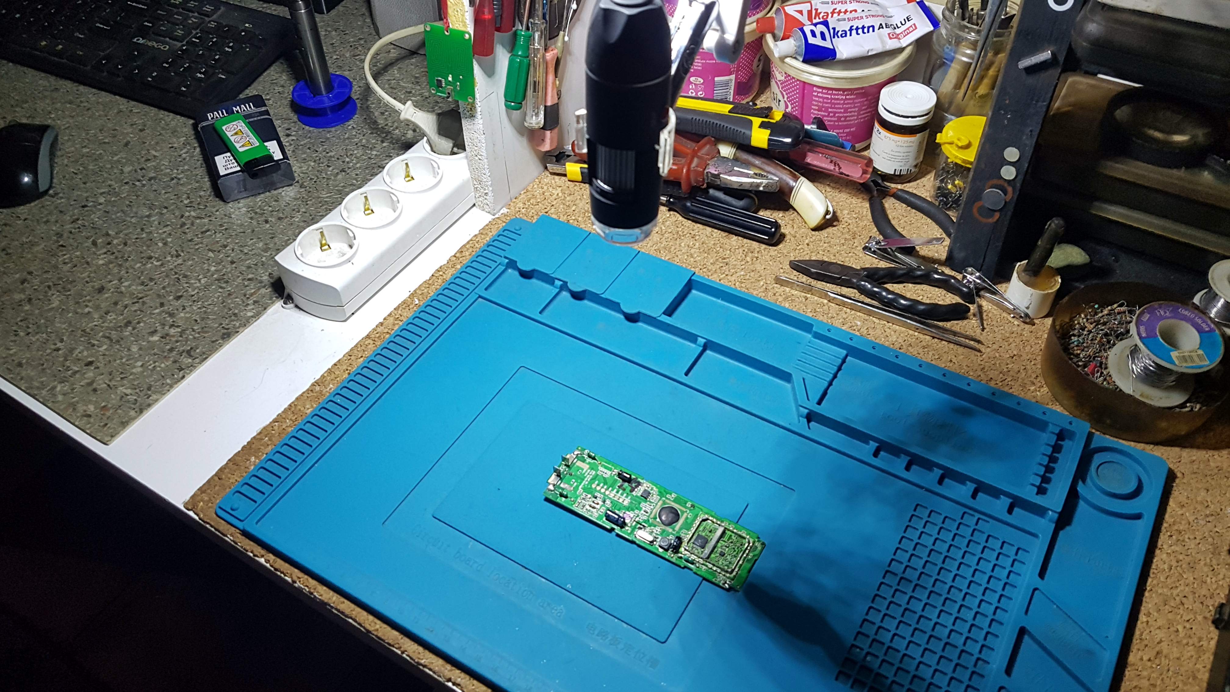

      I forgot to mention that I also got a cheap microscope too!
      So now I may be considered as "heavily armed" electronic hobbyist!

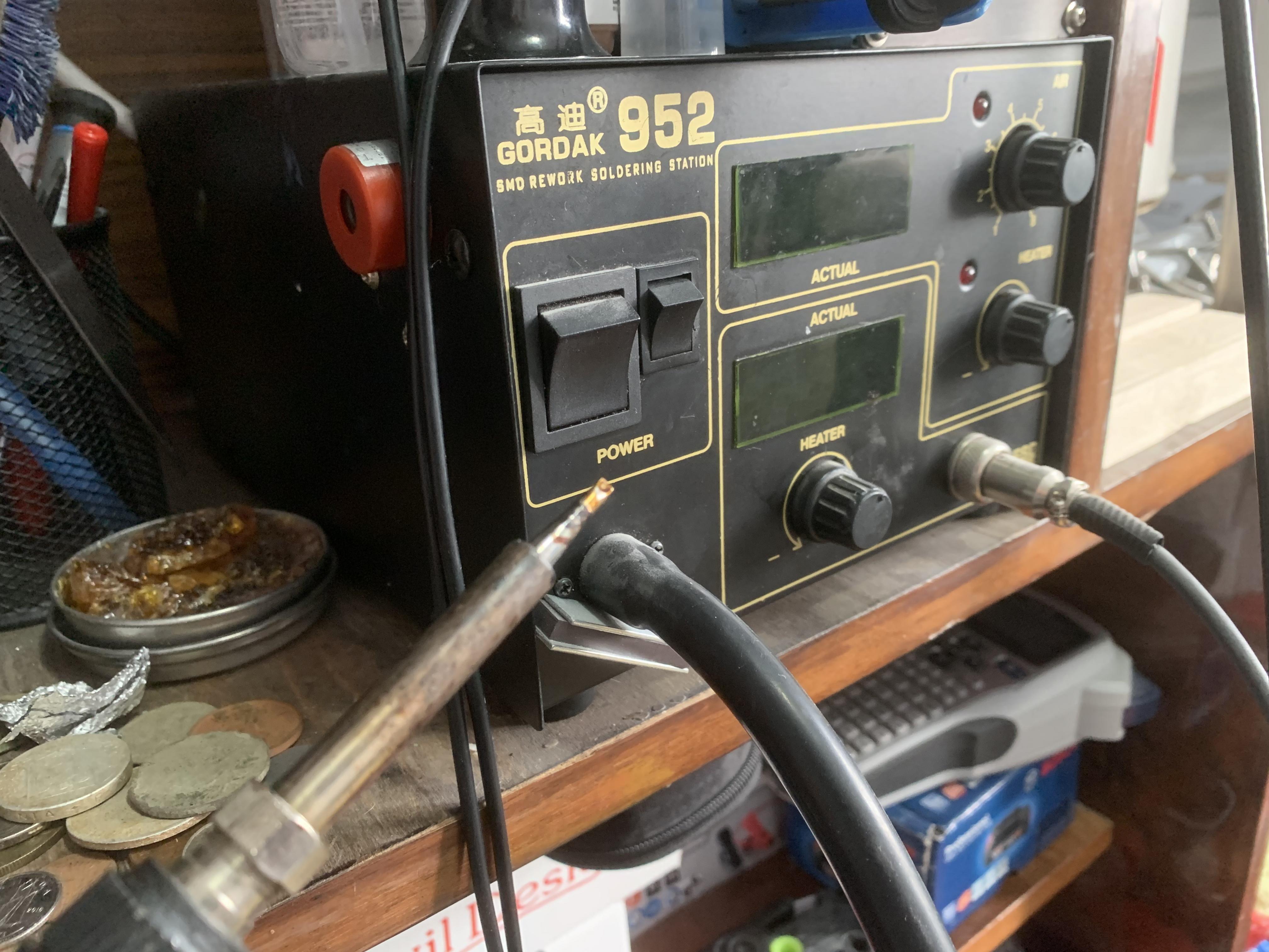

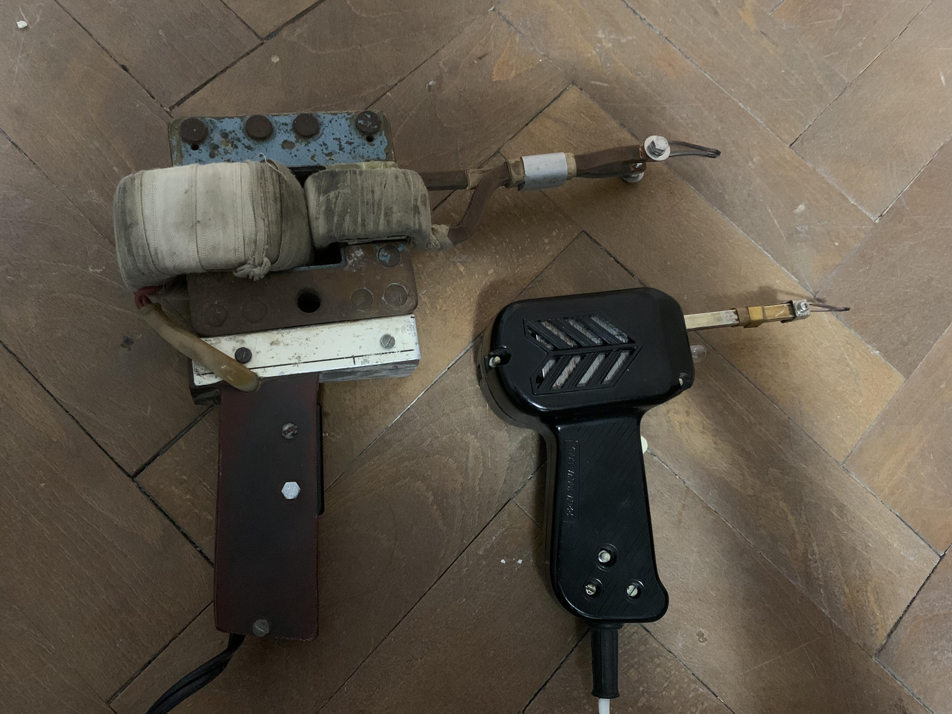

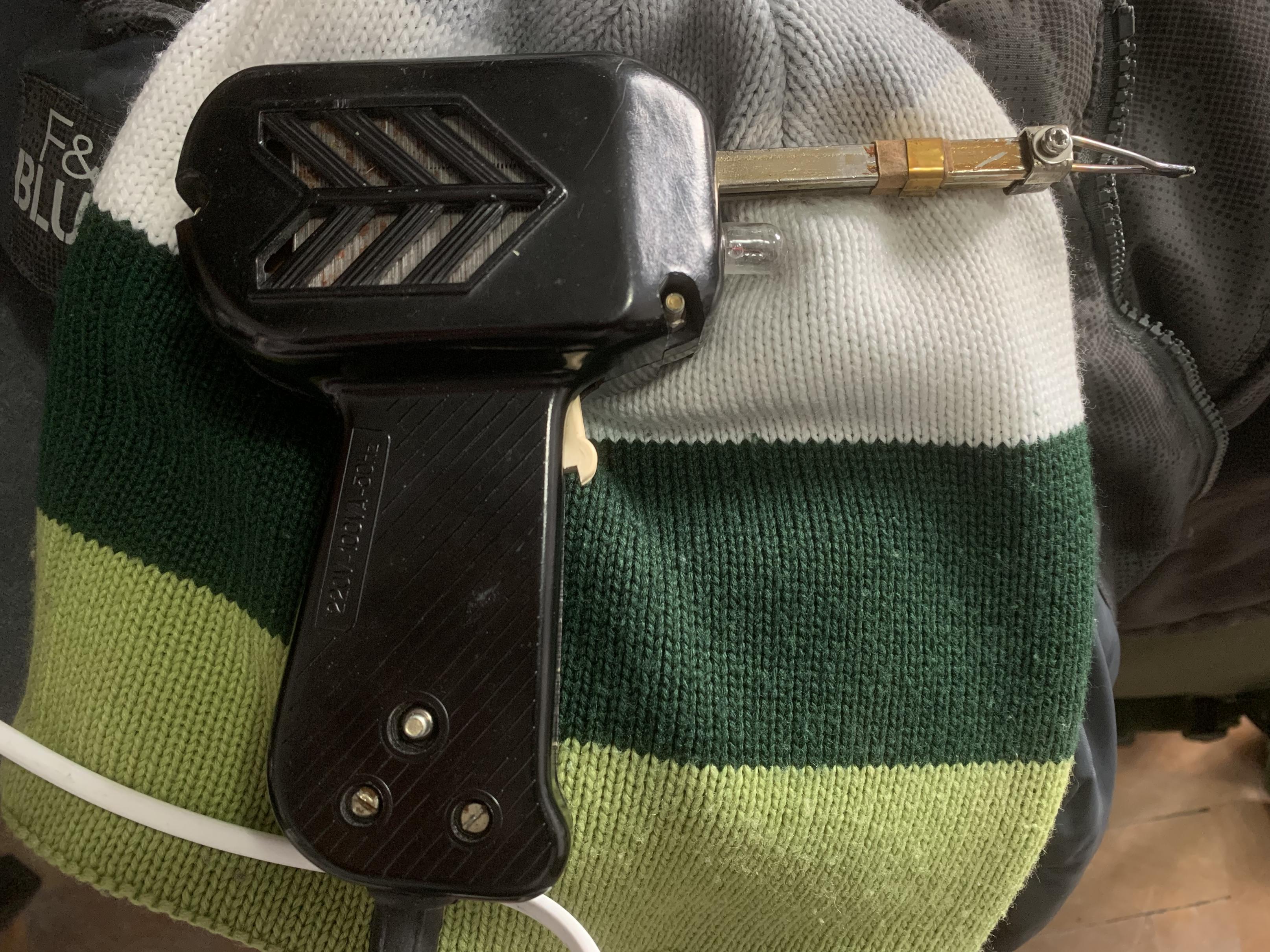

        I have this gordak station from more than 10 years. I mostly use the iron, with different tip (round and chiesel) size for different applications (thru hole or smd). Flux will help for a good soldering and prevent solder bridges. Last year the temperature sensor from inside the iron broke up, but i managed to find replacement (ceramic with heating element and temp sensor) on aliexpress. The temperature stay around 320C, but is not correct.. otherwise will not melt the solder correctly.
        The hot air gun i use only for desolder smd components (and sometimes to heat the shrink tubes). You need to find right temp and air for that. I keep the small nozzle attached. To prevent heating other components put some aluminium kitchen foil/ thermal tape around the component you desolder. Make some tests on scrap boards. Some smd components are hard to be desolder because they have a layer of glue/varnish on top. I also bought some paste of flux/sn/pb to glue components, but i’m not impressed, so i prefer the iron.
        Thin soldering wire (<1mm) will help and sharp wooden toothpick sometimes to undo the solder bridges.
        Last but not least i use old soldering gun (100W) with bachelite case.

          Thanks!
          I think I posted about Gordak long time ago... not sure if I really did, so here it is again: once I serviced one Gordak and used that oportunity to trace it out and make schematic.
          I believe it is the very same as yours, except for the LED display part.

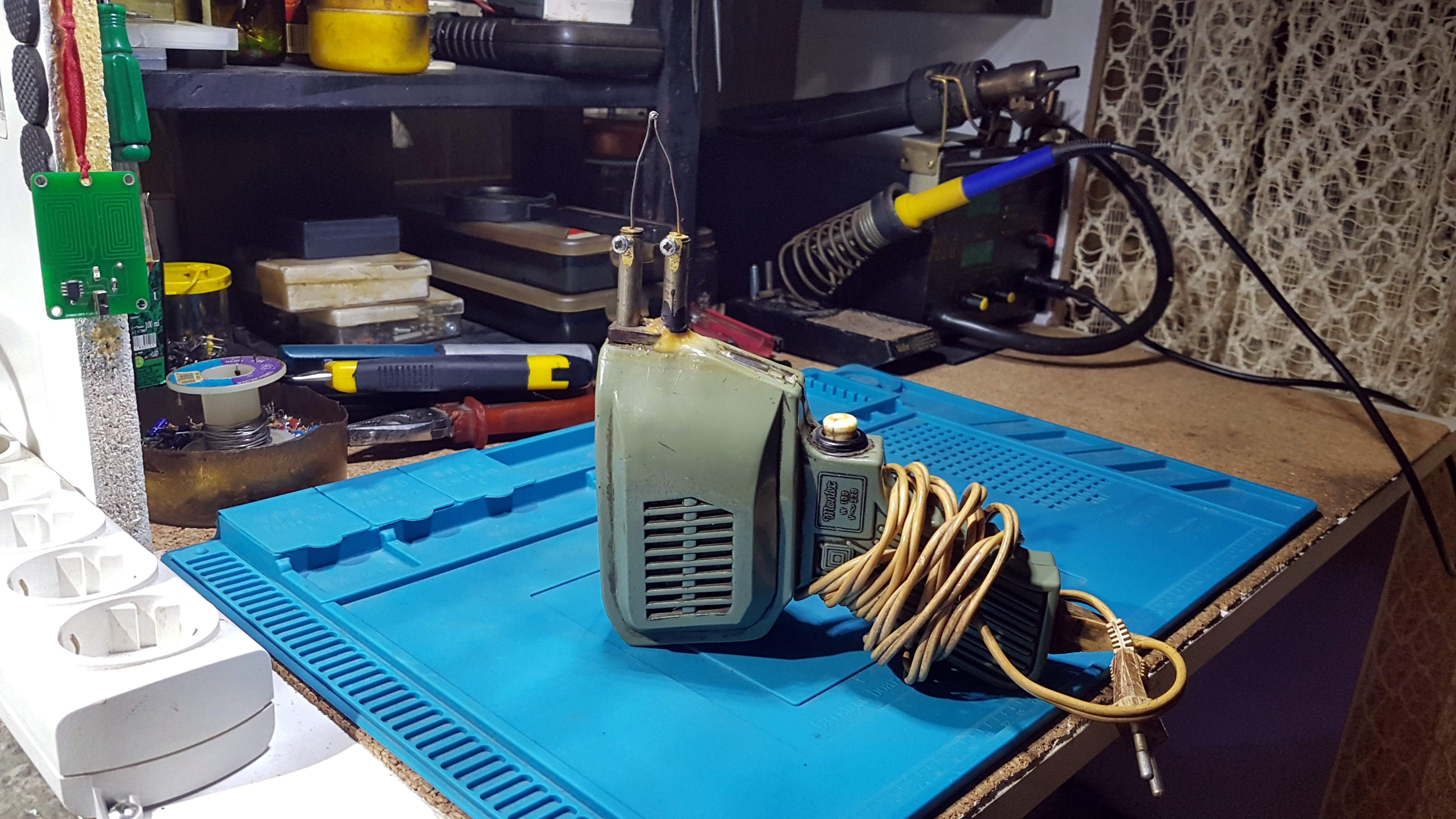

          "...Last but not least i use old soldering gun (100W) with bachelite case..."
          Hell YES!
          When the going gets tough and no other tool can solve the problem; yes there always be good old (40 years and so) 100W bachelite case soldering iron!
          It is the ultimate tool in my workshop!

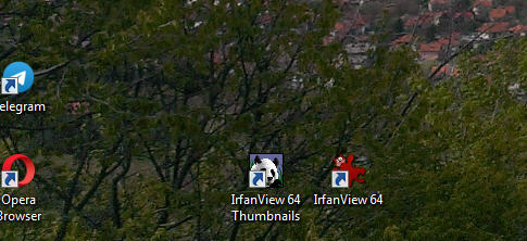

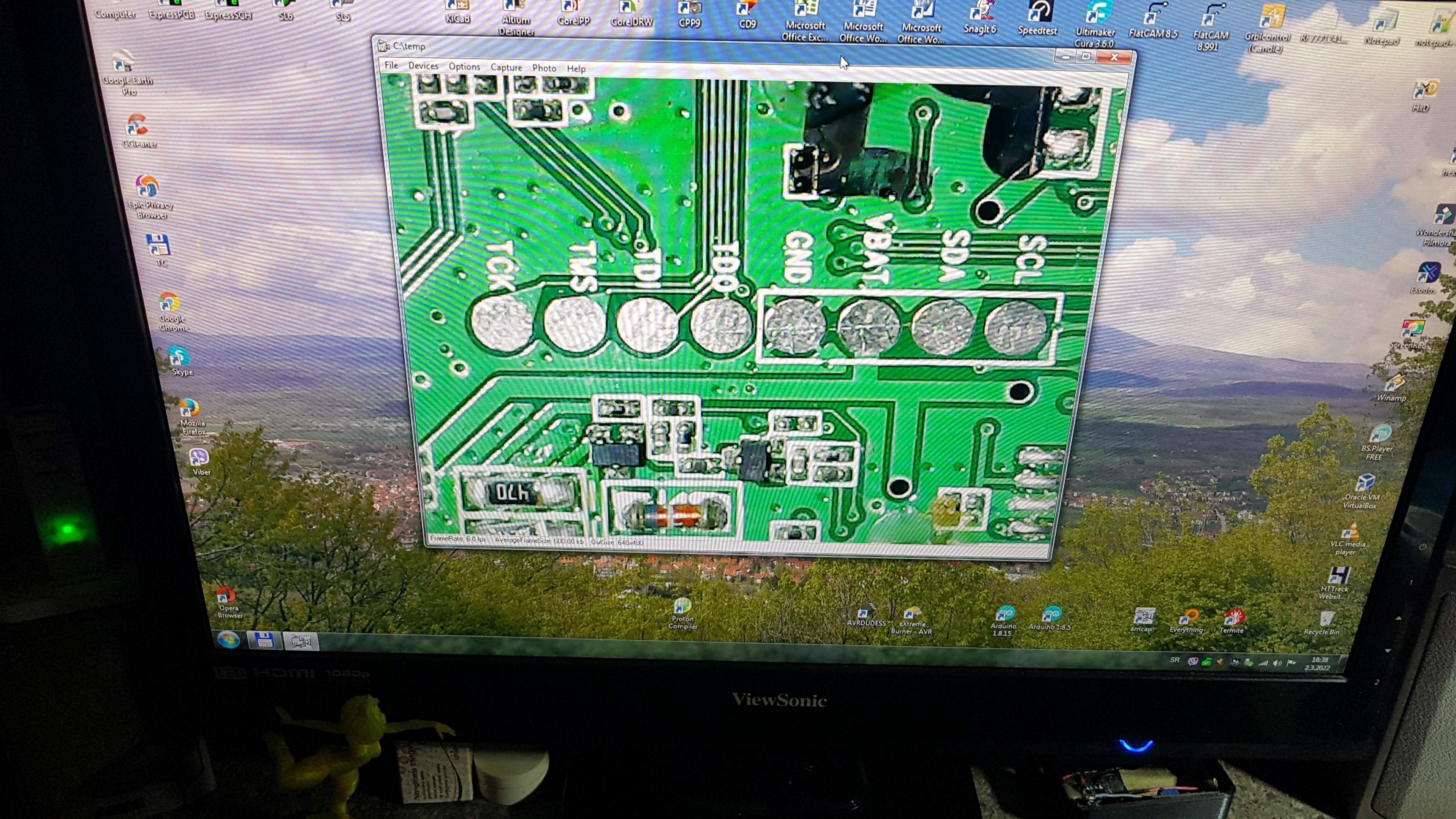

                Hello Ivconic, I did not see on your desktop the icone of IrfanView, one of the best editor photo!!!
                  Only 40% of installed software is visible on the desktop, the most frequent in use.
                  But you are right, i don't use IrfanView, although i have it somewhere in the backups.
                  I use Corel package for such jobs. Corel 9 and Corel 2017, both on my system.
                  Lately when it comes to technical drawings with simple curves and shapes; i use Sprint Layout!
                  I never focus on tools but only on final goal.
                    I just added it:

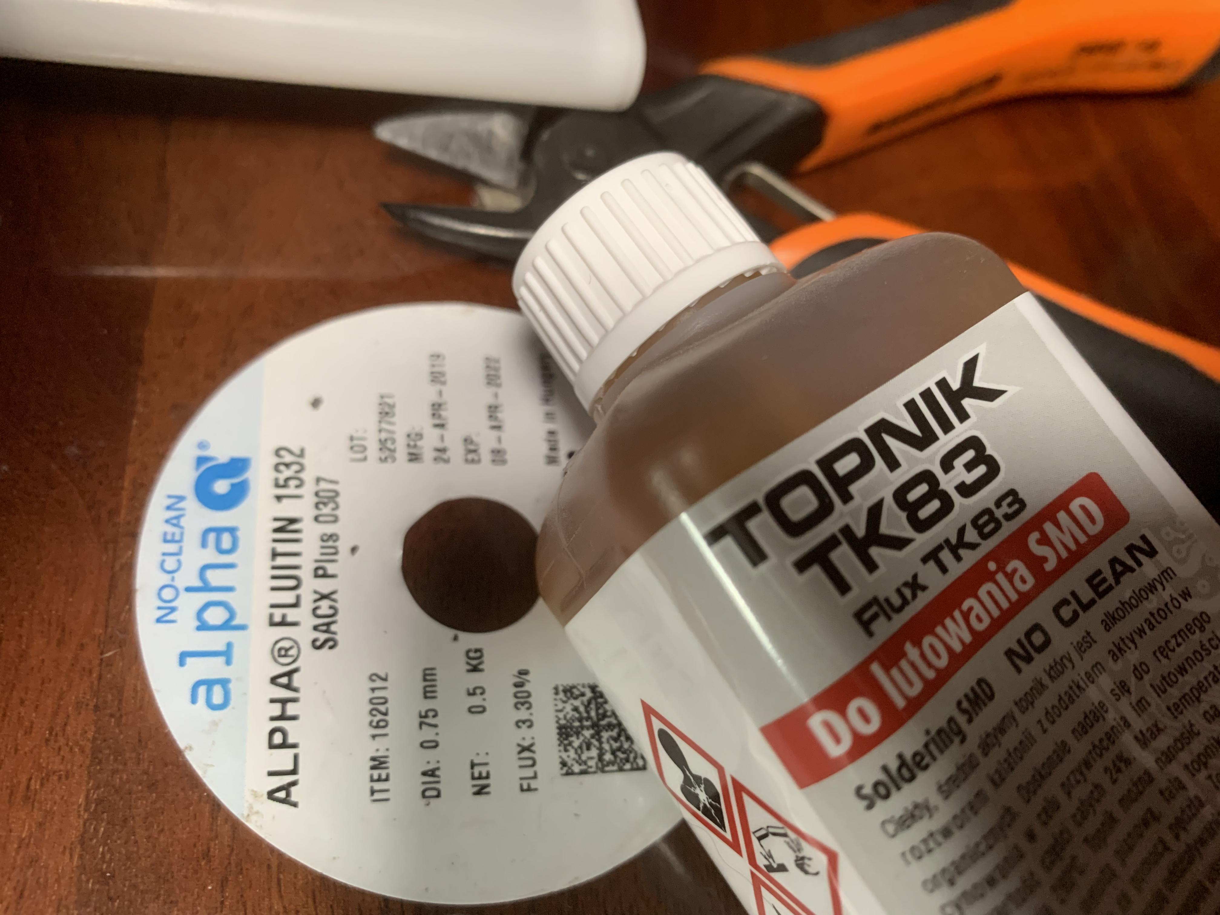

                        put a couple of layer of kapton tape over the areas you don't want to heat
                        watch for small components directly underneath that could drop off

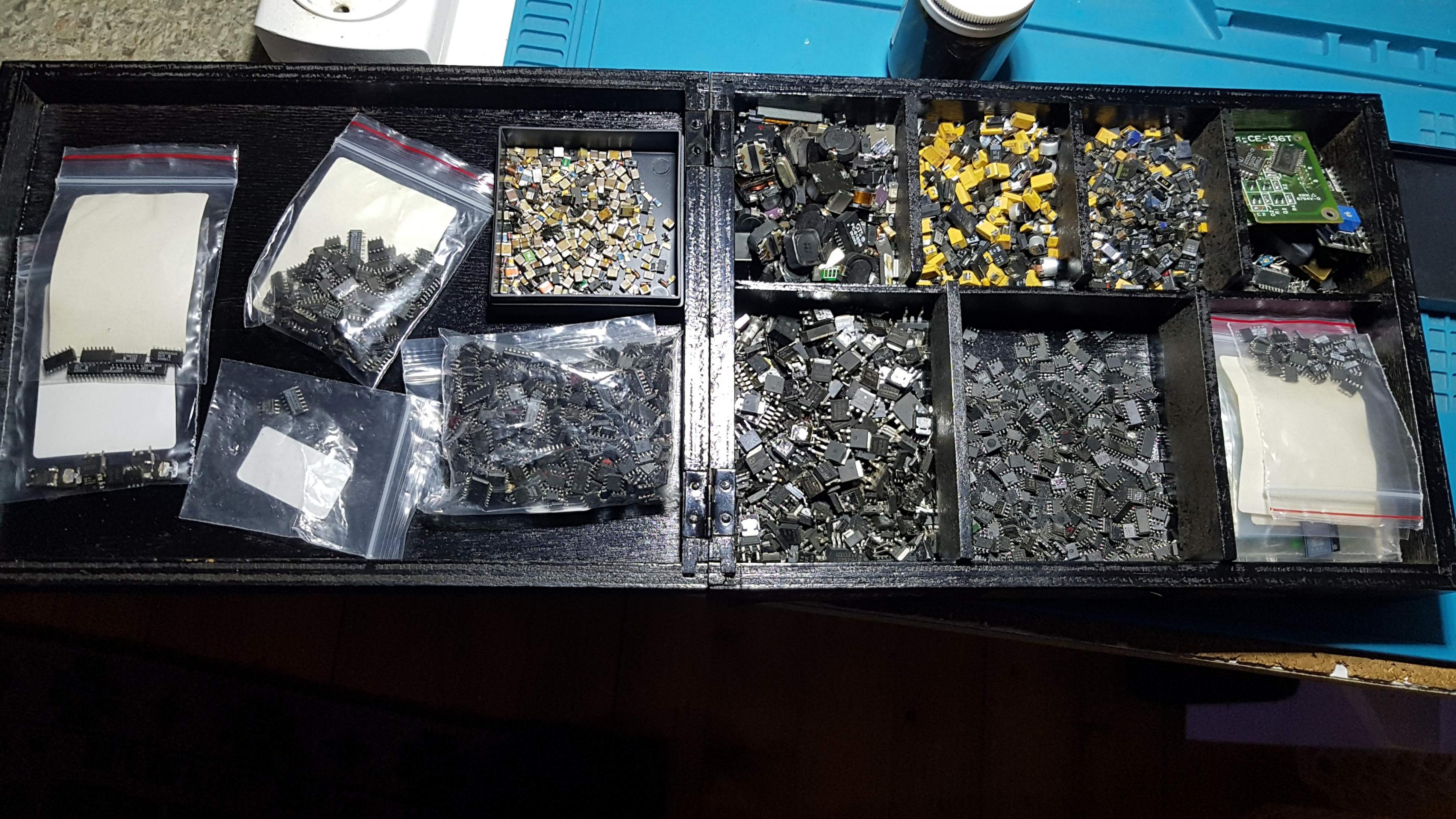

                            10 days of "playing" with reworok station... and already collected decent batch.

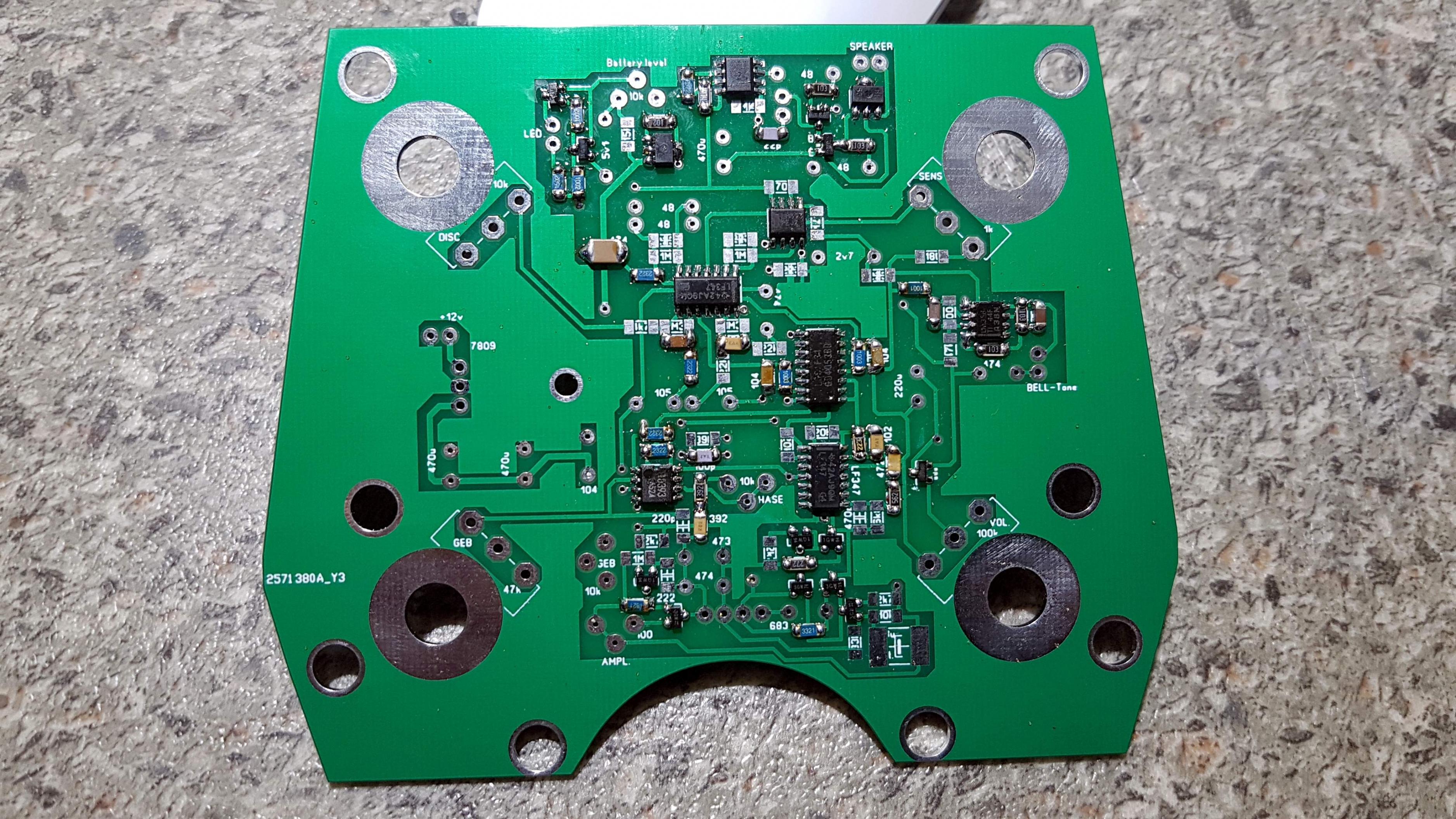

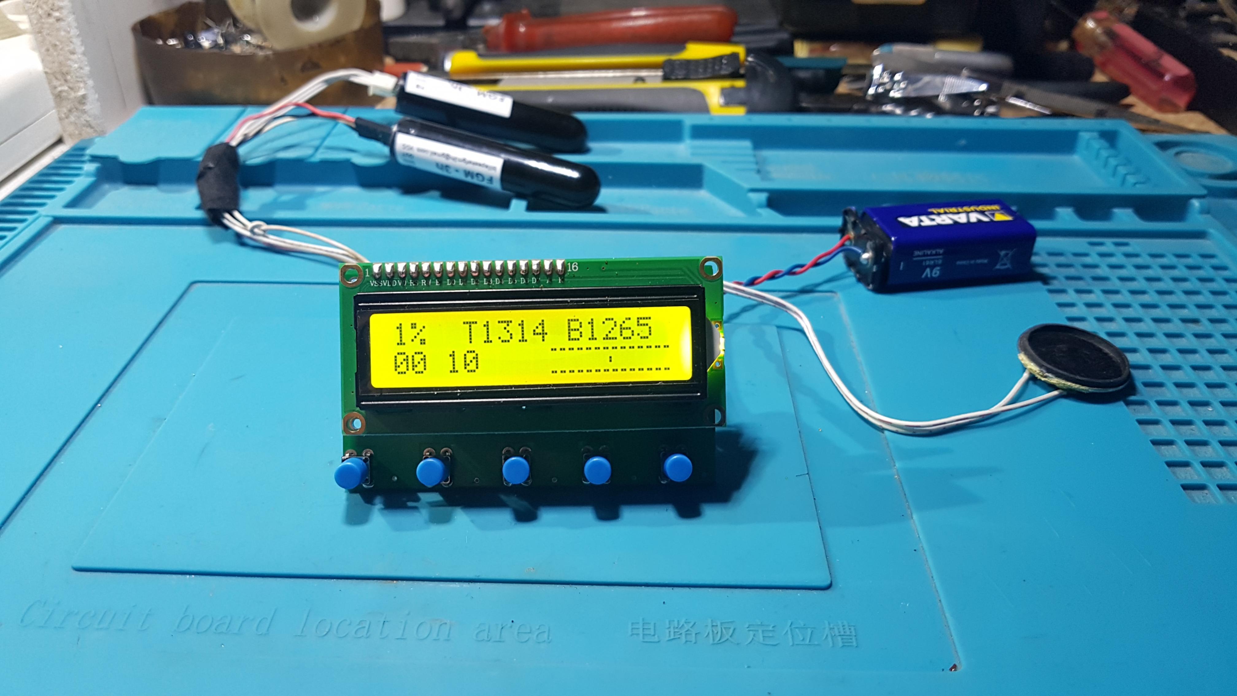

                            And one finished magnetometer pcb and SMW in progress:
                            (There is a big neodymium magnet on the table above, which obviously has a strong effect on the sensor reading !! I didn't pay attention to that, I'm only now noticing in the picture!)

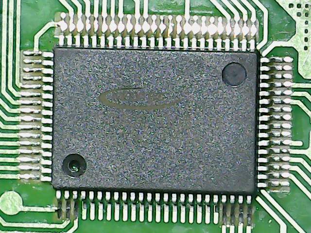

                              I noticed some things in my work with SMD components and rework station so far ... in amateur conditions:
                              integral circuits, chips, are easier to solder with the help of liquid tin.
                              I smear the solder places with liquid tin and put the chip in place, I heat the chip and the solder places with hot air
                              and everything "lies" in its place. It seems that I did not buy quality liquid tin, because it turned from the mass into very little solder material.
                              So after that I add a little tin to each leg with a soldering iron.
                              The chip is definitely well soldered ... but it looks "thin" to me, so I add tin to "see" ...
                              But only now as I look at these pictures; it becomes clear that I overdid it with tin, too much tin was applied there.
                              And individual components I do regularly with a soldering iron. I haven't even tried liquid tin.
                              Because I'm sure the components will "slip" no matter how much I adjust the airflow to be weak.
                              I think it is a question of poor quality of liquid tin, I will have to try some more expensive variant.
                              As for the "collection" of SMD components that I have collected in the last 10 days: there is everything and everything.
                              I separated the "special" components into bags. I found some very high quality operational amplifiers, for example.
                              There is also a bunch of mosfet in different combinations. Various voltage regulators. High quality unpolarized capacitors.
                              And I also separated 6 pieces of ADG201 switches. Here, according to local shops, they are both rare and expensive.
                              I have the biggest problem with small transistors. It always grab the tweezers because the tweezers seem to be "magnetized" somehow ??
                              So it slows me down by removing components and generally annoys me and makes it a problem. I'm going to have to come up with a method to get over it.
