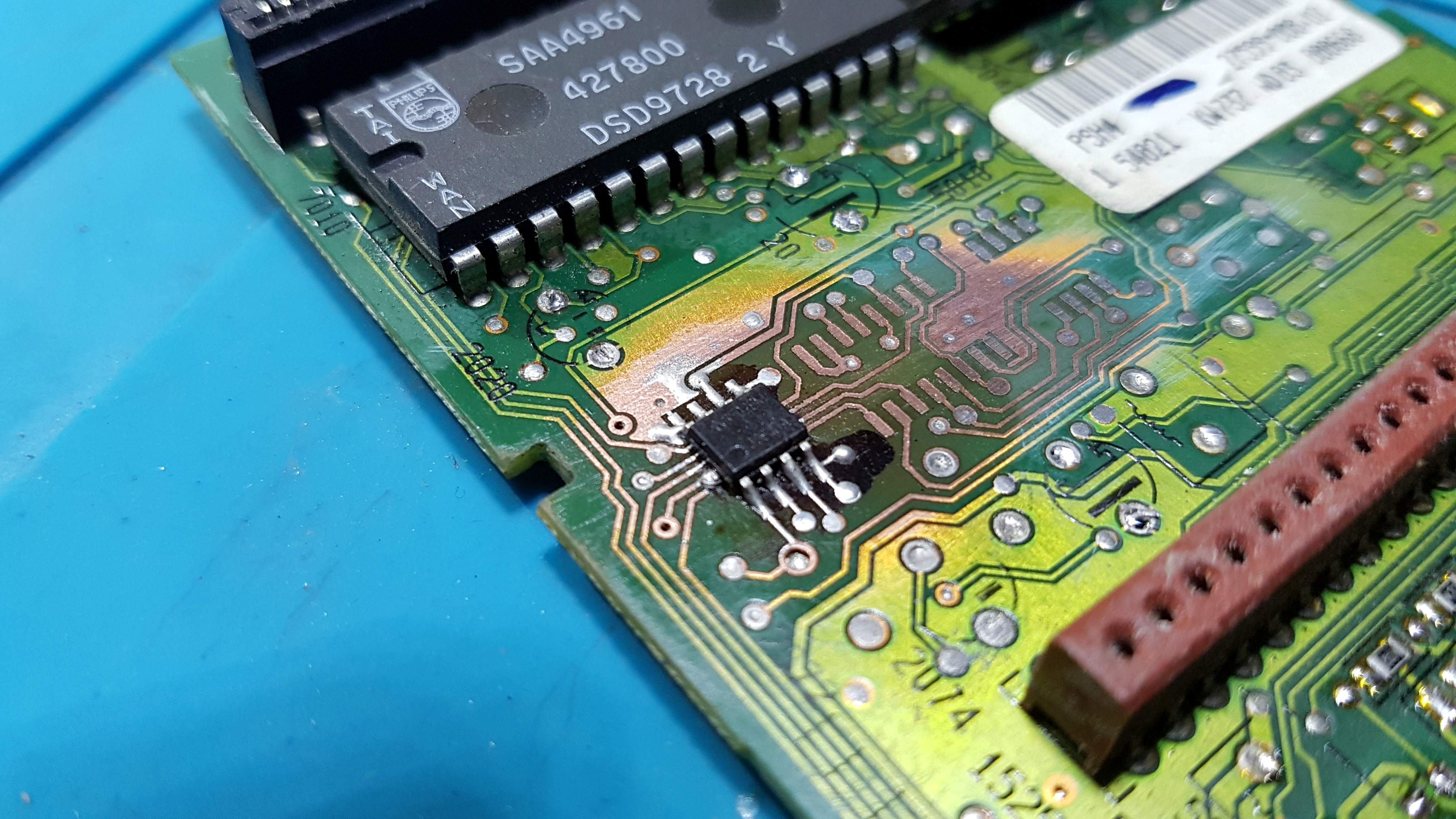

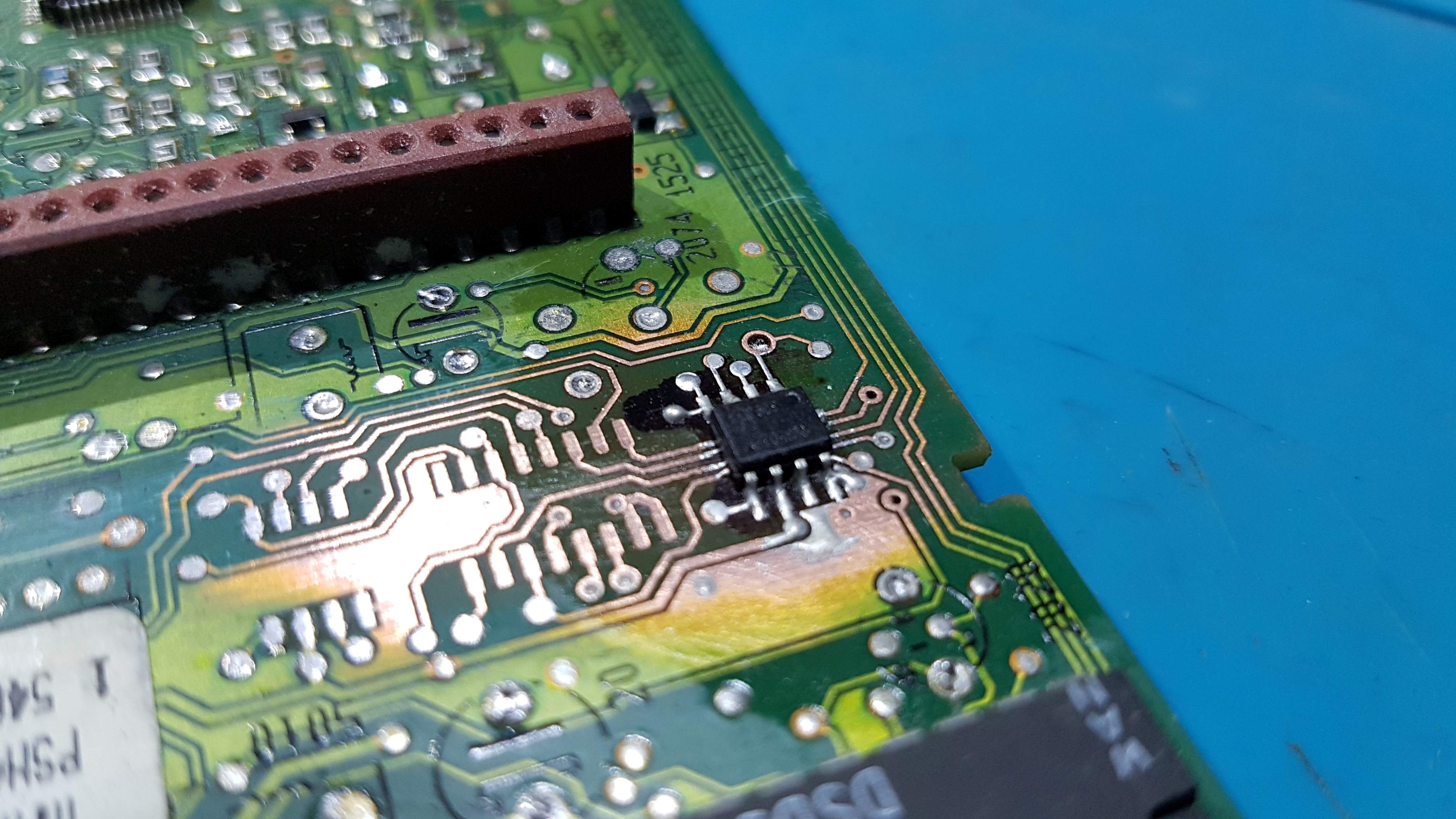

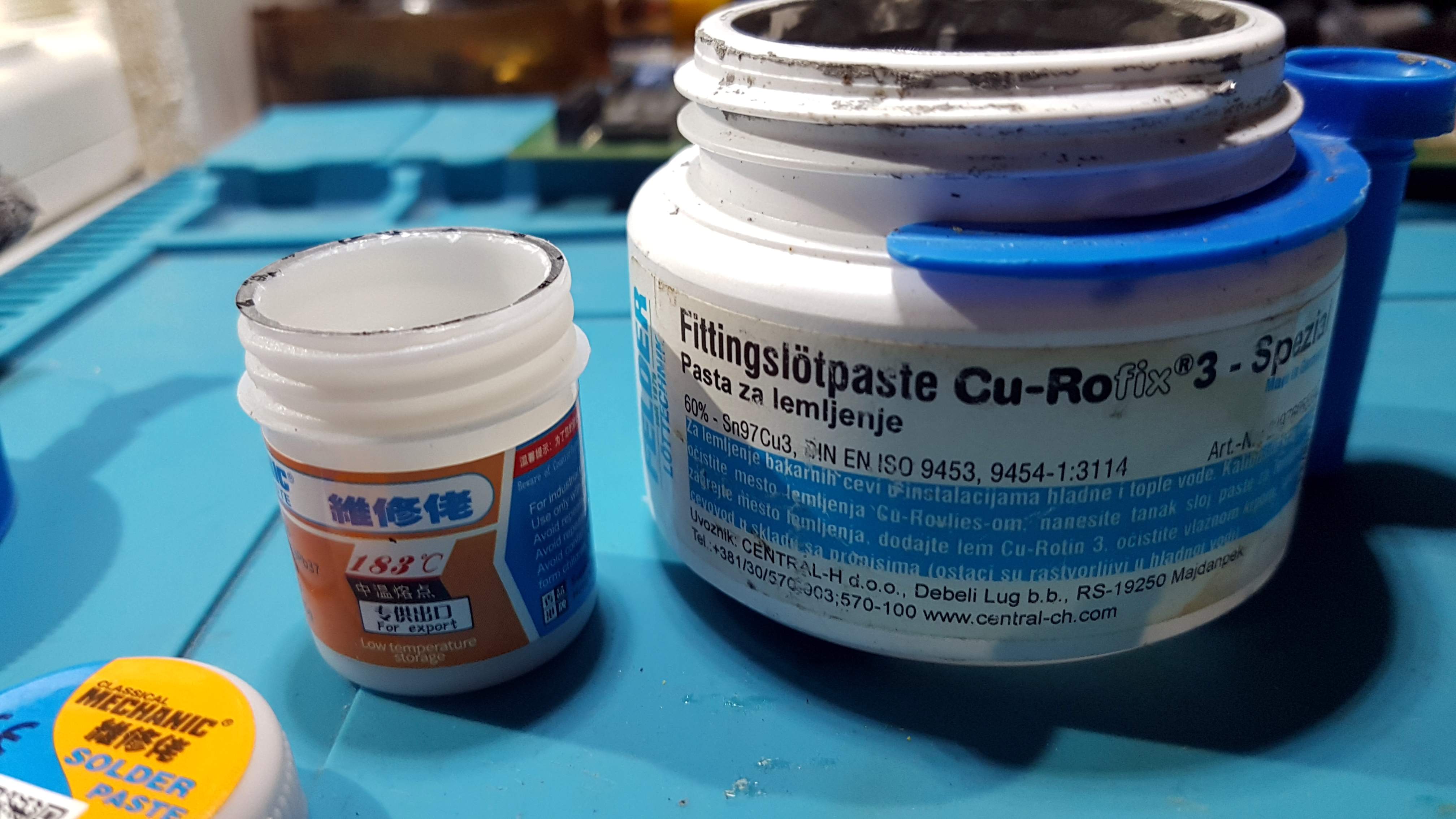

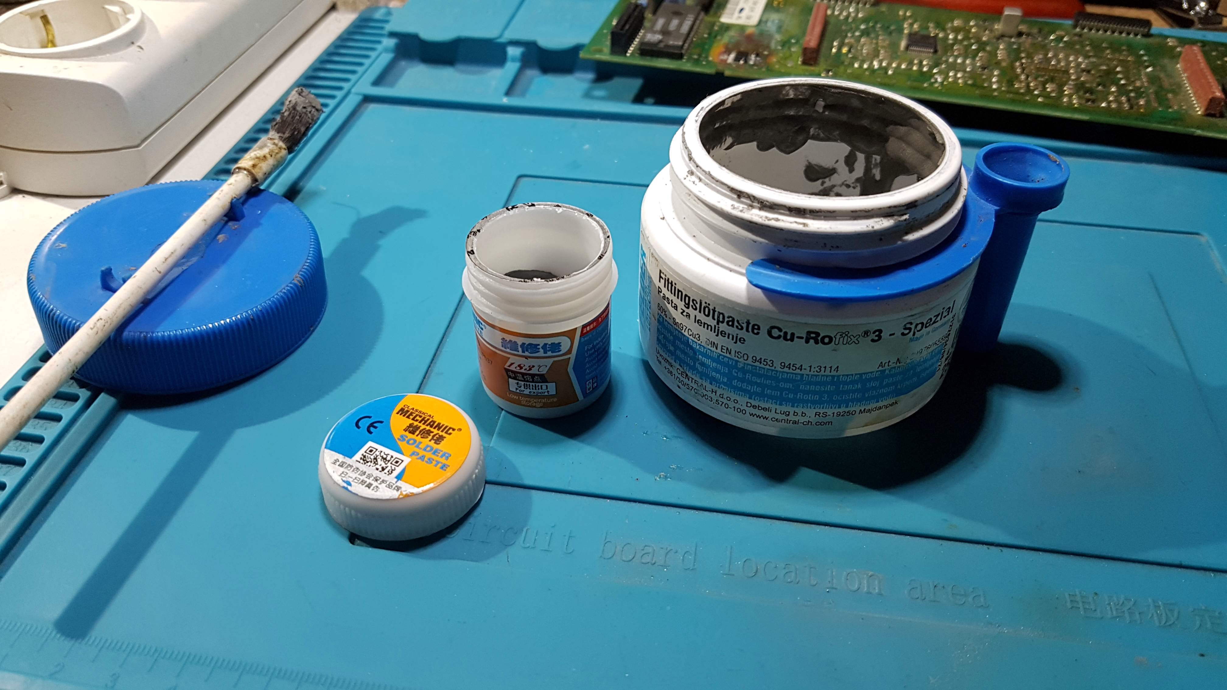

          I did a crazy experiment and now I'm amazed ... the opinion of more experienced colleagues is welcome here ...

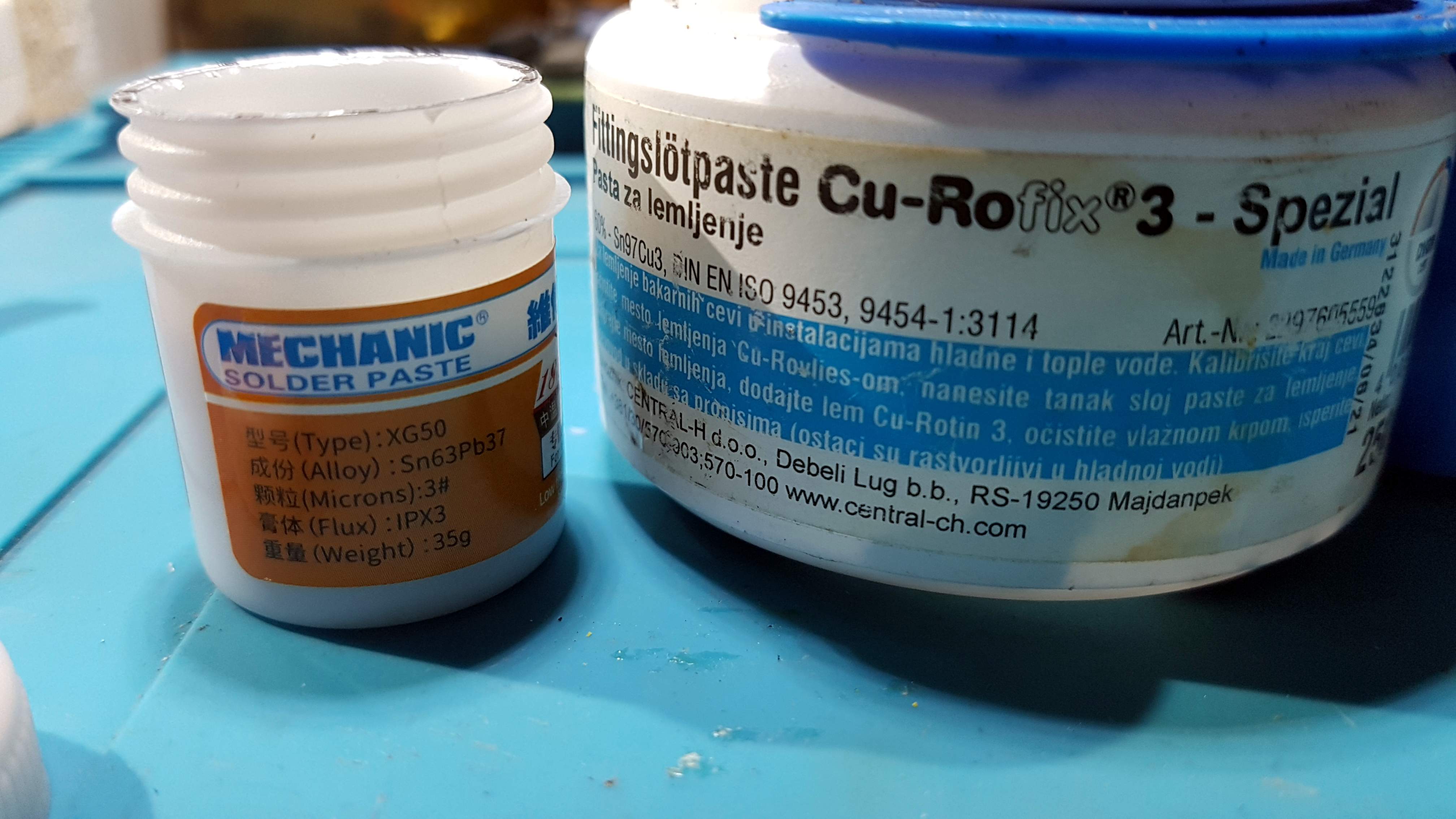

          Namely, my friend is a expert for central heating works and he welds copper pipes with some "paste" that reminded him a lot of the look of my liquid tin that I recently got.
          We agreed he to bring that "paste" that he uses, me to look at and check.
          Because that "paste" costs about 10e for 250 grams. While my liquid tin costs 5e for 35 grams.
          He brought it today as well. Indeed, both substances look pretty much the same. The composition is written on the box.
          No lead but some copper in the tin.

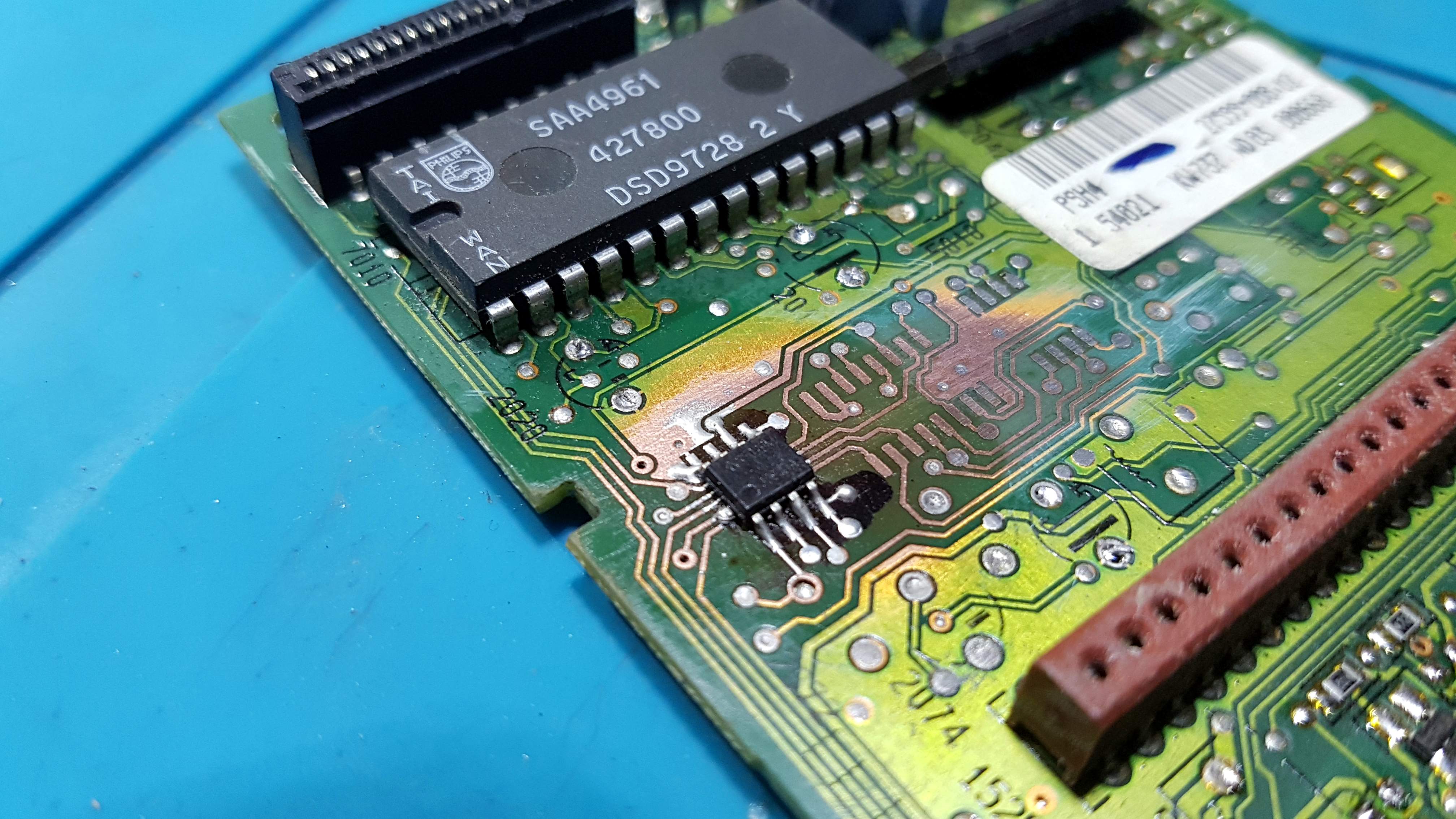

          I took an old PCB, sanded the part where the small chip with 8 pins stood, to take it all the way to the copper surface.
          Then I randomly applied that "paste" with a brush, glued the chip on top and started heating with the rework station.
          And look ... the process was going just as fast, if not a little faster, and the legs were soldered very properly.
          Even after that, there is not much left to clean, as is the case with "Mechanic" liquid tin !?
          The solder spots look brighter and "silver-ish". Solders work looks indeed better.
          I just wonder if such solder will last and be of good quality.
          It turns out that I found several times cheaper soldering material !!!
          Opinions?

            Make sure it rosin flux and not acid flux. Plumbing solder is often acid flux.
              That's good point.
              How to make sure?
              I am reading a label on package, can't find anything else except that it also consist zinc chloride.
              And the "rests" can be washed out with water.
              There is a warning too, that it is dangerous substance and can irritate skin and eyes.
                for water pipes there will be no lead anymore, but can you link to his product there might be a data sheet available !
                  https://www.felder.de/products/coppe...229760551.html
                    "...The flux residues are corrosive and have to beremoved through wiping from outside and rinsing from inside!..."
                    As far as i understand; residues can be washed out with water.
                    Although i noticed there are not much residues on the chip and around it.
                    I used magnifying glass to chech for particles. Barely spotted few which were easy to remove.
                      When ever you see the word "chloride" that's a corrosive salt. You can't always clean all the flux under components. Chlorides are also conductive so you could get leakage currents between pins. As you know metal detector circuits are sensitive. I would spend $10 on 10cc of smd flux and another $10 - 20 on 63-37 solder paste. It will save you lots of head aches forward. I have been using the same tube of flux for over three years with many projects.
