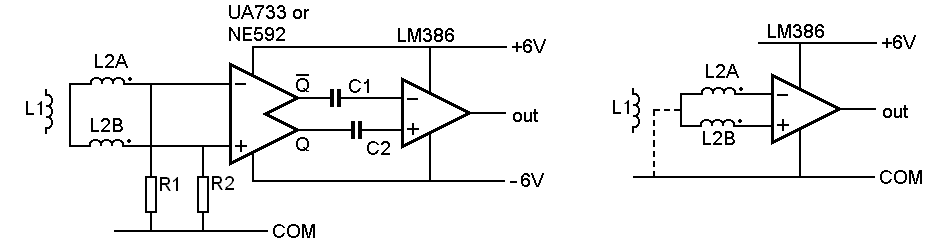

                Before to reinvent the simple input circuitry with LM386, I have designed the following circuit having in input UA733 for symmetry and increased gain. However there was large common mode signal in input because I not use shielding and I have not grounded "center tap" (connection between RX windings).
                Note that the circuit in right can operate without connection to COM if there is shielding.
                Then radio amateurs adviced me to connect "center tap" to COM and to use only LM386, but in circuit with increased gain (near to 60 dB).

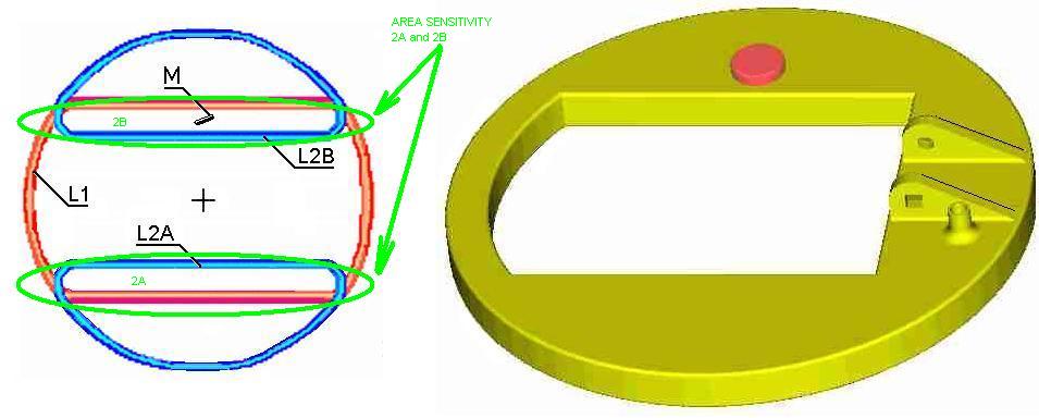

                  Maikl, the oOo loop configuration is widely used for demining because of its excellent pinpointing properties. Please read patents US3,002,262 and US3,823,365 for details.
                  Below is illustrated spatial response of this configuration. It seems as derivative from response of a conventional loop configuration. There is a sharp null when target is in the plane of symmetry between RX loops. The processing of such spatial response is described in patent US4,700,139, but with oOo no need of differentiation.
                  I'm using DOD loop configuration to locate meteorites. They are not deep buried, but my meteorite locator can detect coins at 26 cm depth in bad ground.

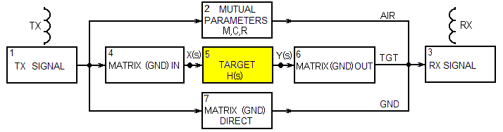

                    MotoLupe, the principle of Houndog is regeneration (positive feedback). The drawback of this principle is for target identification (TID). The soil properties are involved in the loop of regeneration. When soil changes, it changes frequency of Barkhausen.
                    The path of target signal is shown below as block diagram, valid for all kinds metal detectors. Note that soil operates as two blocks causing phase shift. For TID we need two signals which exist in points Y and X. If we know them, we can calculate H(s) (impulse response or frequency response of target), ie we will recognize the target. A regenerative circuit can not deliver such information, because it not operates with carrier frequency. The Houndog is a variant of wide band Noise induction metal detector suitable for beginners. I think you should design a wide band metal detector without such drawbacks.

                      Hi mikebg. Mine are large objects on the surface (not deeply buried)... When I thought of poor pinpoint the following: whether the target area in 2A or 2B in the area (see picture). Detect coins at 26 cm depth in bad ground is not bad. Which detector is used with the DOD (OOO) loop configuration? Whether it comes to a well-known brand or your "handmade"?

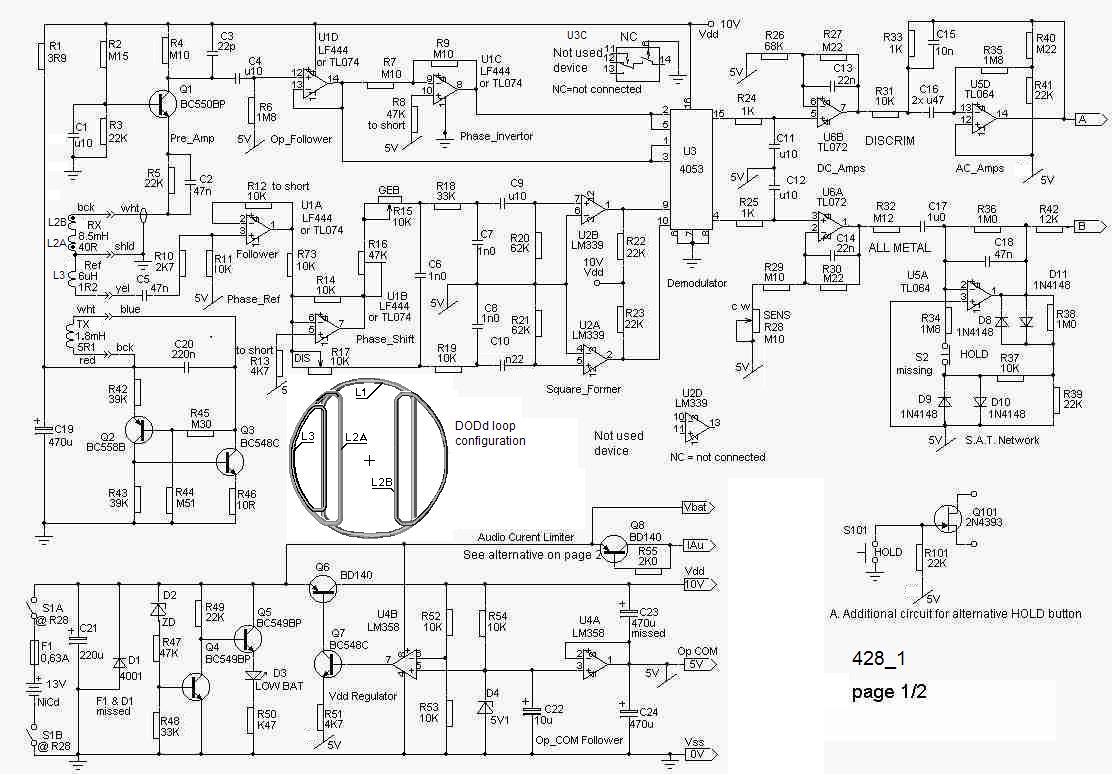

                            MotoLupe, "DODd" means 4 windings: L1 - transmit, L2A and L2B - receive and L3 for reference voltage. Below is given an example for use of coil "d" or L3 in meteorite locator.
                            However we can realize extracting of carrier frequency without winding L3, for example using voltage induced in L2A.

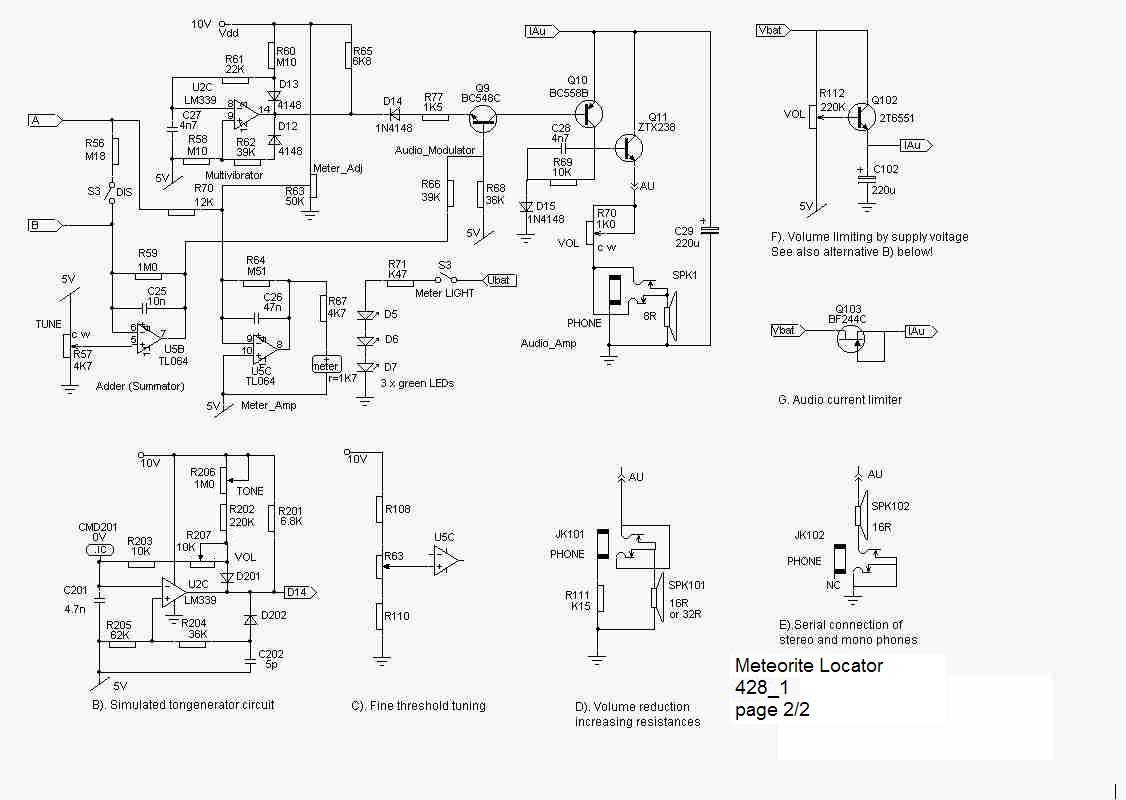

                                Here is the second page of circuit 428_1:
