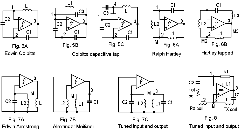

    Here are different circuits of LC oscillators, where L components are used as sensor for metal: Colpitts, Hartley, Meissner, Armstrong etc. When L is close to metal target, the frequency of oscillation is shifted. This principle of operation is used in "Frequency shift metal detectors". The rest of the metal detector circuit provides to operator information about the direction and magnitude of the resulting frquency shift. Since in most cases the rest of circuit contains reference oscillator or BFO (Bear Frequency Oscillator), the metal detector is called BFO MD.
    The quiz is: WHAT OSCILLATOR CIRCUIT PROVIDES MOST FREQUENCY SHIFT AND WHY?

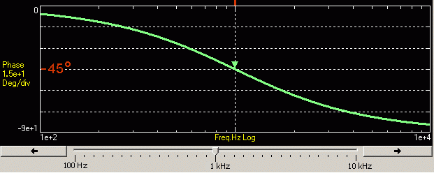

      Here is the Phase Characteristics of such target (phase difference of electromotive voltage induced in the RX coil to the current flowing in the TX coil.

        As I understand you are speaking about Figure 8 scheme?
          Oscillator circuit of Fig. 7C has the same properties as the circuit of Fig. 8. The difference is only in used amplifier. The amplifier in Fig. 7C has infinite input and output impedances, but the amplifier in Fig. 8 has zero input and output impedances.

              1. Input impedance at inverting input of an opamp is in theory zero. At noninverting input is infinity.
              2 and 3. HINT for correct answer: at oscillation frequency the phase lag in open loop is 360 deg.
                This (zero and infinity) suit to which tipe of oscillator - to which of oscillator figure?

                    Simon, the negative feedback is shown in Fig. 8 as resistor R1! The sign "gain infinity" means that this is an opamp, however because of feedback, voltage amplification for inverting input is minus R1/r. Since there is also positive feedback in noninverting input, the circuit oscillates.
                    The circuit diagram in Fig. 7C is different, because it contains an amplifier shown with its voltage gain K. It can not operate with tank circuits if input and output impedances of amplifier are zero. Both capacitances become useless when their tank circuits are shorted by zero input and output impedances of such amplifier.

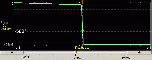

                    I will post the last hint for answer but it requires drawing. The question is:
                    AT WHAT FREQUENCY WILL OSCILLATE A SYSTEM HAVING VERY STEEP PHASE CHARACTERISTIC OF OPEN LOOP? (the drawing will be in next my posting)
                      Steep or Slant?
                      Attached is phase characteristic of an open loop system consisting of an amplifier, RX coil connected to its input and TX coil connected to its output. Let the circuit diagram is as in Fig. 7C or in Fig. 8. The system is open because there is balance between TX and RX coil and there is no target. The phase characteristic has very steep region because both tank circuits are tuned to the equal resonance frequency, for example in the diagram below is shown 1kHz.
                      What happens if there is target with phase characteristic shown in posting #3?
                      We should sum both characteristics to obtain phase characteristic of the new system which now is closed by target and can oscillate. Despite target has slant (not so steep) character in this region, the common characteristic remains steep. Target adds a phase lag 45 deg in the steep region as shown in posting #3, however the condition for oscillation is satisfyed again for about 1kHz.
                      CONCLUSION: To increase frequency shift of an oscillator caused by non ferrous target, we need slant phase characteristic of open loop system.

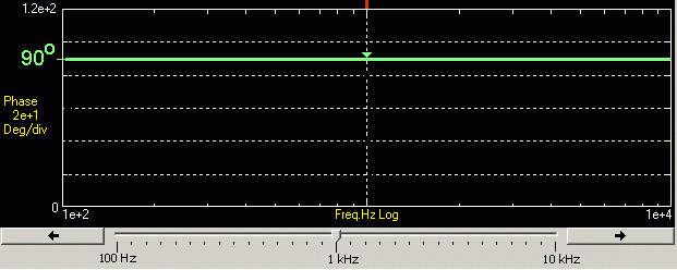

                        Ferrite target
                        Remains to see what happens when the target is dry (nonconductive) mineralized soil, lossless "hot rock" or ferrite core. It has absolutely flat phase characteristic with phase led allways 90 deg independent on frequency as shown in the attached figure.
                        We can tune feedback system to operate with degeneration (negative feedback) if soil or target have ferromagnetic properties. However this will reduce sensitivity to nonferrous targets.
