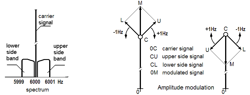

      I will try to explain why connecting TX coil in self-oscillating circuit is bad for sensitivity of metal detector. Let we see the spectrum of target signal. Below is shown an example when TX excites environment with frequency 6kHz and search head moves slowly. Without target, the RX receves AIR & GND signal as an unmodulated carrier frequency 6000Hz. When arises target signal, the movement of search head modulates the carrier frequency with two side bands USB and LSB. They contains modulating frequencies for example from 0.1Hz to 1Hz. In this region of extremely low modulating frequencies, every electronic amplifier has increased noise known as 1/f noise or flicker noise. The self-oscillating circuit contains amplifier which generates flicker noise. The circuit has regeneration (positive feedback), which increases these noise until amplitude of oscillation. That means our carrier frequency is modulated by flicker noise and demodulator will detect false target signals despite there is no target.
      There is no generation of noise in TX with driven amplifier. TX amplifier operates as switch driven by rectangle pulses. There is no regeneration of noise. Despite known circuits are not designed properly because amplitude of TX current depends on distance coil - earth, this drawback can be avoided by amplitude stabilisation with P-I-D controller.
      CONCLUSION: The TX circuit of every known sine induction metal detector can be improved.

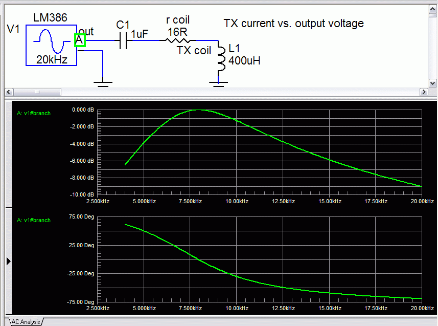

        In the circuit diagram Fig 2 of posting #16 , the closed regenerative loop will have narrow pass band because there are two tuned circuits formed by TX and RX coils. That means we will have very steep phase characteristic and as result small frequency shift if both tanks are tuned to equal resonance frequency. To achieve large frequency shift, we need slant phase characteristic, ie both tanks should be tuned to different resonance frequencies and damped with resistors and increased coil resistances.
        Let try with SPICE what happens when instead 16 ohm loudspeaker we connect a 16 ohm TX coil. To reduce GND signal, the resonance frequency is near to 8kHz almost as in VLF detectors.
        The magnitude and phase characteristics shown below have dimension of transfer admittance because transforms output voltage of amplifier in current via TX coil.
