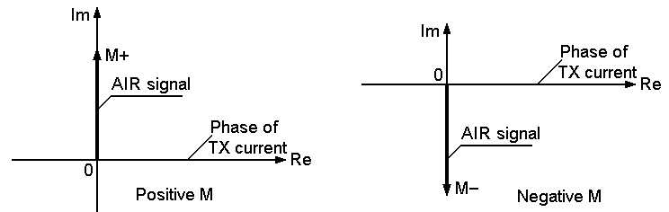

    How seems AIR signal in complex plane?
    In the attached diagram are shown two AIR signals caused by mutual inductance M only. Signal OM+ shown in left figure is generated by positive mutual inductance M. It has phase lead 90 deg relative to TX coil current. Self-inductance of TX coil also generates as OM+ signal.
    Signal OM- shown in right figure is caused by negative M. It has phase lag 90 deg relative to TX coil current.
    Note that phase of AIR M signal is independent on frequency. The phase is always in quadrature to TX coil current.
    You can change the sign of mutual inductance M by several ways:
    - swaping leads of RX or TX coil (one coil only),
    - relative shifting between coils,
    - coil shape deforming and
    - placing a ferrite core in suitable position between RX and TX coils.
    Not only mutual inductance generates signals in quadrature to TX current; ferrite core, "hot rock" and nonconductive ferromagnetic (mineralized) soil also generate signals in quadrature, but these are TGT and GND signals.

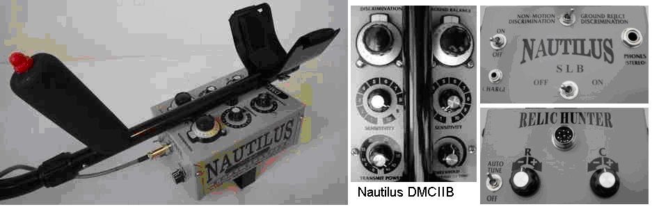

              Since I am only reinventor, to go further with reinventing, I must know the names and the cases made by the original inventors. The four buttons mentioned and showed by me above, are used by Jerry Tyndall - designer in Nautilus.
              I searched WEB for circuit diagram and manual for the Nautilus DMCIIB.
              Unfortunately I did not find anything useful, even there is no owner's manual written by the manufacturer or by designer of this detector.
              The DMCIIB is very interesting for me, because its designer, Jerry Tyndall was experienced radioamateur (call sign WB4TFX). He ought to apply his amateur knowledge for receiving very weak radio signals covered with large interference and noise. He must not use voltage across TX coil as reference signal for synchronous demodulation. He should extract phase information about the carrier frequency from the received signal.
              Don (dfbowers) wrote for me in 09-05-2010:
              "I have a manual somewhere. I'll dig it out and make it available to anyone who wants it. Also, I was going to trace out a schematic and post it anyway.. I just need a little time. Coil has a preamp built in (from what I rememeber last time I had it open)."
              I actively wait for this information. The word "actively" means that during this time I keep searching WEB and thinking how should a metal detector work to outperform others. Think and you!
