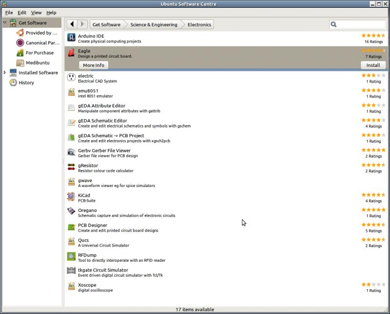

    There is some electronic software available in Ubuntu.
    As you can see below, Eagle is supported. There are a few other packages, but I've never tested them.
