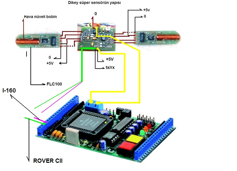

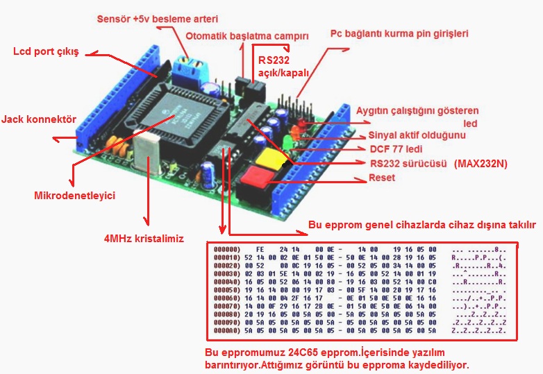

Obviously not; it is based on Motorola MCU.Originally posted by wtrk View PostI have this one and its special designed for me from my friend.
This main card is not arduino, its conrad and you need eproom hex code for this.

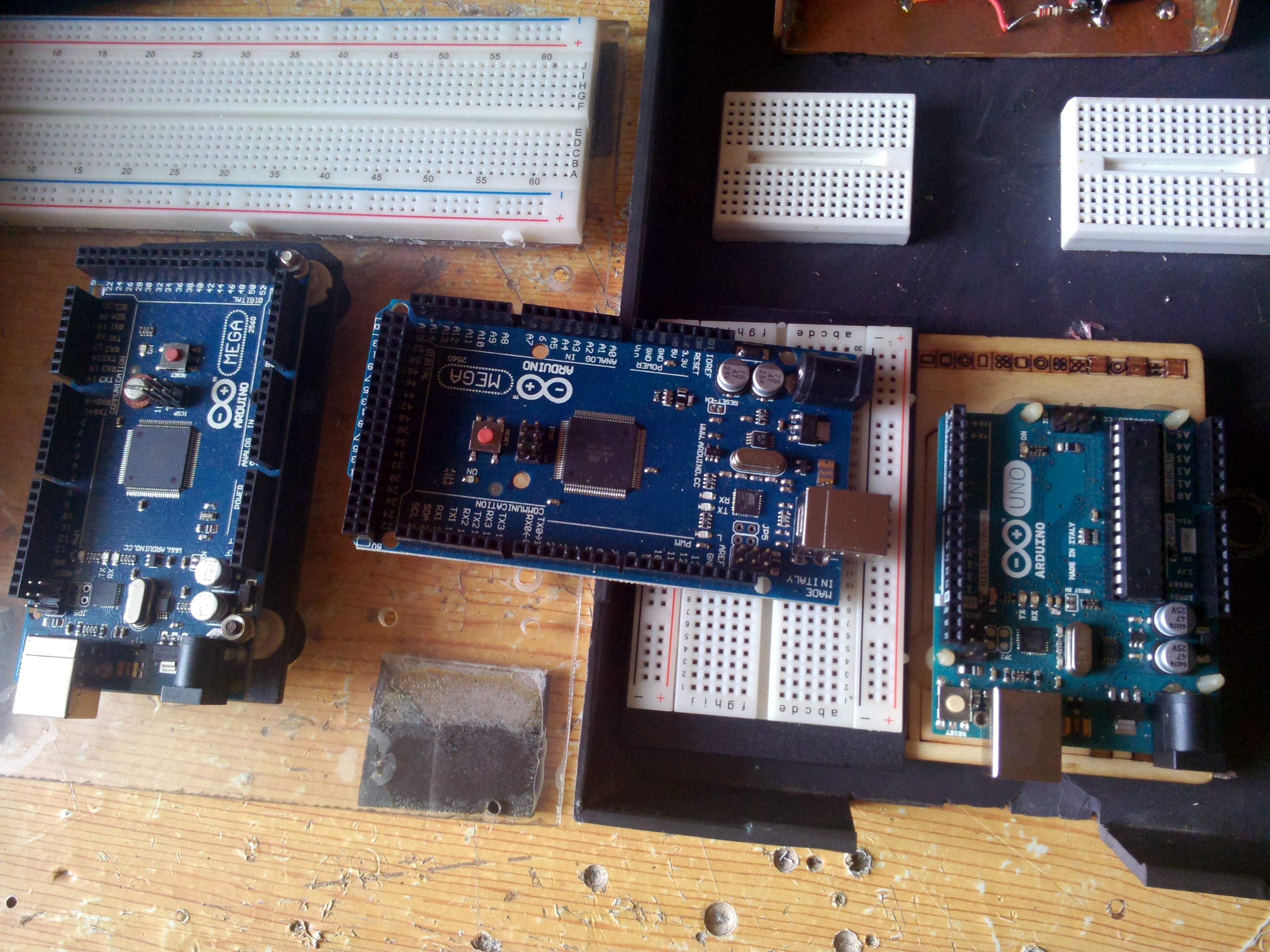

Here is how it looks like, here are my Arduino's; 2 x MEGA2560 and one UNO...
Yes it is C-Control (CONRAD-Control) board based on Motorola ZC441199FN MCU.
Produced since 1997 as module series and sold in different variations.
It possible that there is variation with AVR MCU also, but that one showed on photos above is obviously Motorola ZC441199FN MCU and it can't be called "Arduino".
In many aspects however it resembles on Arduino.
That's really not important here, i only wanted to hear about DCF77 option and how it is used in particular setup.

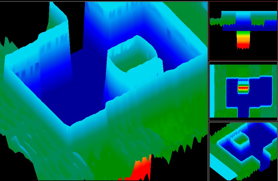

i made 3d metal detector by fluxgate magnetometer and working visualizer 3d
i made by arduino
and working all software 3d okm.. ha ha ha very very good work.
my source very very good working. very very good
[ATTACH]35223[/ATTACH
just writing program(source) ...... programing arduino ...Attached Files

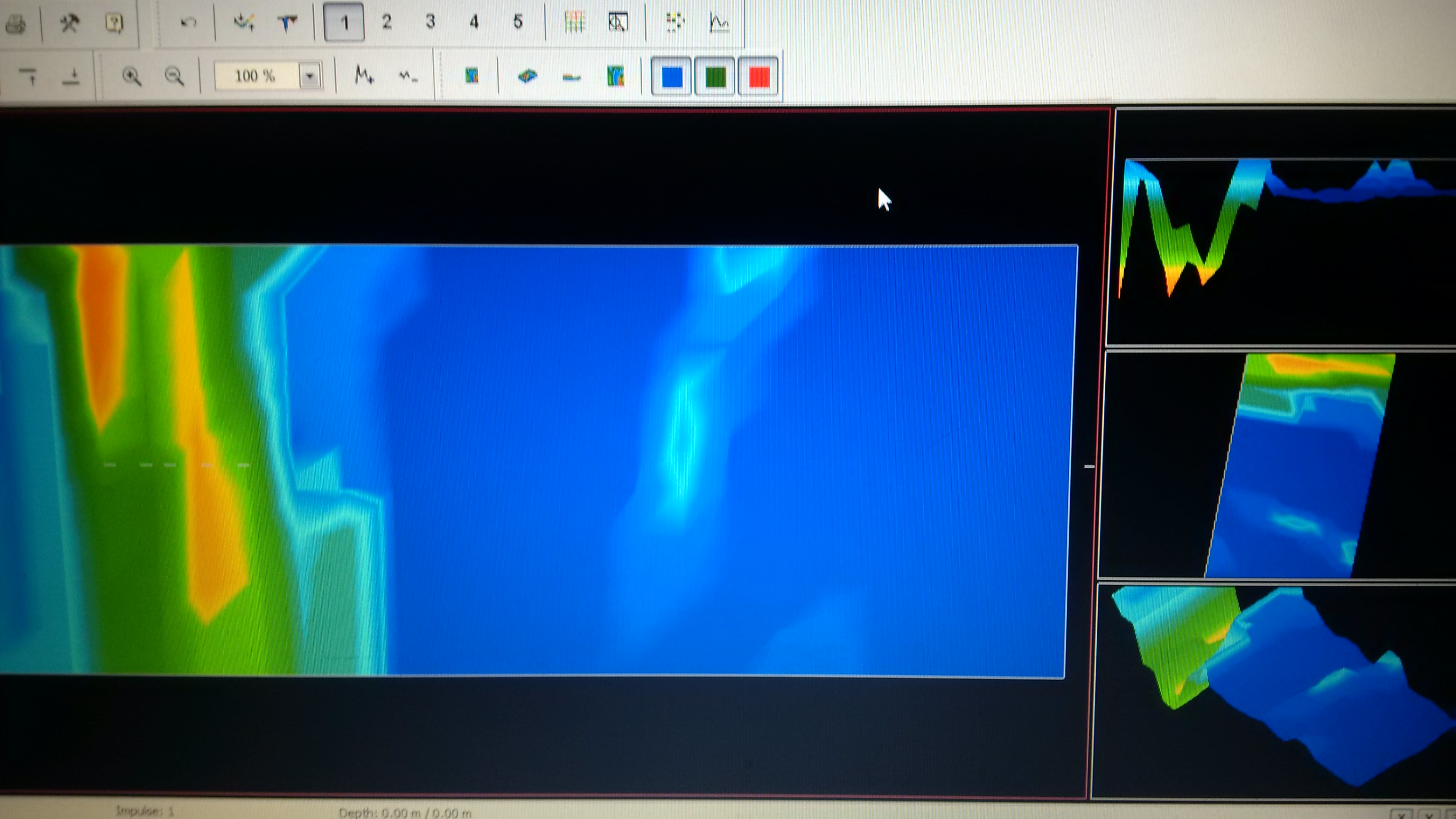

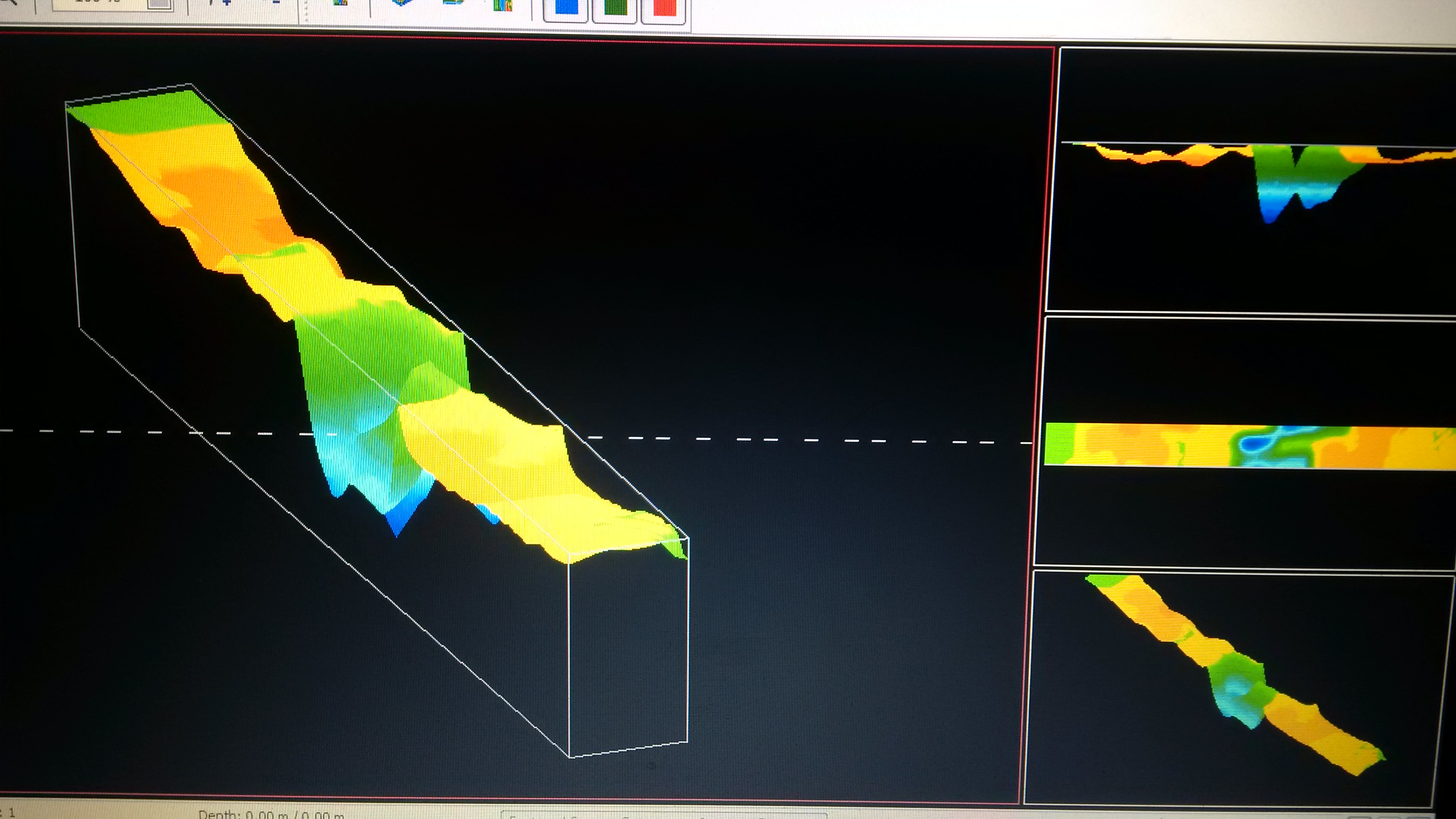

Do you have Future 2005 hex code for eproom ?Originally posted by pourang View Posti made 3d metal detector by fluxgate magnetometer and working visualizer 3d
i made by arduino
[ATTACH]35222[/ATTACH]
[ATTACH]35224[/ATTACH]
[ATTACH]35225[/ATTACH]
[ATTACH]35226[/ATTACH]
just writing program ...... programing arduino ...
