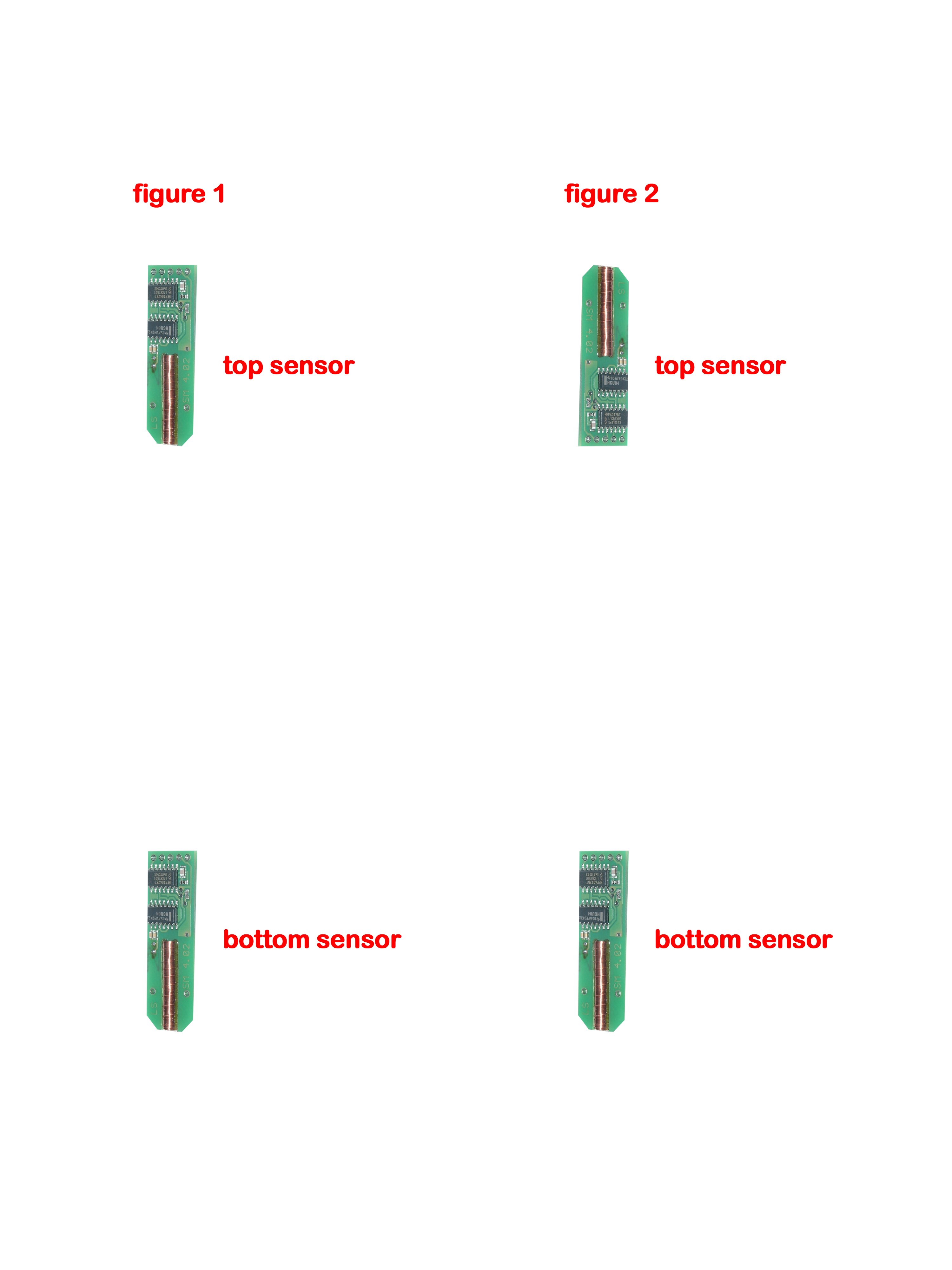

                          I am continuing my gradiometer project and i want to ask you wich placement is better for flc-100 sensors.
                          I am attaching 2 sketches so its more easy to explain.
                          Your help will be much appreciated.

                            Only The Fig1. You measure, digitizing, subtraction, then storing the SIM card or direct shipment to the computer with the Exel. Then visualize.
                            • #44
                              Thank you for your help!
                              Do you know what is the ideal distance between the upper and down sensor?
                              1000mm is ok?
                              Thank you in advance.
                              • #45
                                I have a 1300 mm (width of the car). Greater the distance is greater sensitivity (the difference of measurement). It is important that the rigidity of the structure to keep the axis measurement.
