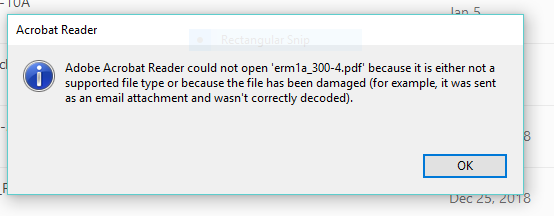

      Seems the PDF is corrupted Won't open
        Works ok for me.
          Gives me stick ! LOL Click image for larger version
            Work for me also.
            Maybe do an update or remove/reinstall on your Adobe.
              I don't have issues with any other files. They pop right up. My Adobe is up to date. Can I get someone to send it to my E-Mail address?
                Got it working. Thanks People.

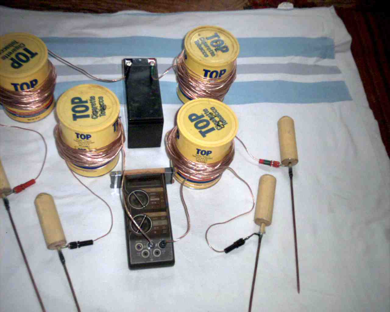

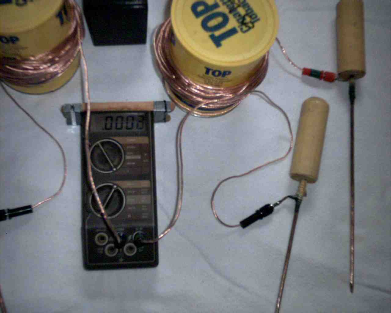

                            Here is the one I started with to learn.
                            You'll have to invert the pic in the pdf!

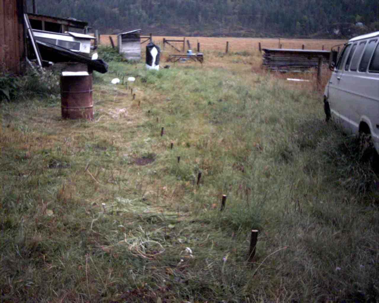

                              Here is the setup I used in the "My Front Yard" surveys in 2005.
                              Here is the Thread title to search from 2005: "My Front Yard" ER Survey Pictures
