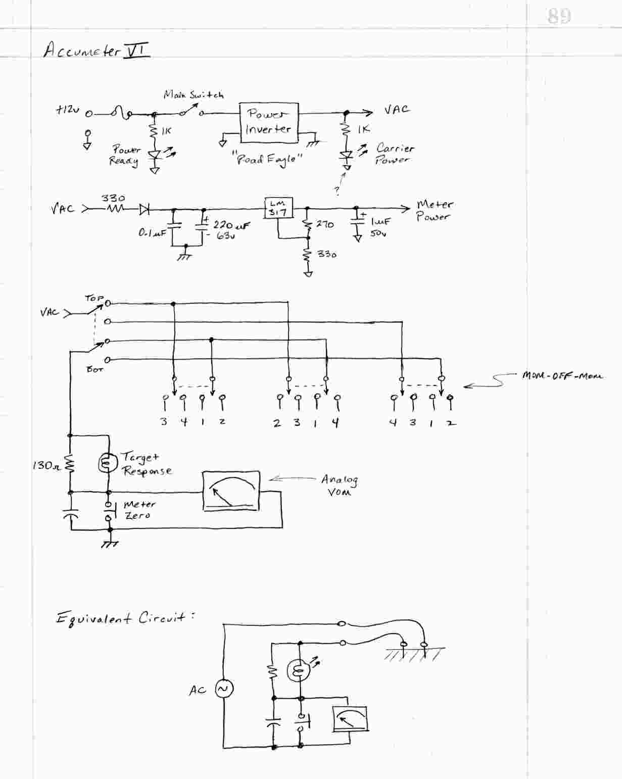

    I have suggested that the Accumeter ground resistivity meter is essentially the same as the Survey Meter project, based on a schematic that an Accumeter (Model IV, I think) owner sent me. Meaning that the Accumeter can easily be built for $40-$50.
    I recently acquired an Accumeter VI. I've only opened it for a quick look, which showed that, indeed, it is trivially simple. When I get some time, I'll draw out the schematic and post it.
    - Carl

        accumeter
        Originally posted by Carl-NC
        I have the Accumeter VI circuit mostly drawn out... I'll try to finish it up, and post it.
        - Carl
        look forward to it! when complete please let me know. thanks carl. regards hank
          This is what I have so far. I need to double-check the value of the cap, and to make sure I've drawn the VOM hook-up correctly.
          Once you remove the DC-AC converter, the power supply circuit for the VOM, and the switch network, you are left with the equivalent circuit at the bottom. A resistor, a light bulb, a capacitor, and a VOM. All for $3495. Is that capitalism, or what?
          - Carl

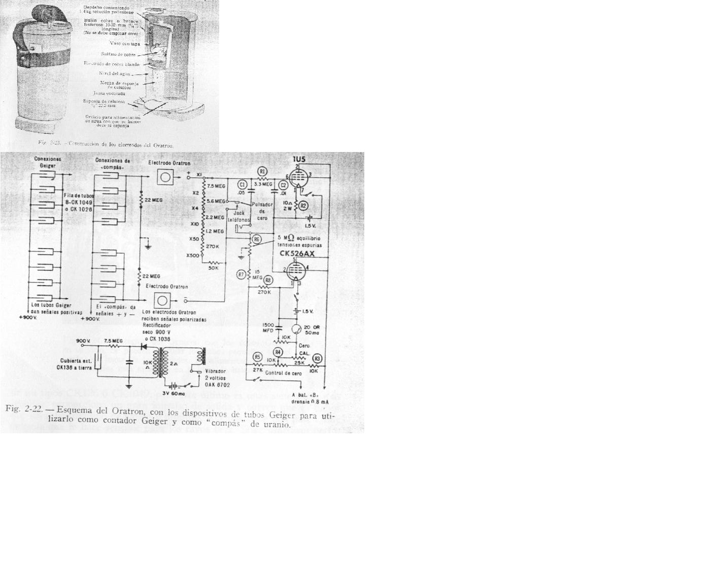

            EARTH RESISTIVITY METER
            Found in internet.
            Originally from The Radio Constructor (1966). Have ten levels for each depth. Maybe you can added more... The combinated key select the desirables electrodes.
            Only have the info in Spanish and Russian.
              production costs
              Thanks Carl; I plan to try one of these just to see it work. To be fair the nice box these are put in are about $45 wholesale. Electrodes and wire another $10 and advertising is expensive, but 100% tax deductible. When you add built in data logging and control the production cost might shoot way up to $500. :-) The unit being offered by lrlman that will take any dc input seems a fair price at around 1k.
                With the AL's Accumeter, Fitzgerald's Mother Lode Locator, and Kellyco's GPLs, the case is the single most expensive item. I agree, the logger Tim has is a far, far better deal.
                - Carl
                  Basically a Wheatstone bridge... the multi-level electrodes are interesting.
                  - Carl
                    Oratron
                    I Agree.
                    Oratron wich works via non-metallic electrodes (copper sulphide-drops) maybe is the better. Sorry the images. Also, another option of this schematic is the Geiger counter.

                          Carl,did You finished schematics of accumeter
                          I am wondering if You finished this schematics of Accumeter.It will be usefull having one at home and for that price too!! Think that is a good piece for metal detecting,and finding water.
                          Stay good and fast up hill
                            No, my Accumeter is still out on loan. I don't know when I'll get it back.
