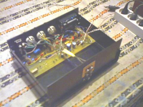

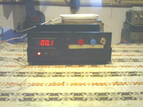

            Hi
            I just made res. meter...it is still under testing...some pics...
              I got my Accumeter back last week, so I will try to wrap up the schematic soon...
                I was thinking...if is any chance to improve this res. meter and add some
                data logger...i made it upon article from this forum, you posted earlier...
                It all looks fine on the table, it just need real field testing, but last days here
                is raining so i have to wait beter wetter to do that...
                Freq. is stabile...137Hz, all functions are right, all measurements gives right
                results, so it is ready for outdoor testing....we will see...
                In case of survey field 20x20 meters, i have to draw matrix and manually input
                values, later to type in pc and than let software to do the rest of a job, that's
                why i would like to add some data logger...
