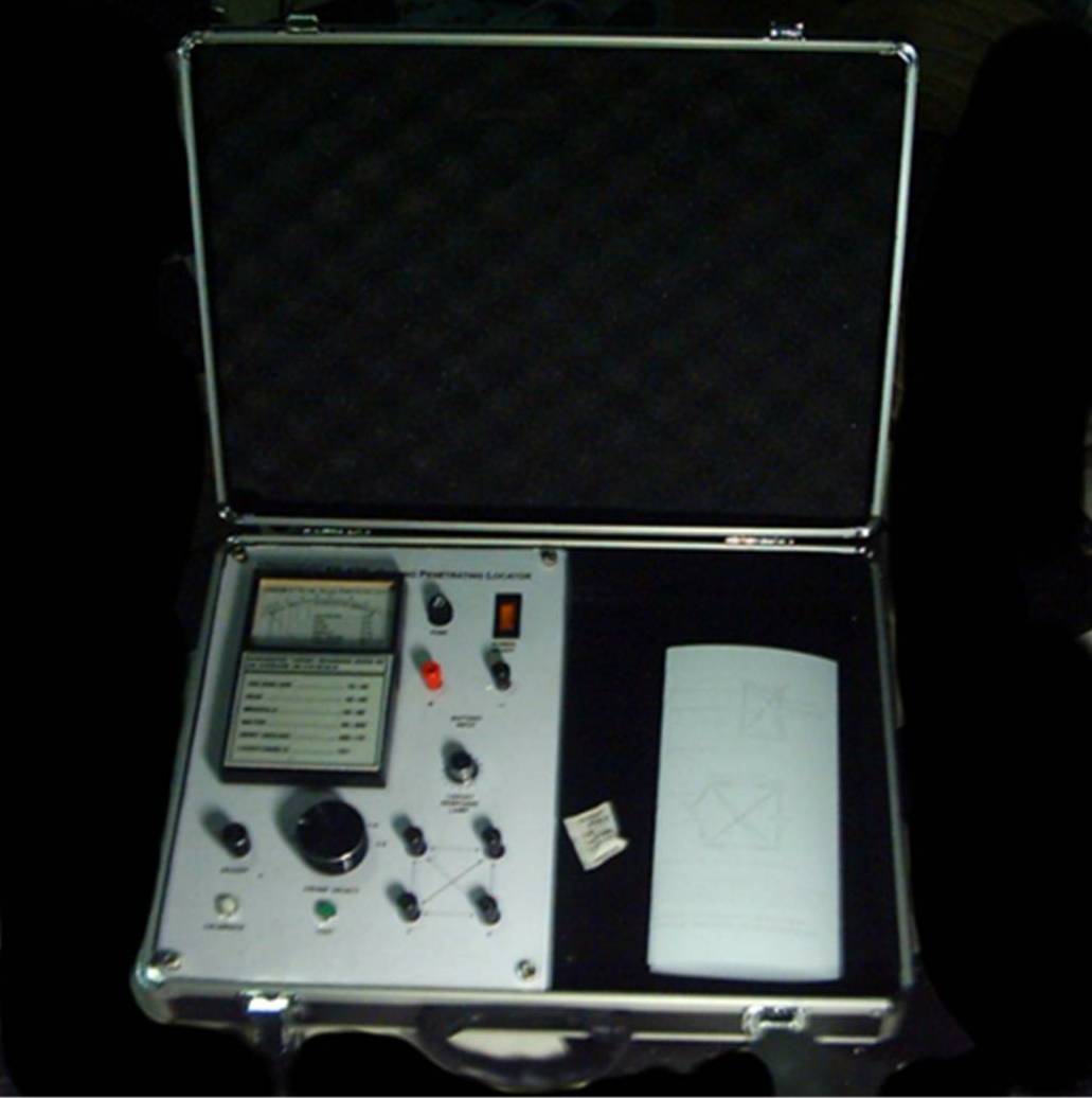

    my resistivity meter i build from scratch

      hi,
      i have made already my homemade 4 probe earth resistivity meter,patterned to Accumeter VI, through the help of Carl....and i want to thank you for all the help....now, my question is, why would the Accu people use only 24 volts, and tim use 100 volts for his GCG......is there an advantage for this, coz im planning to use my 220 volts instead of 24, bypassing my transformer, if there is an advantage of using higher voltage...thanks

                  hi alex,
                  in truth, im no expert either in geophysics and electronics, but i tried my very best to build one and understand how the circuitry works......it is a big advantage before you assemble the thing....here are some material you need...for accumeter VI pattern.
                  a 12 volt battery (mine is 7ah)
                  a battery charger
                  a 12 volt (input) power inverter (mine outputs 220vac)
                  a step-down transformer from 220vac to 24vac
                  a multimeter
                  a selector (rotary switch)
                  a push button switch....etc etc
                  ill try to post here some of my bill of materials and some pics... so that you can have a better idea.....
                  a piece of advice.....before you start building your resistivity project, try to understand first how it works, what are its capabilities and what are its drawback.....you might change your mind....anyway good luck........im now trying to manually log all my readings so that i can have a visual through a software....this is much better......
                  ill compile first all my things and post it here for others to see......i wanted to help....

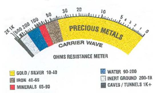

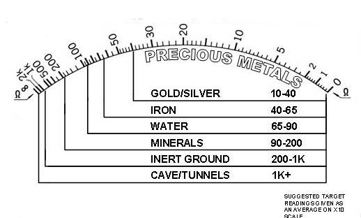

                      50Hz or lower (square wave) Accumeter Frequency
                      Meter scale for Accumeter VI

                              • #60
                                George,
                                It would be 50Hz or 60Hz, as it's just an ordinary power inverter. This is not a Fluke design and cannot be compared to a Fluke. It doesn't matter whether the waveform is all-positive or bipolar, the ground doesn't know the difference.
                                - Carl
