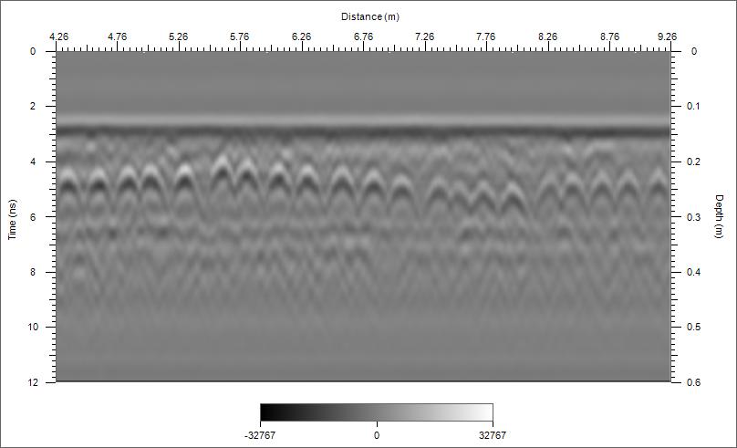

                        I do however think your so called "1.6GHz" needs a lot of refinement and work to be able to say it does work as a GPR should. That specially in concrete which has approximately the same properties all over the world, don't you agree? It should look more or less like the attached picture, but it doesn't. This is one of our antennas, I won't be advertising which one, although, I guess I already did so previously, oops!.

                          • Originally posted by gwzd View Post
                            May be it work as metal detector ?
                            You see, I personally don't have any problems with your other gpr, the one here:
                            It is not top of the line and many things can be corrected, but hey, it seems to work and if your customers are happy then it should not be any problem.
                            Of course my GPR may be not ideal, but i am absolutely sure that all your antennas FLB-390, HA1000 AND HA2000 are not so suitable for treasure hunting and can not work so deeply as my GPR. You have not enough experience in real condition. If you wish i will explain why your antennas a not so good for treasure hunting. By the way you forgot to write the frequency of your antennas, i can only to suppose that the number is equivalent to frequency may be.
