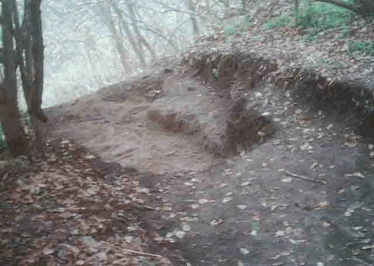

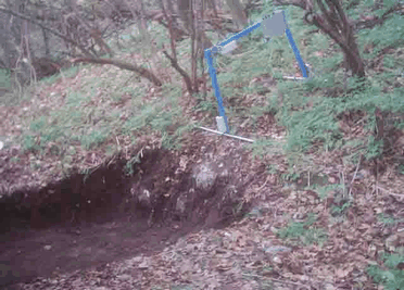

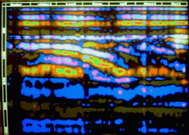

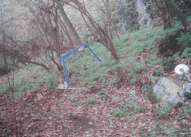

              GPR cross section of the ground structure and photos:
              terrain - before digging
              terrain - after digging
              terrain - after digging, with light brown layer, from 1 to 2 meters deeply

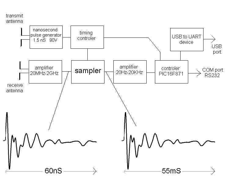

                      Block diagram
                      • #41
                        Hi Valchev
                        Thanks for your diagram.
                        I hope you have very happy new year.

                          sampler?
                          Hi
                          Could someone explain what kind of electronic realizes the "sampler"?
                          The only thing I can imagine is a kind of delay-line (SAW) like in chirp-radar.
                          What kind of electronic is able to spread a signal 100k in time without degredation.
                          Dirk
                          • #43

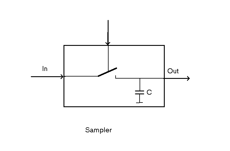

                            Actually that is similar to PC based digital sampling oscilloscope high (or ultra-high) bandwidth. As an example GPR 'ZOND 12' have sampler with only 4 transistors, and is perfectly. I use different circuit with bandwidth > 5GHz.
                            • #44
                              sampler
                              So the sampler is a sample and hold stage?
                              Also you use the methode of equivalent time
                              sampling? Only on sample per transmitted Puls
                              is converted by ADC? And the repition frequency
                              is determined by the conversion rate of ADC in
                              the PIC?
                              Best regards
                              Dirk
                              • #45
                                Excuze me, as you can see I speak English with
                                difficulty, and I am not sure if i understand and
                                explain correctly. For that i prefer to drаw:
                                Switch must to can to be closed only for 100pS=0.1nS
