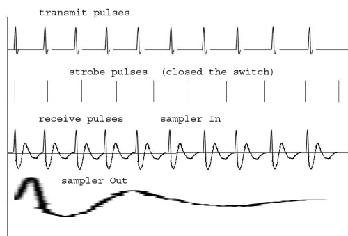

    sampler

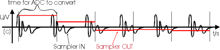

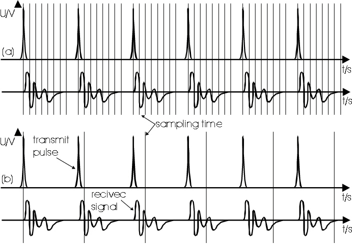

    Hi
    My english is not good too. So I attach two files.
    I think you use a samling strategy like (b) not like (a).
    In case (a) you would need a ADC with giga samples
    per second (Gsps) in case (b) only kilo samples (ksps).
    (c) i think schows the function of of the Sampler, so
    In your block diagram the graph shows not the true
    behavior at the output of the sampler. The signal is
    not spreaded analog (continuously in time and value)
    from 60ns to 55ms.
    Best regards
    • #47
      It is stroboscopic metod. Example is with 10 pulses to be simple, realy it is many many more. It is no my idea, it is а classical metod. And output pulses form is ideal. Conversion time of PIC is < 0.020mS, Out puls is 55ms.
      • #48
        Sample
        Hi
        That is what I think that it is.
        Best regards

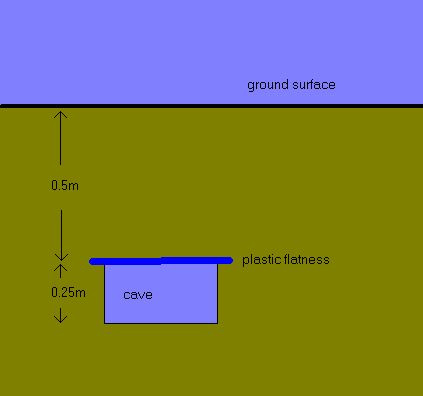

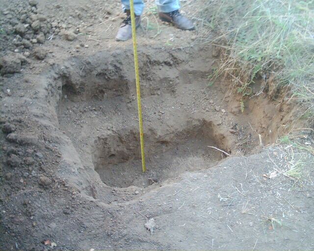

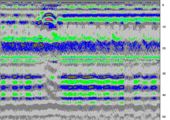

                • #53
                  Test
                  GPR - EXPERIMENTAL TEST RESULT
                  Cave ( width 0.4meters, length 0.8m, height 0.25m ) in a dry soil on the depth 0.5m , covered with a plastic flatness 0.9m x 0.5m x 5mm - non conductor , (tested that GPR can not detect the flatness in air, can not detect difference between air and flatness)
                  antenna - 300 MHz
                  time window - 50 nS
                  1. Plan of cave
                  2. Photo
                  3. Radargram

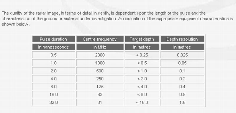

                      GPR depth according to EuroGPR trade association:
                      http://www.eurogpr.org/factsheet.htm#
                      click on
                      No1 Introduction to GPR
