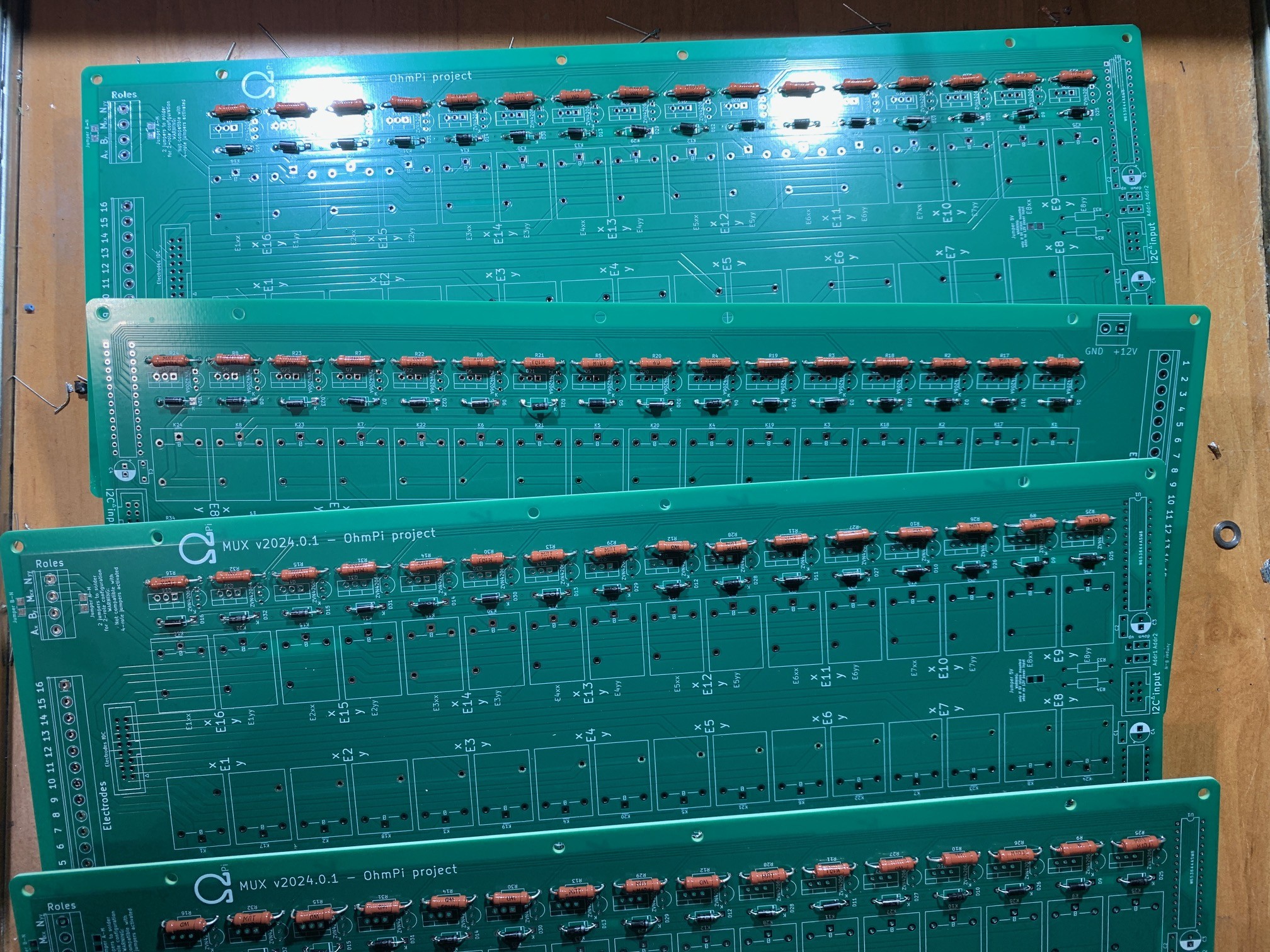

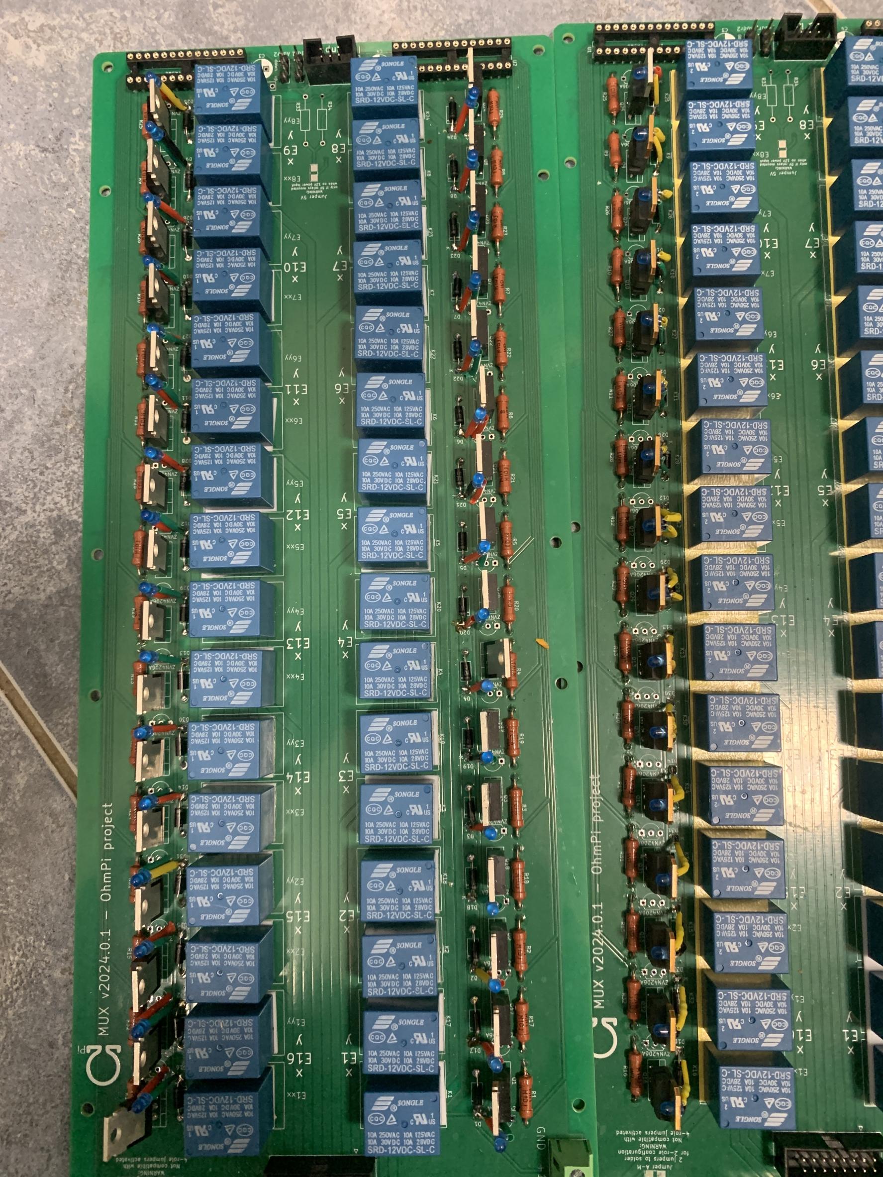

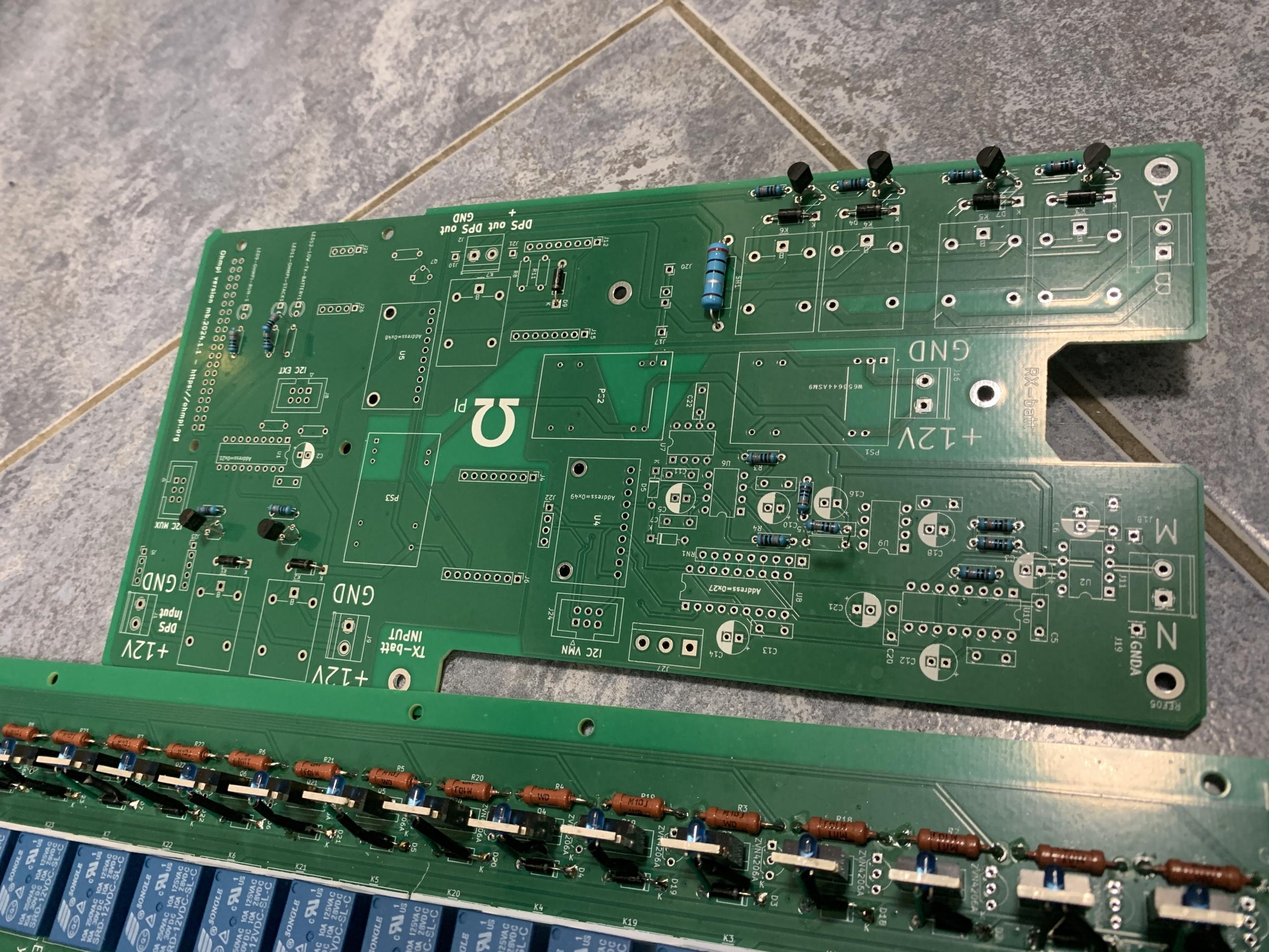

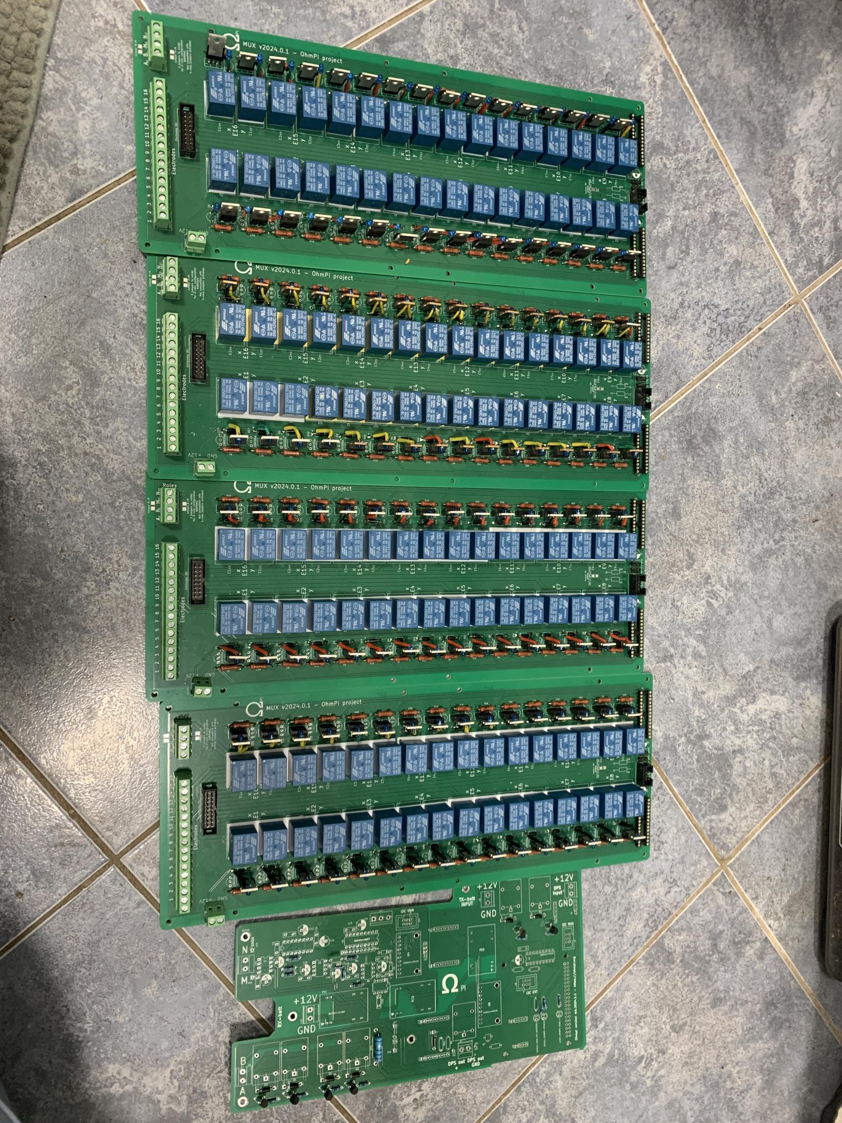

                    I make 2024 version of measurement board and 2024 version of MUX board and 32 electrodes. I was waiting for this version because it has the ability to work with 50V. Old version in my opinion was not so good in dry soil. The Ohmpi team examines sewage and wet soils that do not require high voltage.

                        I was interested in the project since the beginning of 2023 but I was waiting for the promised version with a voltage of 50V. At the end of 2024 I ordered the boards and I am slowly assembling the device.

                            Hi j570,​ Have you finished the setup? How are the tests going?
                              I have minor issues with parts. Plugs, cables, and final assembly. This takes a lot of time. I slightly modified the power supply. It's not ready yet. Regarding the configuration, I spoke with GPT CHAT, and he promised to help me configure it. The initial conversation showed that he understood the issue and seemed to be able to do it.​
