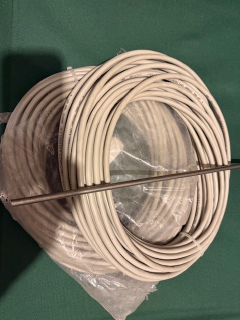

    j570 Thank you, I couldn't figure out how to make the probes. Everyone is working with very thick and large cables. I don't know if I should buy a ready-made cable and try it or if I need something else. What's your plan? I have a small field and I'm thinking of finding water using this method.
      I have several rolls of 4x0.75 mm² shielded cable, 25 meters long. I plan to use them to connect the probes. The probes are made of stainless steel rod, 8 mm in diameter, 35 cm long.
          Thank you so much j570, Are you going to conduct a water density study too? I think you're considering doing this for a non-water search. I'm guessing you're doing this because your cable cross-section is too high or too low.
            I'm thinking about doing some archaeological research. I'm using the cable I have and it seems to be fine. I'm not sure if the probe diameter is too small. But I got 32 pieces for free.
