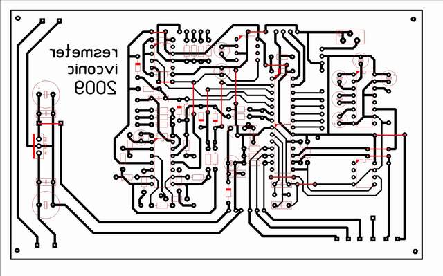

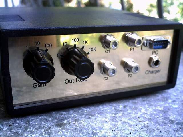

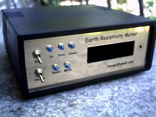

    In process of making it.....
    Few steps to finish..
      PCB adapted to suit this specific enclosure. Also planned to use with 12V accu. so there is 7809 added on pcb too....

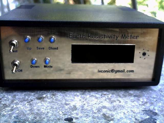

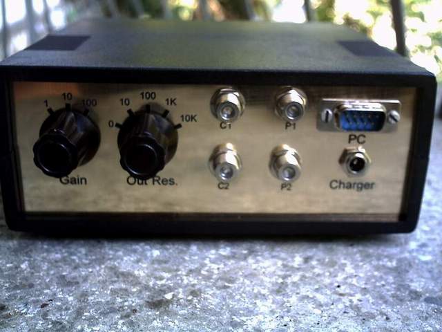

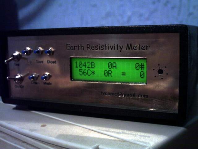

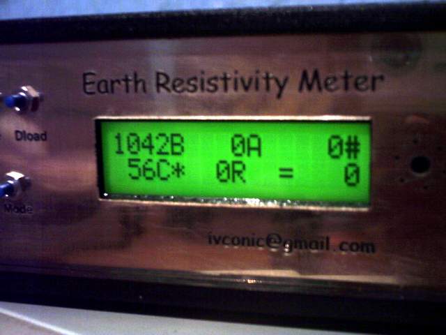

                Finished....

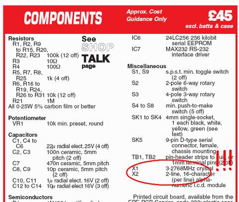

                  BUT! While testing and experimenting with it, i noticed some strange behavior!? First of all i got 124Hz at output - not 137Hz as it should be??? Than "UP" command leaps from time to time....???
                  And than i founded out!
                  It is cleary stated in text (and later same in asm code) that quartz should be 3.6864Mhz. Yet...some stupid made mistake and printed 3.2768Mhz in a part list!
                  Inert and lazy as i am, i never payed detailed attention on that, and bought components according to that part list from a text!
                  So now i have wrong quartz installed on my device!
                  That explains ocassional crazy behavior! Problem solved (partially).
                  Now... damn shop is in another city. Also i am not sure they have 3.6864 to sell.
                  So i was wandering where to find that quartz? Any known application with it? Any domestic device? Any idea?
                    Another problem is that i couldnt find 24LC256. Instead i have 24LC128 (dear friend send me recently). I put 24LC128 there.....yet i have doubts it will do the job. So...also was wandering is there any cheap&dirty trick to replace one 24LC256 with two 24LC128 on same board? If not, than i am pushed to order 24LC256 from another city...and wait for few days to receive it........I HATE WAITING! WAITING SUCKS!

                        More important to me is question on eproms. Really...i never had simillar thoughts in the past on that subject; those are serial eproms? So...must be the way to replace one with other two??
                          Same problem i had making EPE gradiometer. There are two 24LC256's there. But than i also put two 24LC128's and it worked pretty good. That gradiometer setup was more "tolerant" and left me to use those with half capacity less. 4000 samples instead 8000...if i remember good.
                          Now...this res logger is not that "tolerant"... Quite different memory organisation here...

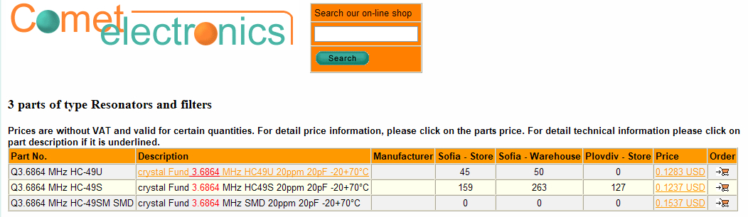

                            Hi ivconic,
                            Sokobanja is close to Sofia. I have 3.6864Mhz xtal's.
                              Excellent! If i can not find it in next few days, i will let you know.
                              Thanks!
