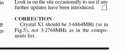

    Detailed reading gives some answers. There is correction at the end of article.
    But than analyzing asm file there is again xtal 3.2768 mentioned there? Seems it was option at the time and than decided to use 3.686?

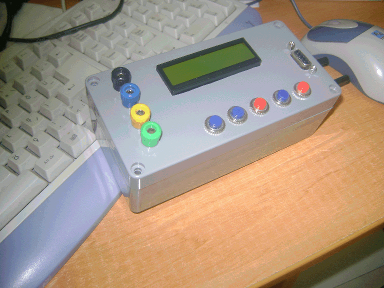

      However, this device was finally tested today on real soil. Splendid! It is working excellent!
      John Becker is real genius! This is his second project, i made so far. First was gradiometer and now this one. Both working from a first switch ON. And both working excellent. No problems.
      Tributes to John Becker!
      I suggest to all of you to make some of his projects!

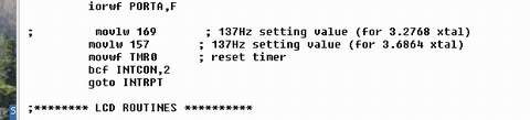

          Now that you said that we must correct the asm code, to change xtal 3.2768 by 3.686 Mhz......whow, how stupid on me, cause i didnt notice thar error.
          Anyway, do you think that my problem was that?

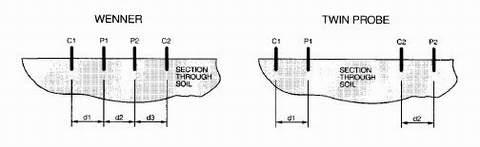

              Depth? Well... depth is easy to calculate. Theory says that distance between probes defines the depth, with relation 1:1.5
              To establish relation between readings levels and relative depths man must experiment much on testing field and form sort of depths table to use it later as reference.
              So.. if distance between probes is 2 meters than maximum depth would be 3 meters (tangent flow of current in soil)...

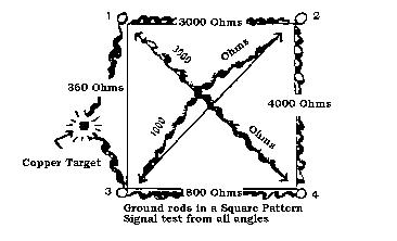

                Probes setup...
                for me there are only 2 real and working probes setups.
                Twin pobe setup is good for exploring already known and given area on which you may expect something to find. This setup is also good for series of measurements with various distance between probes (resolution/depth). Before any measurements, man must form precise matrix on given area and than repeat all the measurements in same manner.
                Wenner array is good for exploring unknown area and "wild" searching for some change in soil resistivity. Good for fast movements on some area. Need two man for each pair of probes.... Distance between probe pairs must be maintained all the time, best way is to use lace as "limit"...
                  Probes setup suggested like on Accumeter (I,II,III,IV etc...etc..) advertisment pages is rather strange to me. I don't unerstand it at all.
                  That probes setup looks nonsence to me.
                  I tried it also and can't understand at all how to distinguish what exactly i measured and gained on unknown area??
                  I would like somebody to cleary explain it. I tried it and later concluded that it is rubbish, nonsence and nothing else.
                  Don't waste your time with this setup because you will confuse yourself more...
                  Maybe just beacuse of this, suggested probes setup at Accumeter people who already tried to work with it didn't gained any usefull results? Maybe?
                  Accumeter in essence is working resistivity meter. I don't like simplified approach and pretty false resistances table offered on front panel.
                  All those makes it to look more like another bogus device, rather than real thing...

                    No Nelson, you don't need to change anything in .asm file. I said only that some frequency values are mentioned there, but not included in working calculation. Those lines in .asm code are "rem"-ed, not active. Understand? Take it easy. ASM file (HEX) is alright and accurate.
                    I can not send you, you must understand my reasons. But you already have it available and free on EPE official site as well as on EPE mirror sites on the internet. Just look for it. Free download.

                          Looks like something related to PIC. Or wrong programed fuses? Did you changed anything at fuses setup before programing PIC? You not supposed to, if using some conventional programing software and interface.
                          I am using PBrenner5. It read fuses setup from .hex file and setup them properly before programing.
                          Next thing that can cause similar behavior can be quartz; wrong value or broken. Also check traces around quartz and caps on pcb.
                          So ...again; quartz must be 3.686Mhz.
                          I got similar problems (time out, stuck, funny symbols on lcd..) when experimented first with 3.2768Mhz and later with 4Mhz...
                          Everything came on its place when proper 3.686Mhz used.

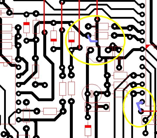

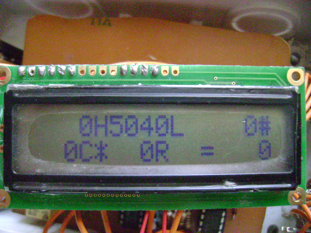

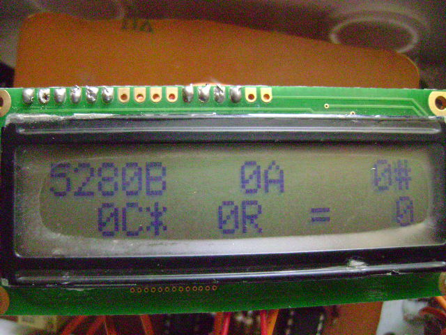

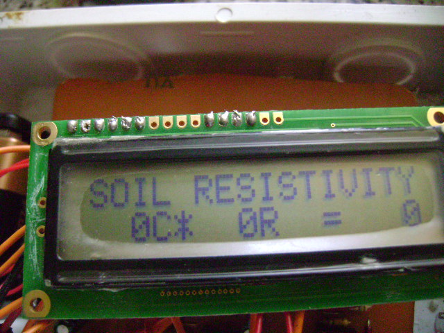

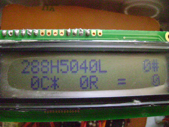

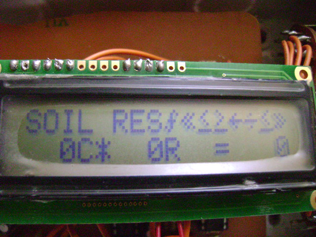

                              Hi Ivconic. Today i checked my ERM from EPE 2003, and i noticed that the article talk about PIC16F876 and also PIC16F877. In my case i using PIC16F876.
                              So, do you know if this could be the cause of my wrong numbers on the lcd?
                              Look at the pictures, this values are all different and comes on the lcd everytime you turn the unit on. This show me that there is some wrong connection or may be something wrong with the PIC.
                              Also the rigth number with the # symbol of the first line, never changes and what ever you do, it is always on cero ( 0 )
                              Programming was done has was indicated by EPE. No mods, no intervention to the code, etc.
                              Xtal is 3.6864 Mhz
                              PCB traces and connections where checked again and looks fine.
                              I dont know what to do know.
                              In advance many thanks

                                Nelson....i am very sorry!
                                My mistake!
                                If you used my pcb than i now what is problem!
                                I made few small (yet bad) mistakes on that pcb. I missed two connections.
                                When made it i also had same problems as you and after couple hours of scratching head i founded out! Two missing connections!
                                Sorry, sorry, sorry!
                                I totally forgot that ! I forgot to post corrections later! Until now, nobody asked me about this so i forgot to post corrections!
                                Ok...to solve that problem is VERY EASY! Don't worry.
                                Look on posted picture and apply those two changes. Just connect those traces and your problem is gone forever!
                                Sorry again!
                                Best Regards!
