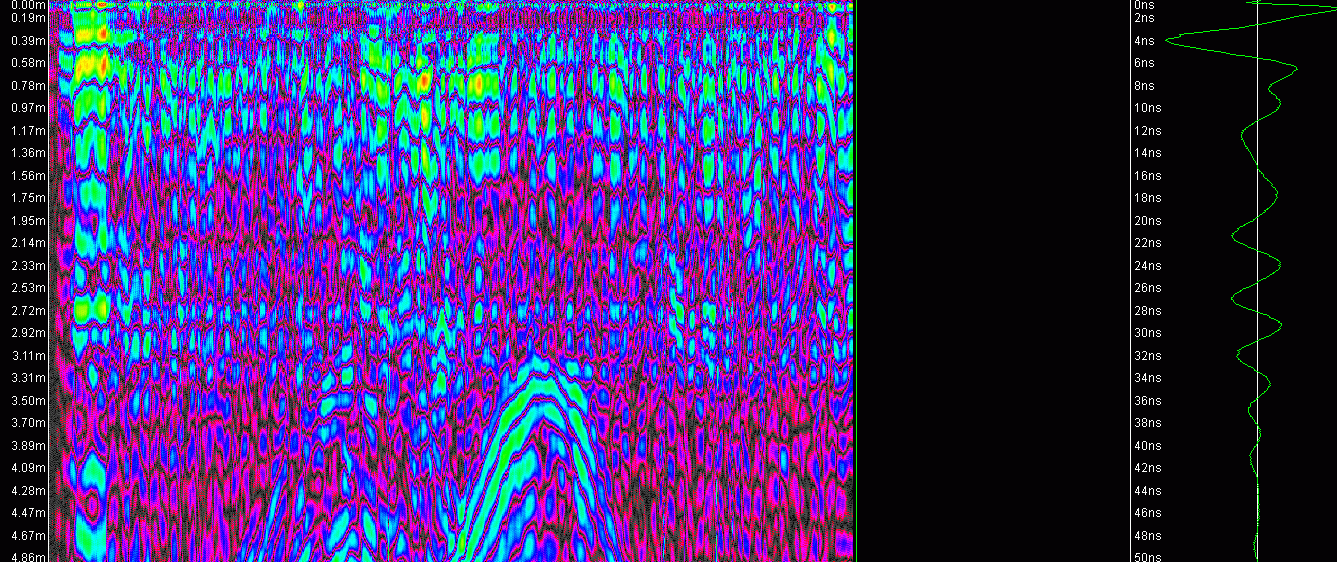

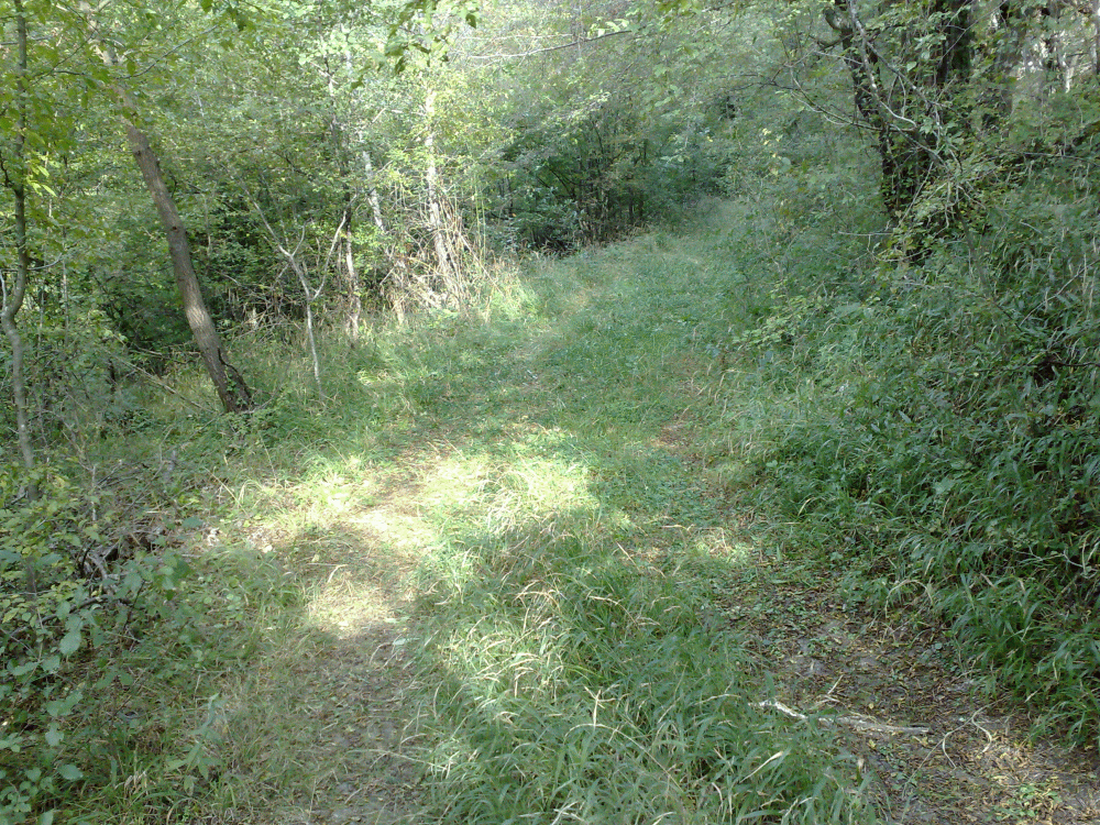

              The decision to dig was taken at testing the prototype in an area far from Plovdiv which is shown in this picture. The white color in the middle of the picture is spot lited by the sun. The test was to understand how the radar will show this terrain on the screen. Here comes the surprise.
                The attached photo on the computer screen shows something unexpected. Radar shows that in this place there is a cavity at depth of about 3 meters. Probably know, that under the law of Murphy, the team has not worn tools for digging.
                The only thing they could do is just to take a picture of the terrain to be able to find this spot again. Then it was decided to terminate the experiment and the next day to go back to this place with digging tools and dig to a depth indicated by radar.

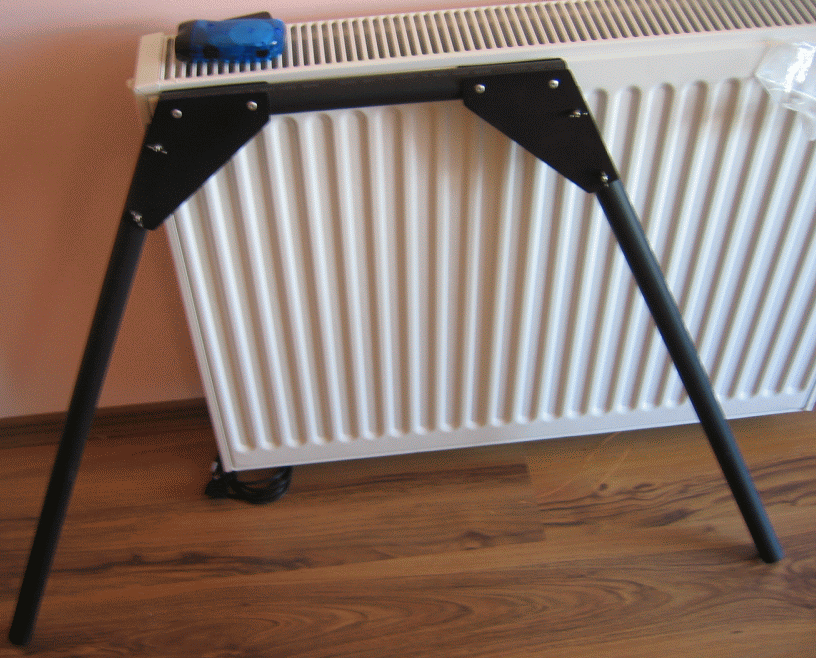

                      THE HANDLE
                      Now I will post two pictures of this project available. Unfortunately I do not have a photograph of the whole machine, when assembled and connected to a netbook. The attached picture is the support rod, which for complication is backed a radiator for heating. On the radiator is placed a LED dynamo torch from which to assess dimension of this handle.
                      In the lower two ends of handle are attached small boxes with antennas that are in the photo of next posting.

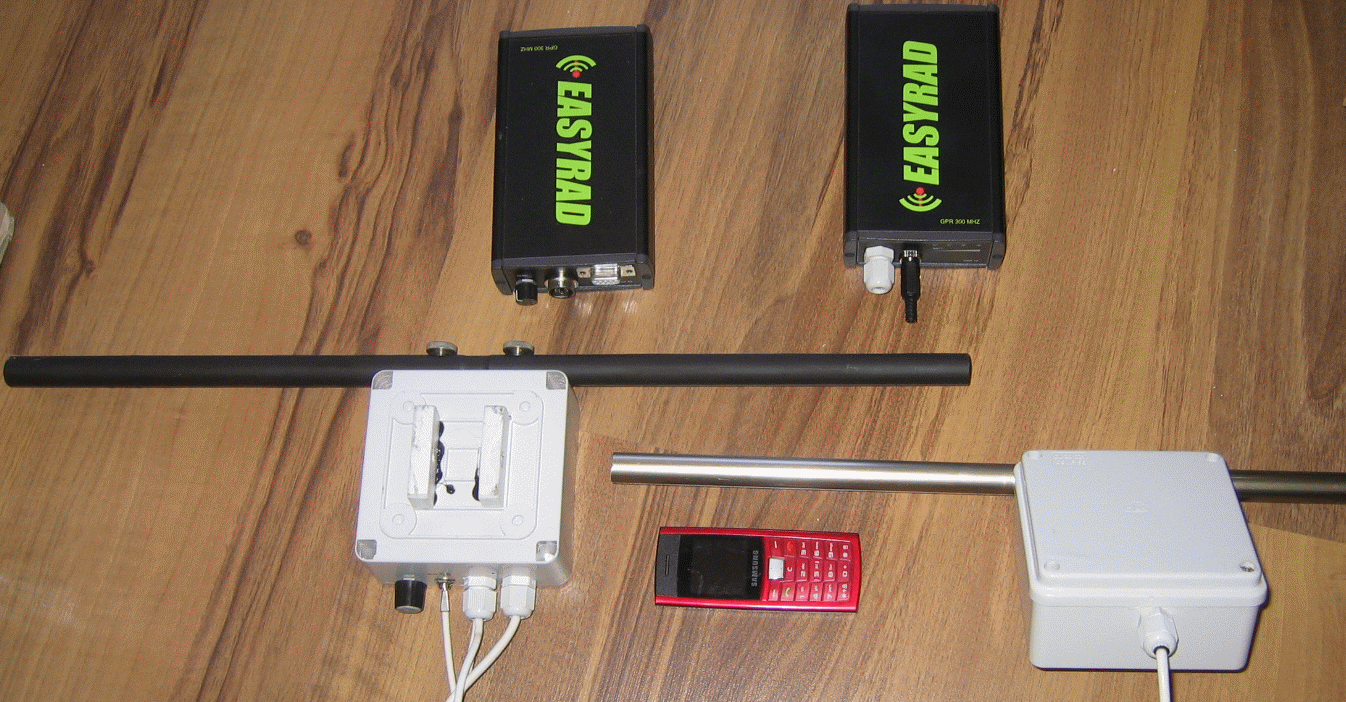

                        THE ELECTRONICS
                        The photo below shows the prototype for test, which consists of two white boxes with antennas. Boxes are fixed at the ends of the support rod shown in the previous post.
                        The two black boxes placed above and designed as EASYRAD are not prototypes. They are in the real kit, which will be sold in the future (may be soon:-).
                          Hi Mike, are you sure? Maybe only your group left cavity behind after digging?
                          Waiting for picture of those cavity.
                            WM6, I am sure that according the law of Murphy they have no source for illumination and won't able to take pictures what is inside the cavity. As we see in the image of posting # 11, they have forgotten the LED dynamo torch on the radiator.
                            As we see in posting # 12, a cellular phone is also forgotten.
                            However this is not the problem; the others have phones, but they are useless because this region is not covered for cellular phones. More dangerous is that according the law of Murphy, they surelly have forgotten to bring a rope and ladder. There is a danger one or more diggers to fall inside the cavity and other to have returned to town for rope and ladder. May be in their car there is an automobile rope. Unfortunately in such terrain their vehicle can not be nearby, but only in it has first-aid kit.
                            As I think about these things, I hope radar to sin and this is not a real cavity.
