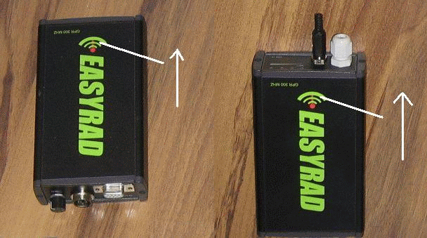

      Are these the same generators ?
      Uploaded with ImageShack.us
        Unknowing, the black box in the right is not generator, it is receiver

            Unknowing, you don't know how to rotate image.
                Yes, I agree! Unknowing, you are Knowing!
