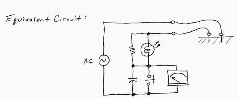

    I want to know if here is a circuit that with it i can measure earth resistivity?
    i sow somewhere at this forum a schematic that has only one capacitor, one resistor , one lamp, one analog voltmeter. i wonder to know if it work or not?
    what voltage is need? AC or DC? how much voltage? how much amper? and capacitor is how many uF? and can i use digital voltmeter for this schematic? if no, why?
    is here any better schematic for earth resistance meter?

      Here is the article describing the project:
      http://www.geotech1.com/cgi-bin/page...rvey/index.dat
      It is not a good design, and you should instead consider Beck's project:
      http://www.geotech1.com/cgi-bin/page...erm1/index.dat
      - Carl

          EPE did an update of the Beck design in 2003 by adding a data logger to it, which I highly recommend. I don't recall if the core resistivity circuitry was updated or not. Unfortunately EPE did not give me permission to post that article.
