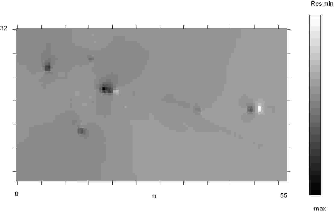

I solved the problem right on the welding of R31 that was not good. The final machine works well, of course the accuracy and resolution are not the best (only 8 bits), but for amateur applications is fine. To download the data I had problems so I had to make the suggested changes to the board on the article of Becker. I leave attached an image of a test I did in the country. Thanks for your interest and for the answers. When I have something interesting I'll post it.
Thanks AlgolOriginally posted by algol View Post
Very impressive I must say certainly works, keep us imformed with you progress maybe at some point i may try and build one now after seeing your results.

Hi! ALGOL what software did you use, with your EPE data logger of John Becker?
The software is Surfer.
But it can use SurfIt or other free gridding-contouring software.
