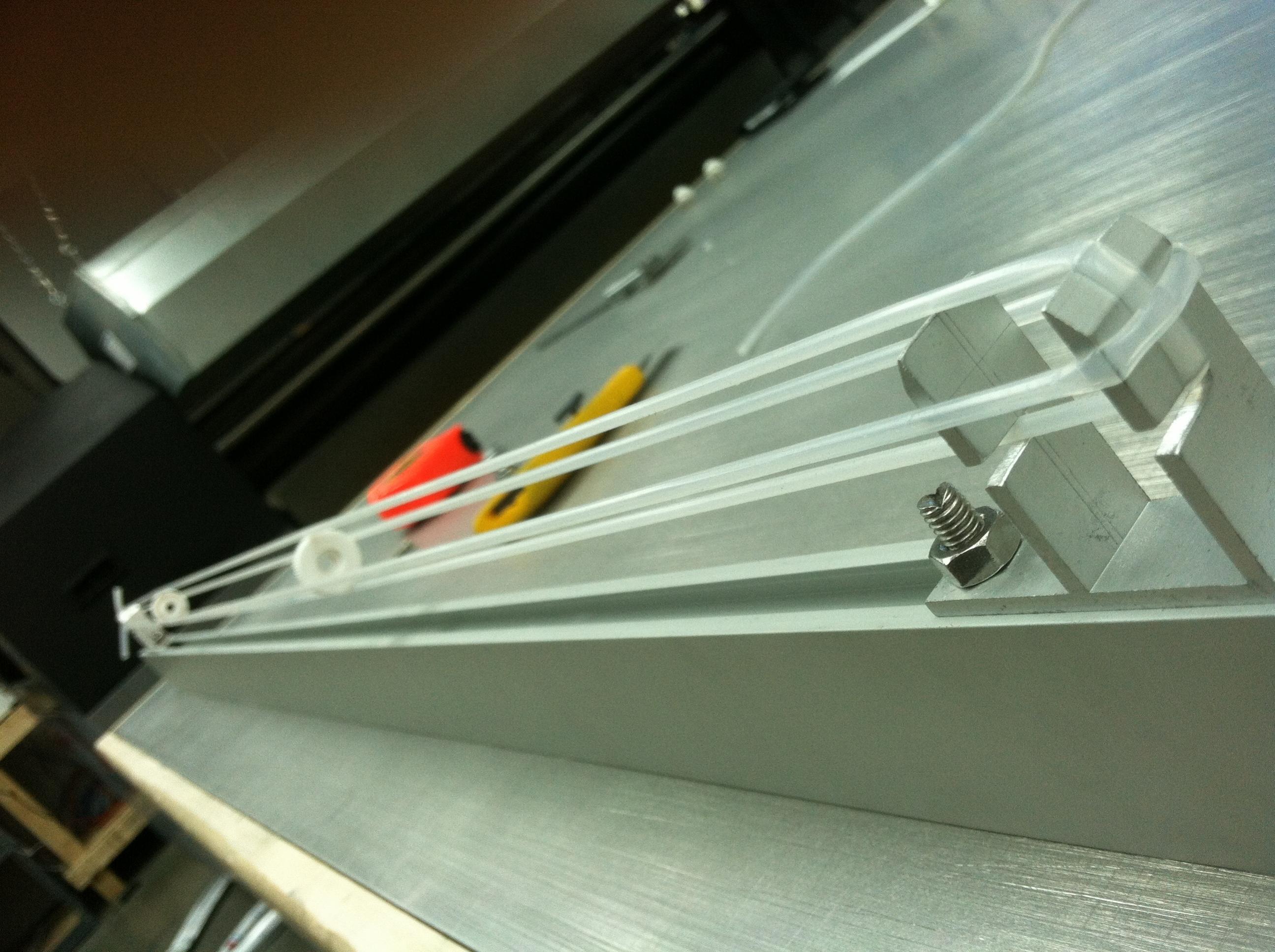

      I have idea to get it in between tense tygon tubing that i have at work. It is very flexible material and has lot of friction with glass. I assume fgm3 are glass. I decided to try align them with use of flexible tension in the air. Then im thinking to put them tensioned in wax bath which can be upto 65C(hope sensors can undergo this temperature outside operational. And then glue them together with acrylic sticks c.3x5mm and gorilla glue about half way around sensors. After that i will use two rings to set bottom sensor head down solid and one ring near bottom part (head) of top sensor. Then three nylon screws for adjustement. Will see how far will i get with it.

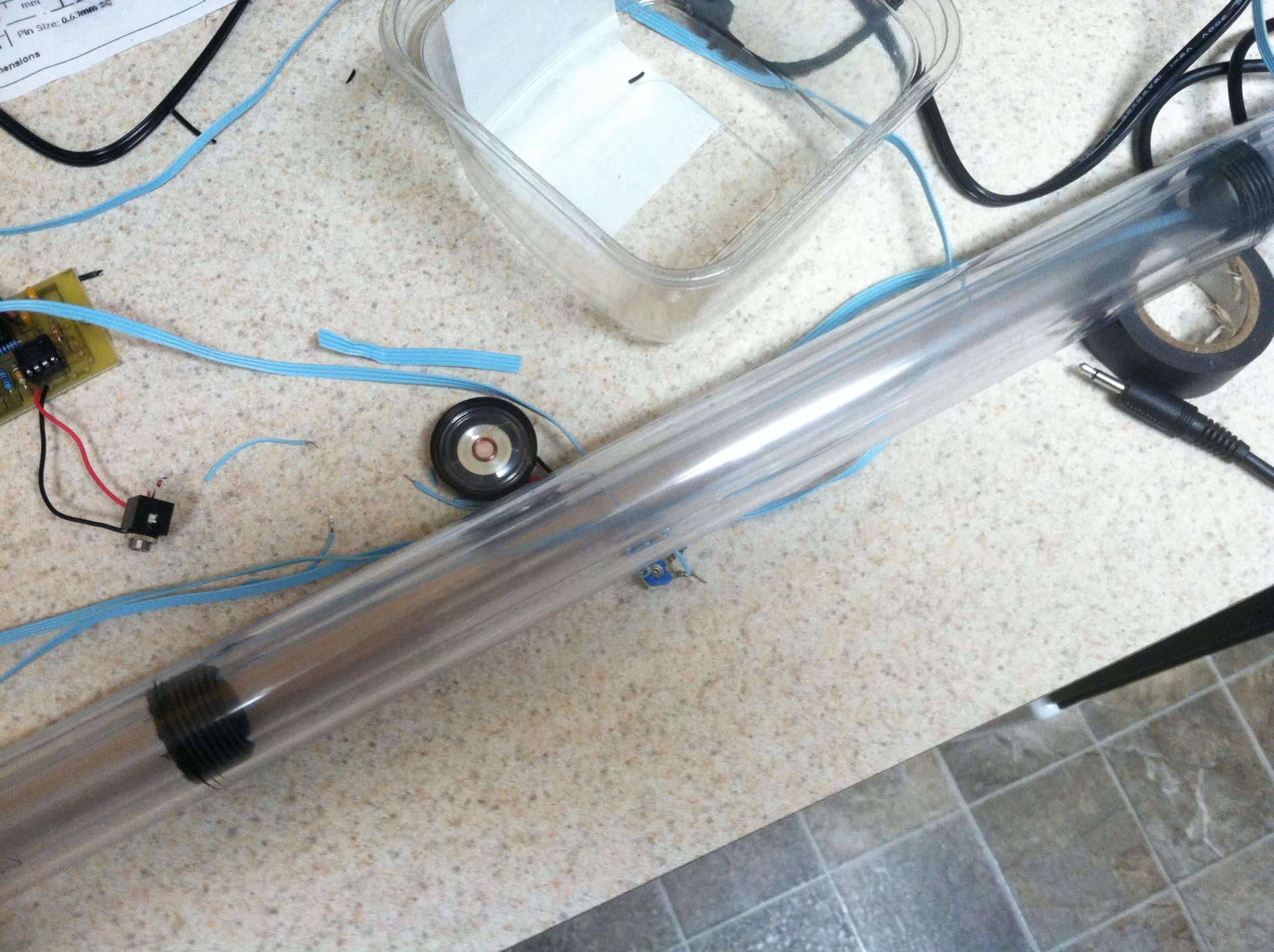

          Here assembly for initial sensors alignement

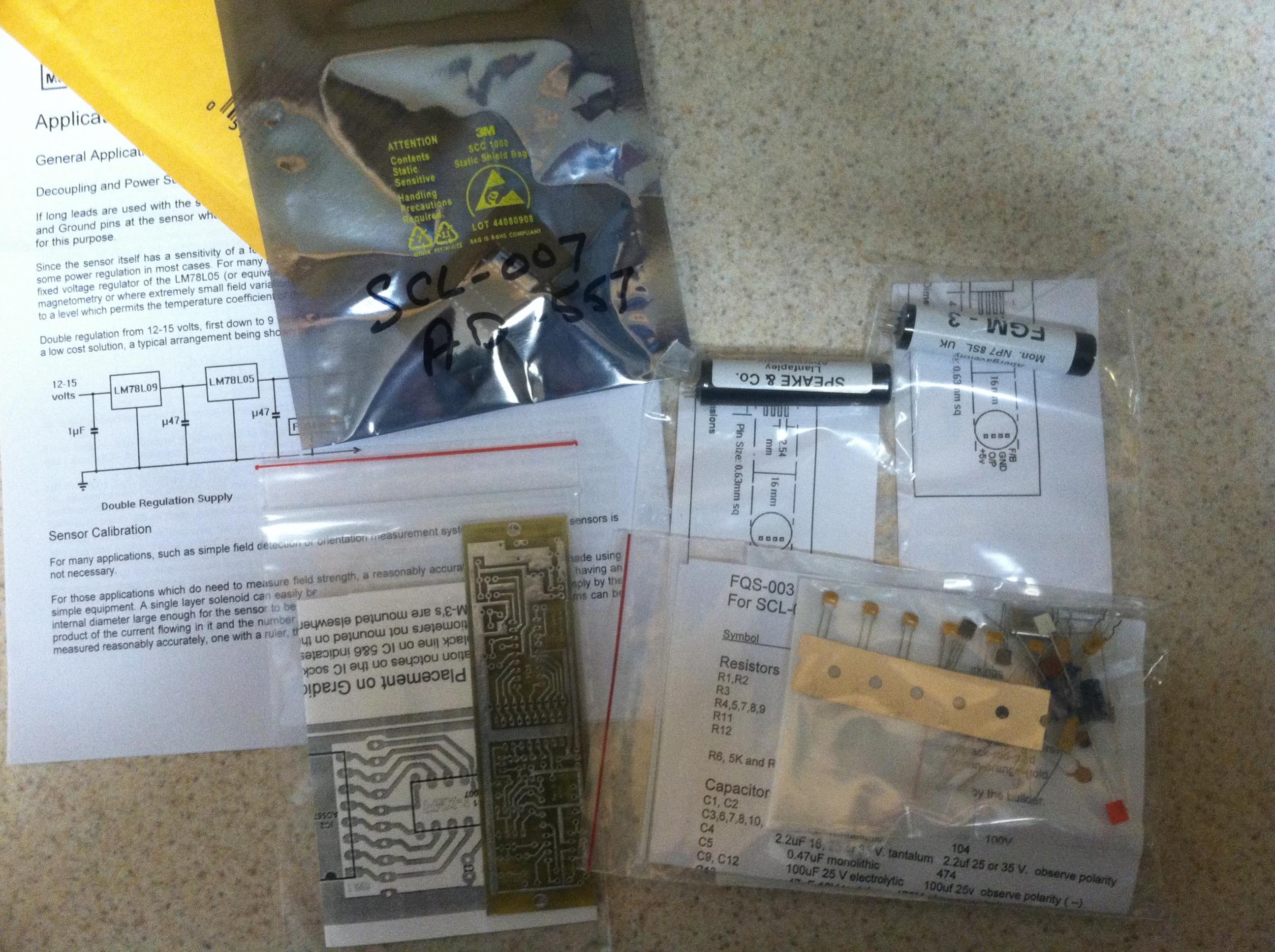

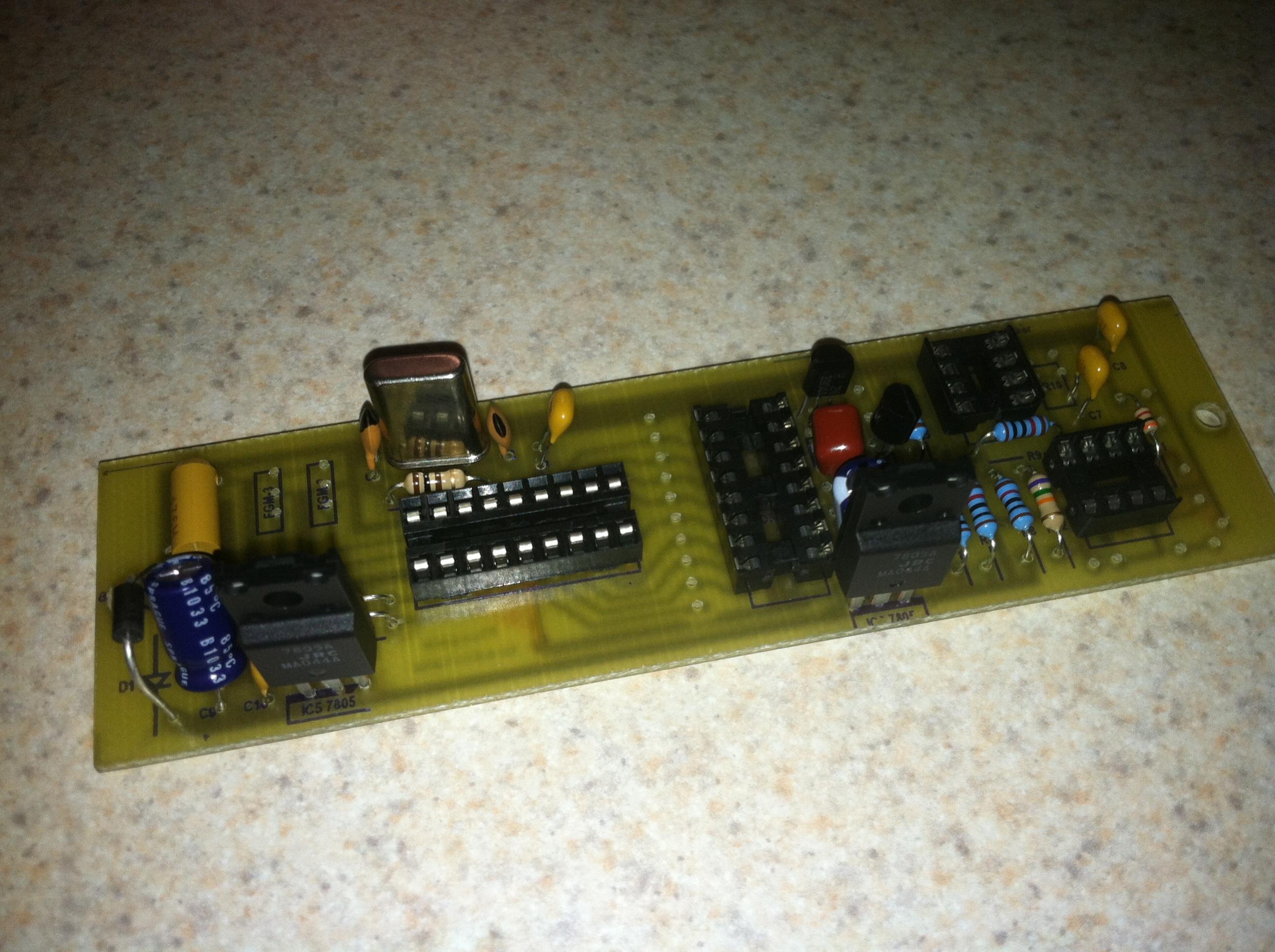

            So i received kit! It is great. Fatquartersoft guys included all parts drawings nicely packaged with all description. Here picture.
            I ordered polycarb tubings and nylon threaded rod. Now im goig to learn some circuitboard soldering on youtube i decided not to mess with wax and air alignement.. Just tubes and spacers. Maybe some resin work.

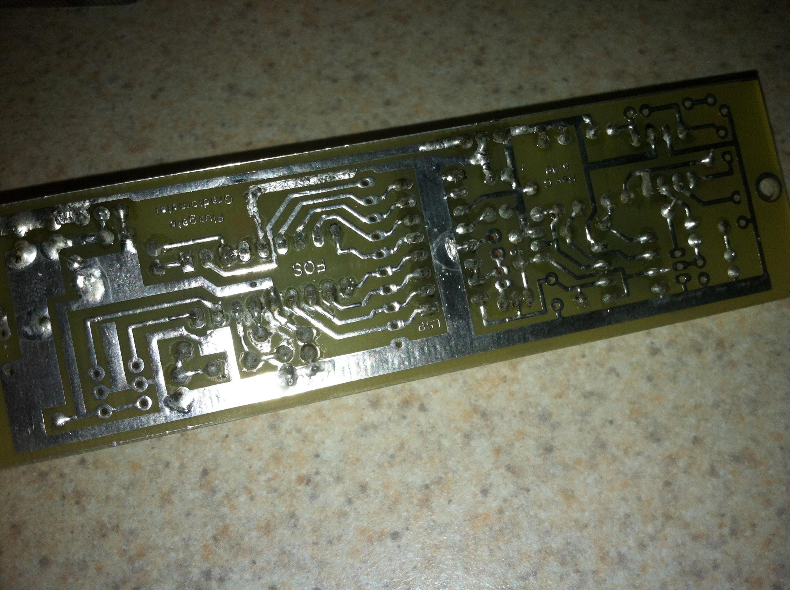

              So board soldered. Great experience. Click image for larger version
                Also
                Also ordered some pots, button and leds. Stillneed ribbon cable. Bought 24 gauge intercom cable 4 conduct which sux. Pipes coming next week. Also need header sockets. Also had to resolder mosfets. Put them bad way

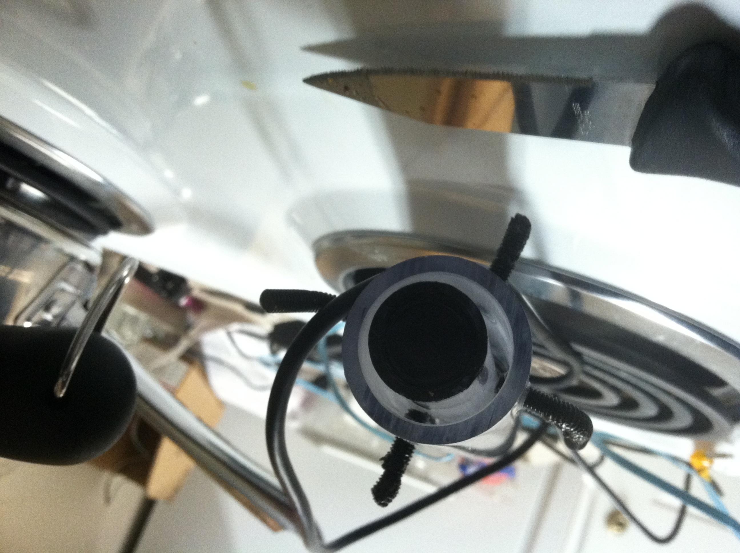

                    So today i switched it on for the first time with all basic parts soldered. Without any calibration switched it on, and got sensitivity for small maybe 1x5cm, pretty thin kitchen metal blade with plastic handle at approx 20-30 cm distance hearable. Also made mono jack 3.5 connector with little resistor for audio into ipad/iphone. Getting polycarbonate tubes and nylon screws soon.
                      Test was done in the middle of kitchen equipment. So starting frequency was little higher( maybe like car running idle).

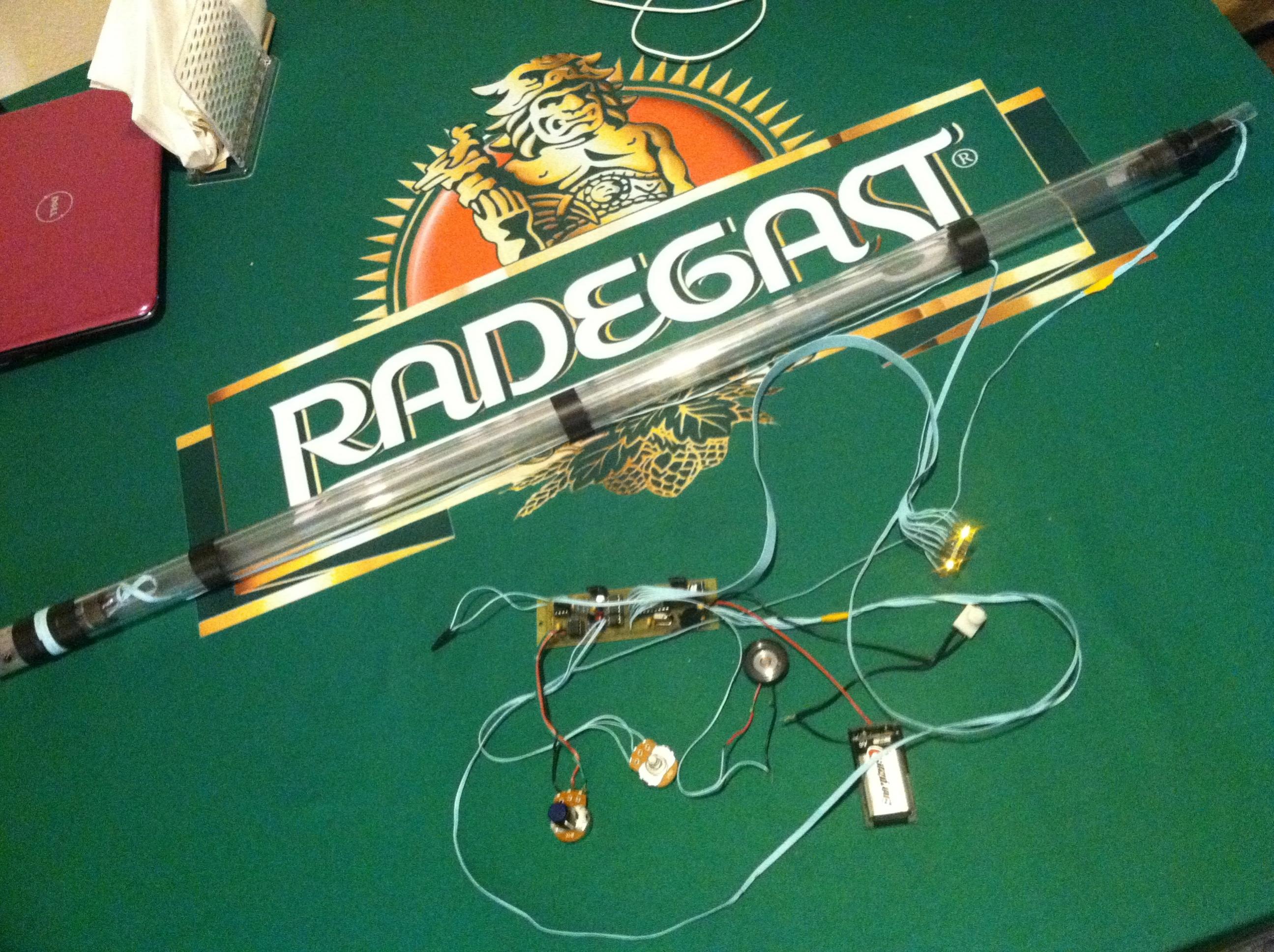

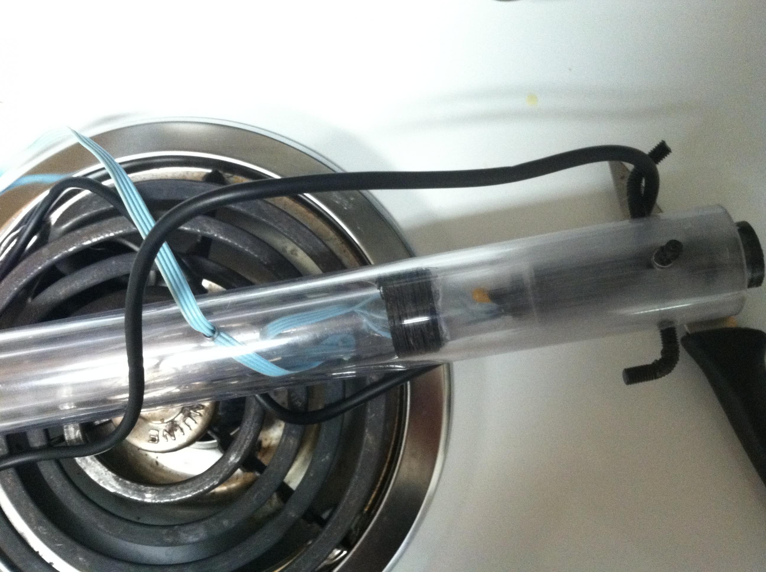

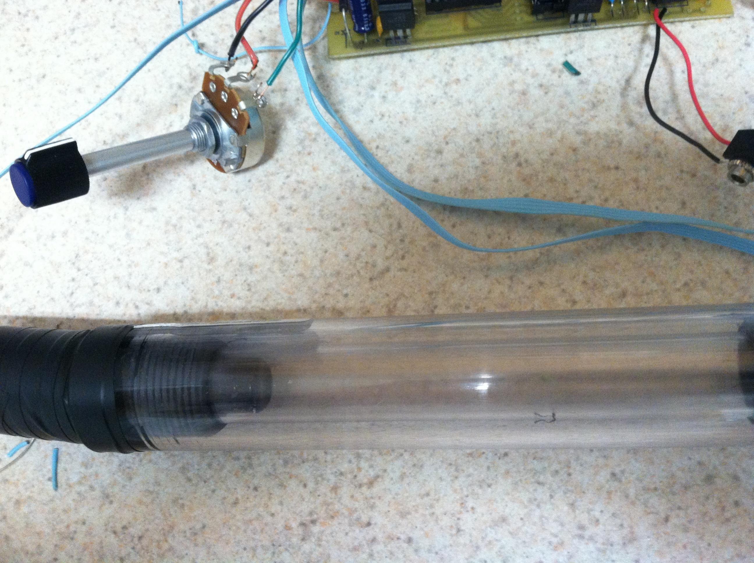

                        So sensors are aligned, everything is almost done. There is 5/8-3/4 polycarb tubing 3' long with sensors in and 4 spacers around. All is inside 3/4-1" polycarb tubing with 4 nylon bolts on top for alignement.(need to make them nicer). Tried to connect jack to ipad and run spectrogram. Everything works fine. Just starting frequency is little to high i think. Tried to calibrate in middle of livingroom and after calibration there wasnt much change in freq in open air before i went closer with metal kitchen knife. Sensitivity seems to be pretty weak yet. Still about 20-30cm around sensors. No sensitivity in middle of tube. Waiting for better volume and threshld pots. I think when calibrated outside without field interference it will be better. Just dont know what starting frequency should i expect after calibration.someone knows?
                        here pics

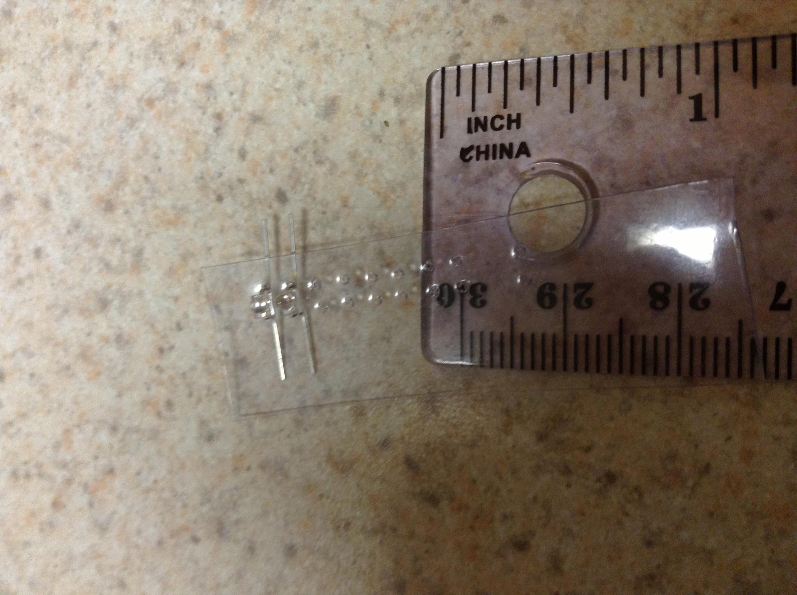

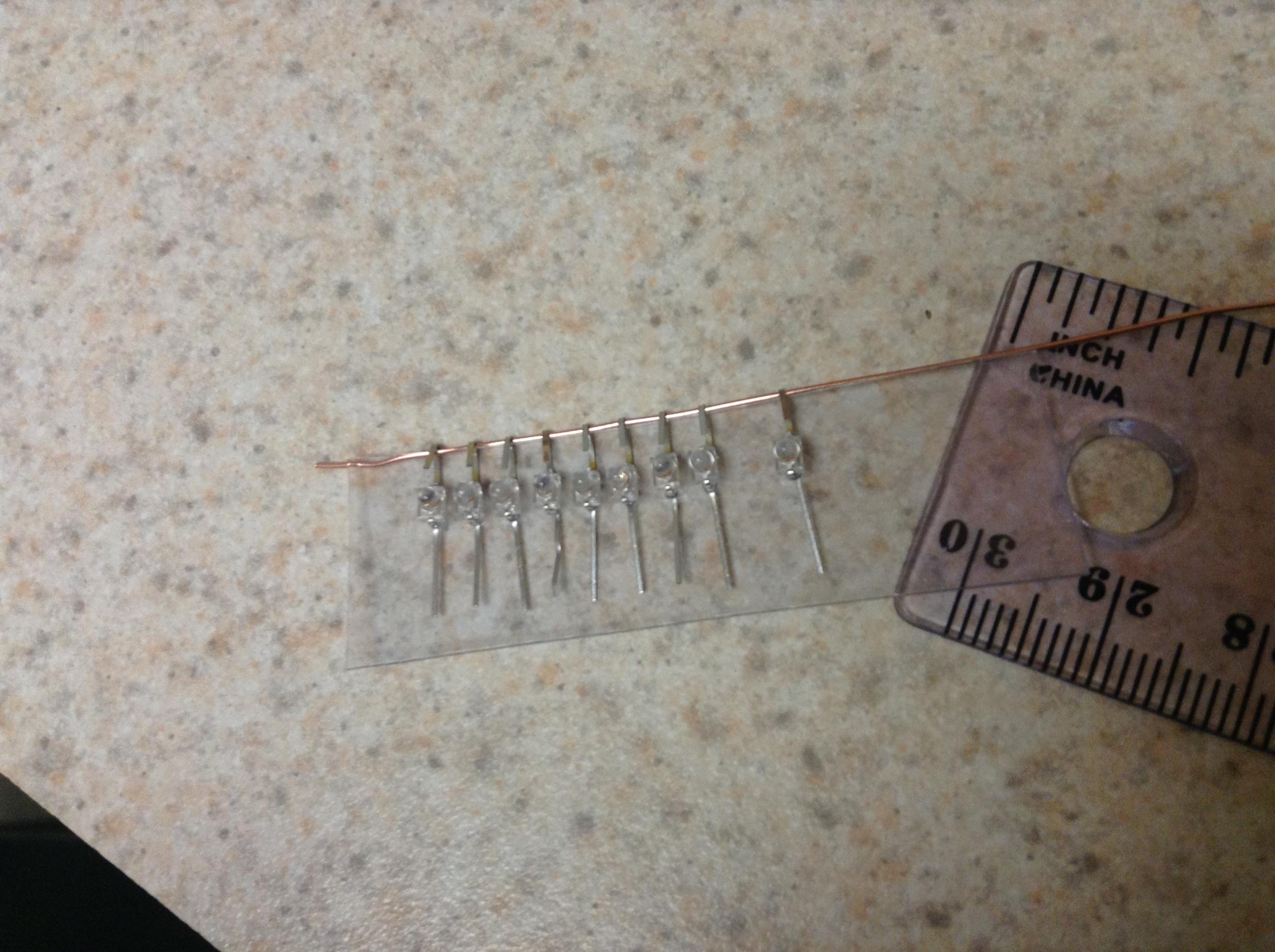

                          1/ i want to set leds between scl007 and dac. I bought 1.8v leds. I dont have voltmeter(cuz im newbie) so i dont know what kind of resistor do i need. I tried to just connect a led to scl pins with ground and also to sign bit pin and it looked fine without resistor. Im just worried that itslifetime may be very short if without resistor.

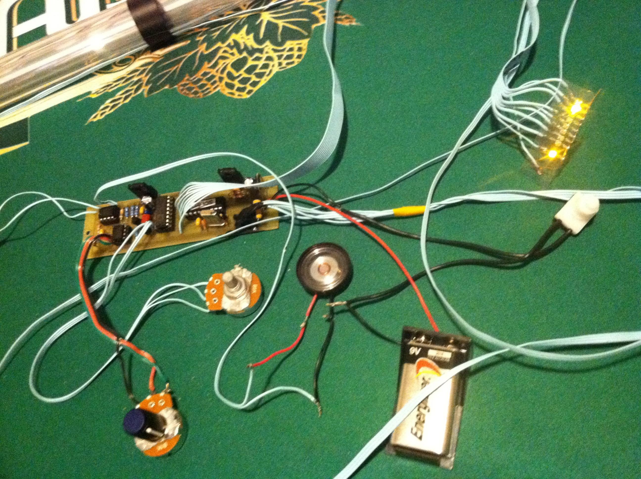

                            Here leds i think here electronic gurus will find it entertaining
                              So it is completed. It is nice to see how 1s and 0s are running digital to leds. Didnt use any resistors hope they will hold. Sign bit led works wierd. Treshold doesnt affect leds.
                              This project is great documented and dummy proof. Thanx a lot carl and fatquarter software for all parts and manuals. Here some pictures. In weekend i will put some insulation and put whole probe into other final tube where on the end all controls will be mounted together with leds and speaker
