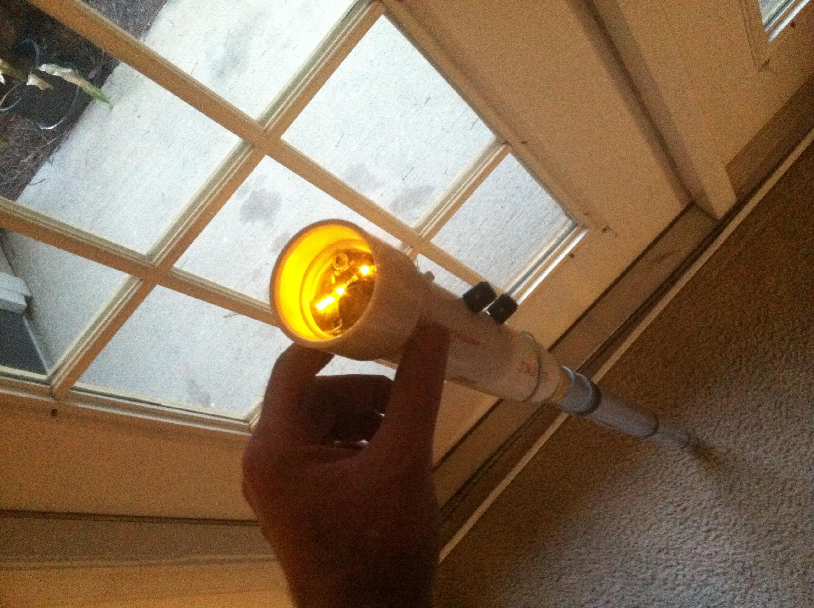

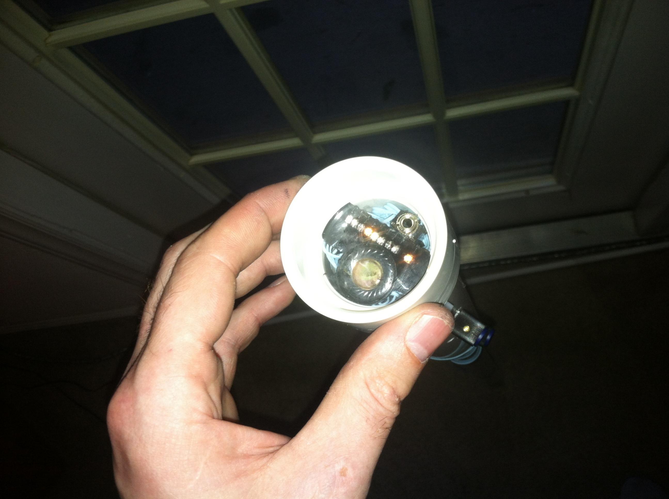

      So finally figured jack connection. Found out that there exists switch type jack which i succesfuly installed for connection with iphone or ipad( maybe useless but works. Next thing is that i also noticed much better sensitivity with leds. It shows change already even if speaker change isnt really noticeable plus sign bit led shoots on too.
      Did one test with about 1/64 wall scrap hollow iron rod 1/4 diameter 3' long bent in V shape for sensitivity.
      Leds do catch that rod in distance of around 4-5' airtest. Hearable Frequency change comes in around 3-4'

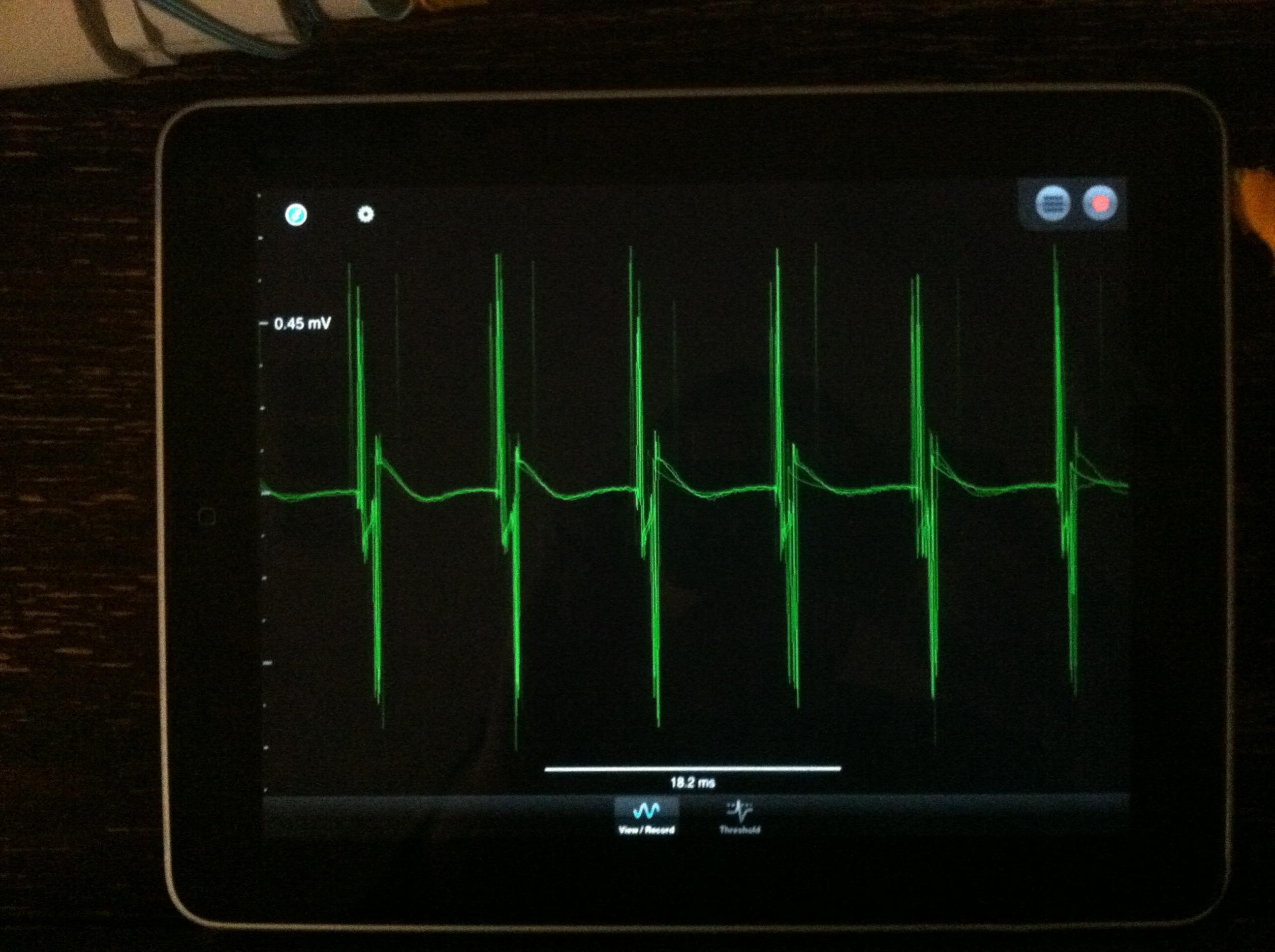

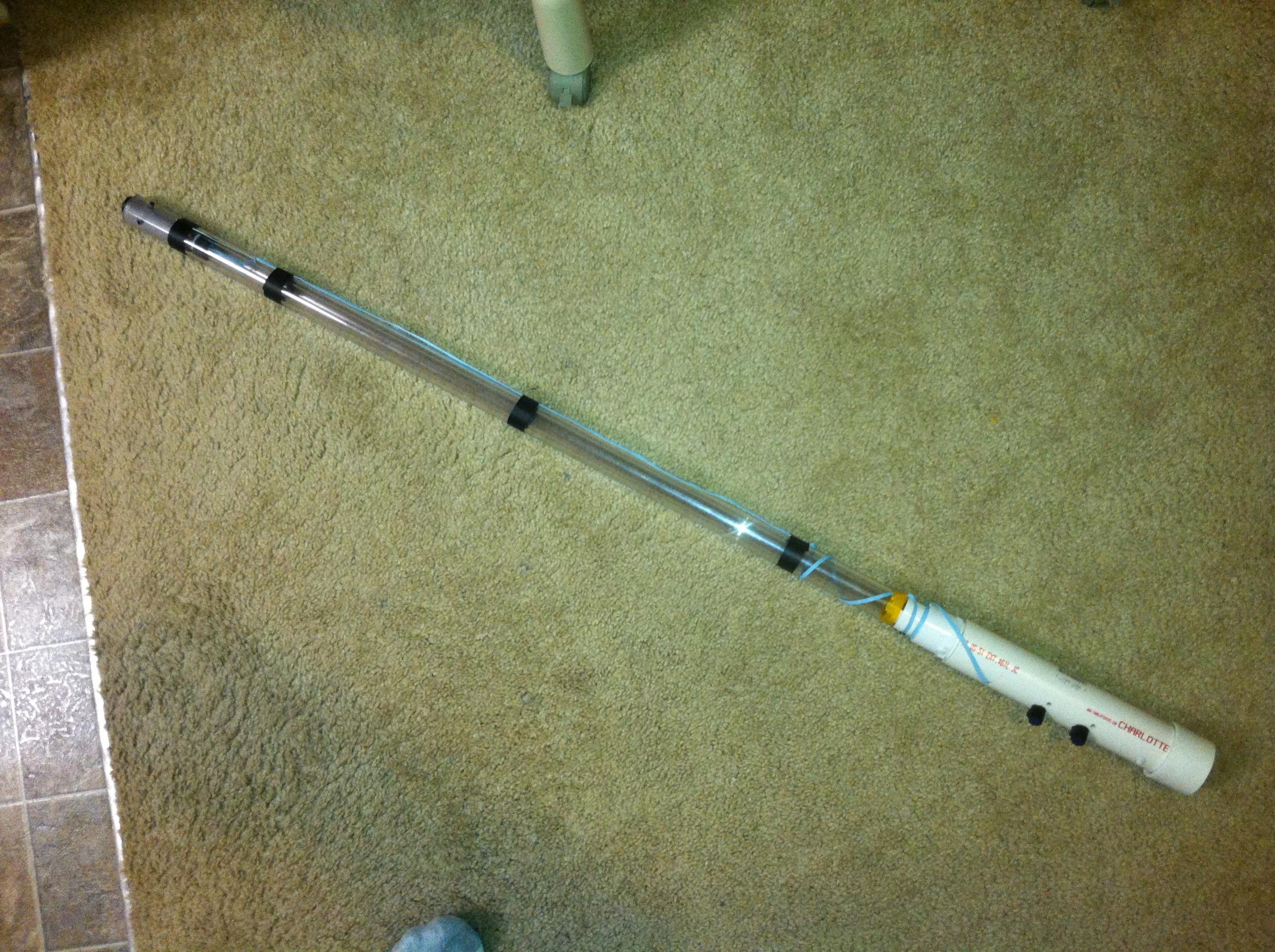

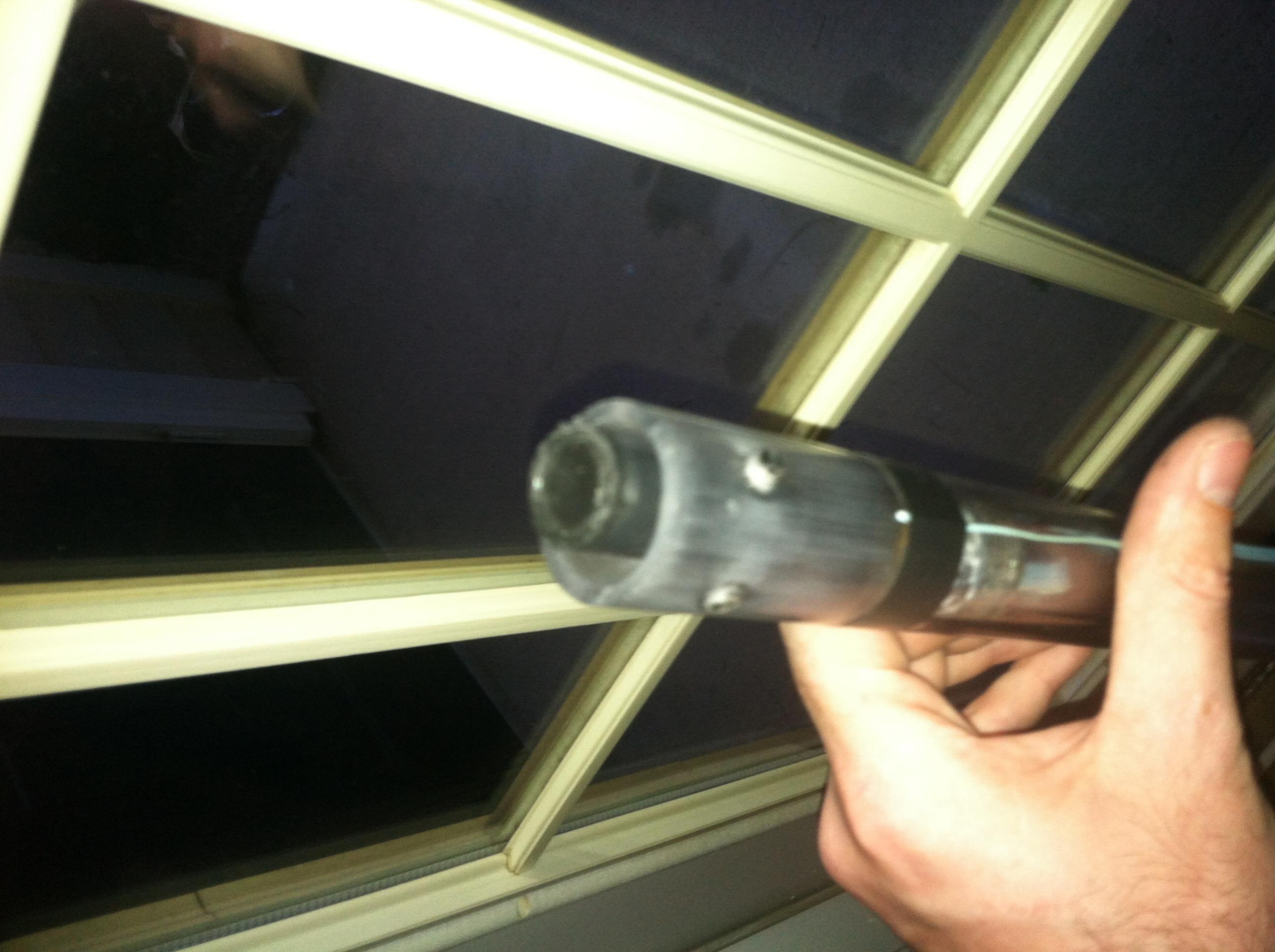

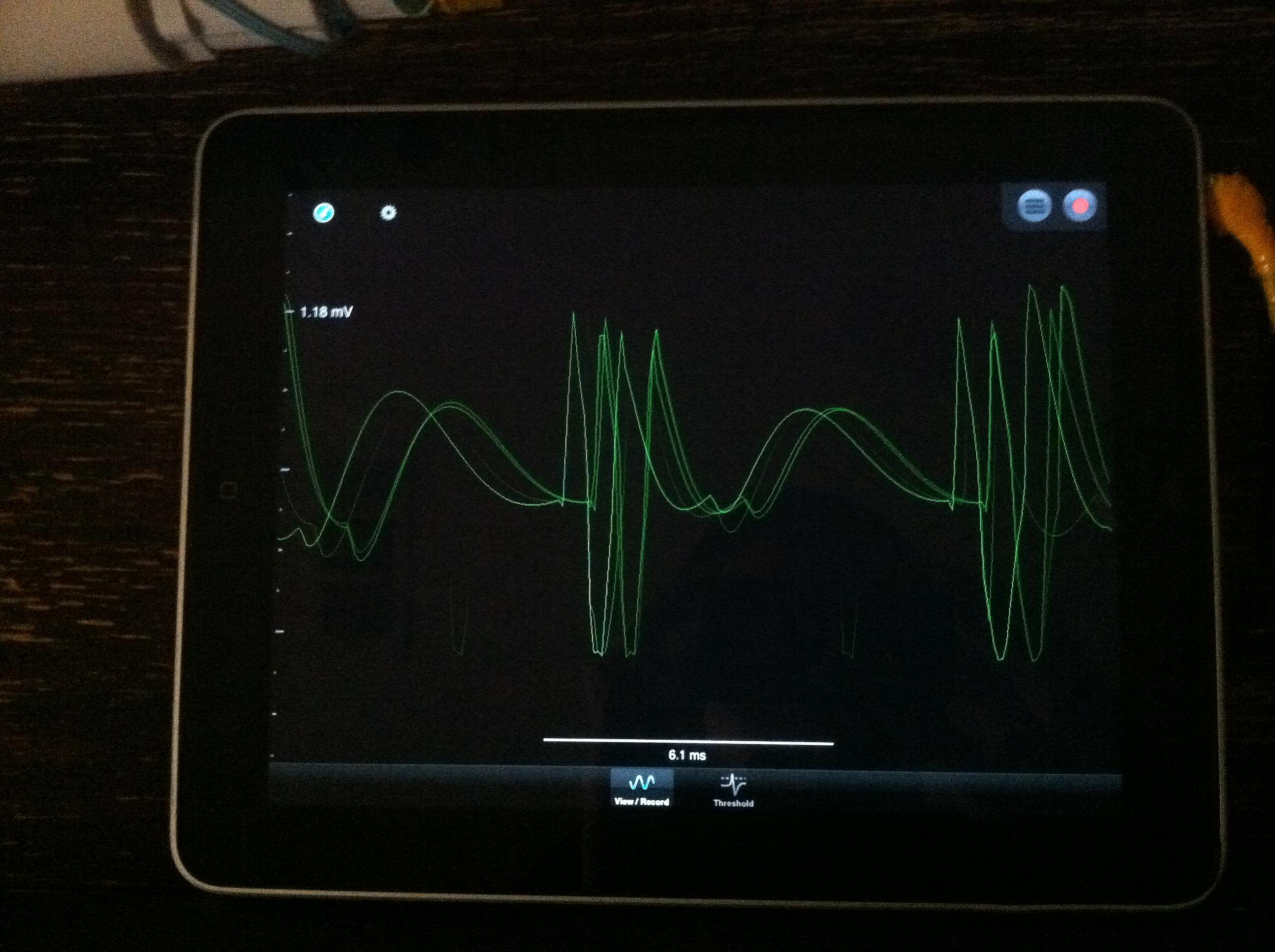

        Finished... Working good. Calibration works ew horizontal rotating 360deg. Then vertical operating. Here photos!Click image for larger version
ID:	335957Click image for larger version
          Conected to ipad through 3.5mm mono jack with resistor. Free app backyard software

                Correction.. Sensor tubing is 5/8id 3/4od, spacers are 3/4id 1"od and main tube is 1"id and 1 1/4od so wall of main polycarb tube is 1/8 thick and wall of thinner sensor tube is 1/16. Adjustement Screws are 10-32 thread.
