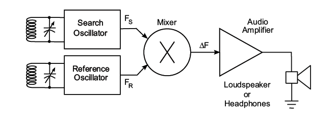

                  or make it simple for metal detecting, Δ F of your sensors,

                      0 = Fs, another numbers = Δ F​,

                      So you need 2 frequncy meters or 2 DC voltmeters programs.​
