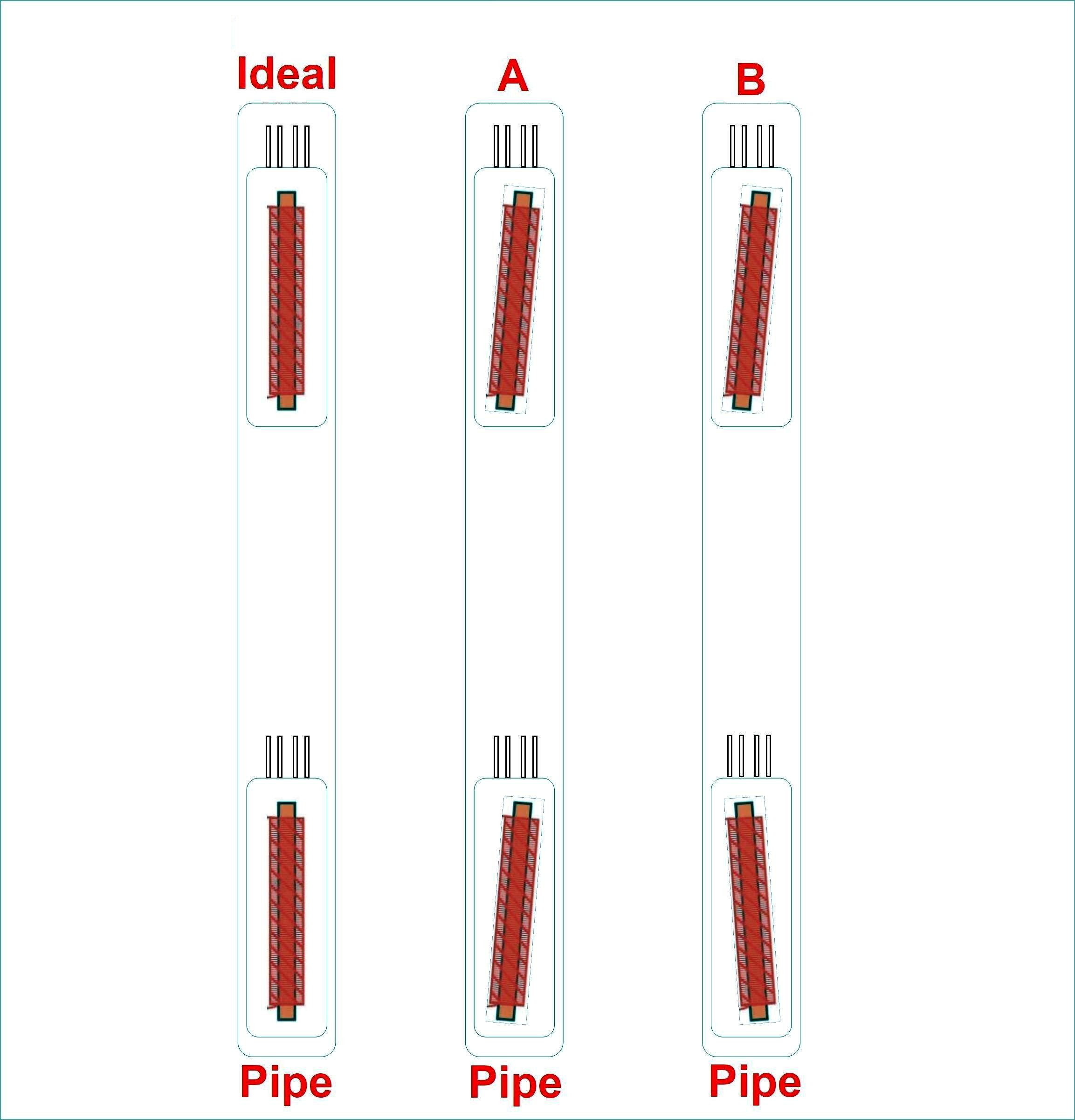

              So far I have had over 50 maybe 100 FGM3 sensors.
              I opened several of them during the period of time and looked at the internal morphology.
              The long narrow pcb on which the coil (two biphalarly wound) is attached, is placed in a plastic container and filled with epoxy.
              I assume that in the process of "curring" the epoxy, minimal relative displacements occur.
              And most often, the whole assembly is slightly moved at the end.
              As in the picture.
              First from the left is the ideal situation, which never happens.
              Most often, either case A or case B occurs.
              It becomes clear why the sensor readings are not the same and are not linear to each other.
              There will always be a error and difference.
              Keeping this in mind; it is clear that the most accurate measurement is when the tube is always kept in the same position, orientation and rotation.
              Because then the shift between readings is always the same.
