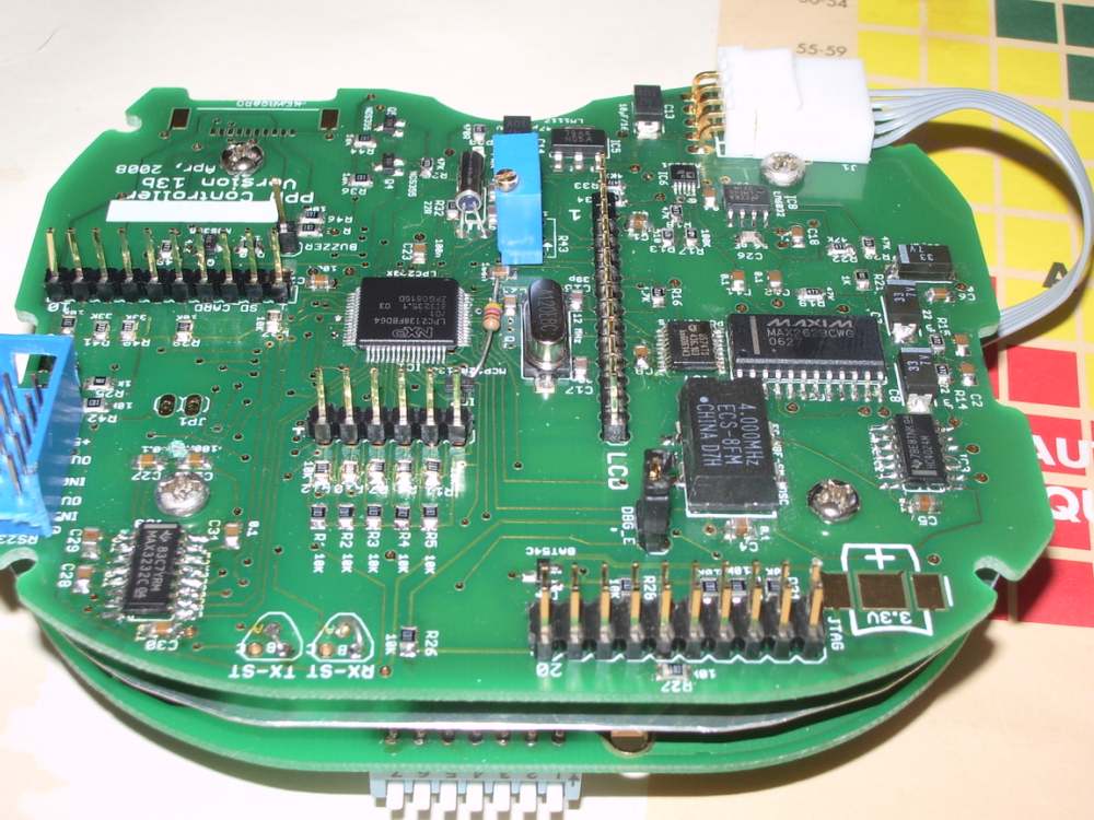

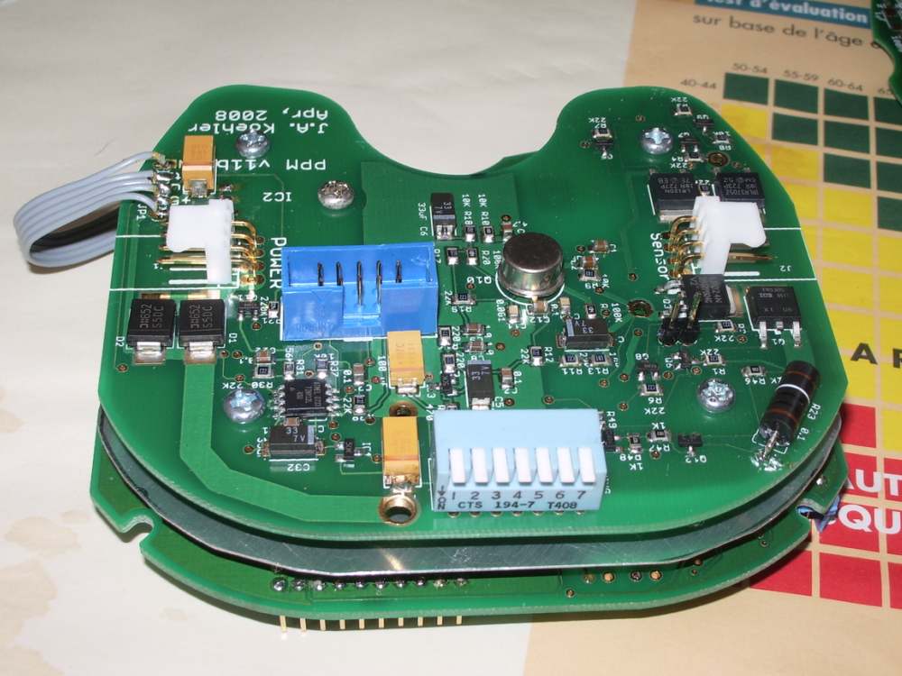

      I have received the first set of assembled and tested boards. They look perfect. Next week-end, we'll hopefully make their integration in the box and test the system with the first newly built sensor.
      This is the pictures of the two main boards.
      The things are progressing well, we are very happy.
      Willy
