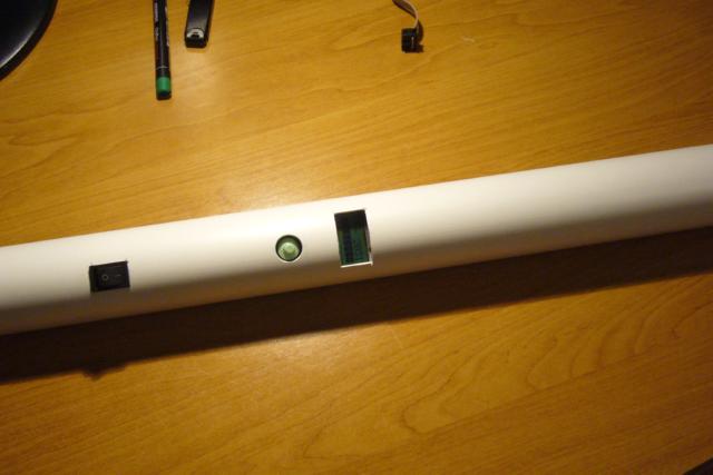

      I greet, I am new in discussion; my english only from translator.
      My attentions to settlement of sensors:
      1. Finished, complete gradiometr 1m over the ground in line E / In in sincere field (minimum EMI).
      2. turn over 1 sensor round his axis on minimum of signal.
      I take the care about stiffness of pipe (diameter 50mm from installation of central hoover, the length 1,2 m);
      neither! the metal in neighbourhood of sensors, copper lines, thin, as the furthest from axis of sensor, the tight sensor in rolled out plastic cylinder ( the axis + the thermal isolation).
      In position of work (vertical) the signal is always ( the initially large difference of magnetical field), really we to place the minimum frequency of acoustic signal can now.
      Best regards, K.

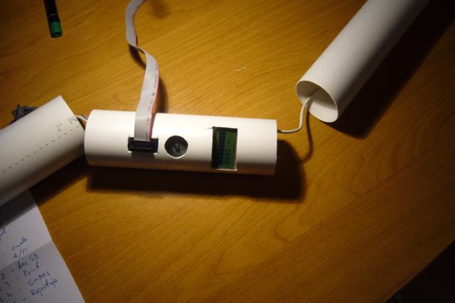

            Originally posted by damiafix View Post
            Hi Krzysztof,
            many thanks for your reply, can you share some picture of your mag probe?
            Hi Damiafix
            A few photos.
            As the foundation of the electrical system 47mm is a pipe inside the pipe 50mm with a central vacuum cleaner, still experimental version that easy to dismantle and change.
            Polls in the treated plastic shaft (thermal insulation and preservation of the axis).
            At the same time loads on pipe further stabilize the equilibrium (as the camera operator handle TV).
            Battery 3.7 V from Nokia, all the elements in the middle.
            I am already unhappy with the length (105cm) because I have to bend down.
            Joystic is good in the portable phone, but this will be useful in the design
            of the buttons as Fitz - the need for resistance. Do you have any suggestions for a good small type inserted from the top?
            Best regards Chris.

              • #52
                Hi Damiafix.
                Here, you not satisfied.
                I have other systems MI, the probe - and I work for ATMega8 Atmel.
                Practically the presence of small amounts of metal in the area is unavoidable. If you do calibrate the MAG is finished you drive changes to a minimum (0 is the laboratory). Any change in your position and your meter has changed the outcome.
                Position horizontal in the W / E you get results close to 0, assuming that the probe without regulation is on the line W / E.
                If a mistake is the resultant outcome will be the sum of two different positive and negative deviations.
                Therefore, it is safest to rotate the pipe as a gradiometer W / E around its long axis by 180 deg for control tuning.
                In practice, after tuning on the line N / S have indicated on the LCD unit 2000, and the vertical pozycjii about 4000 units, this is normal in physics. Vertical component of the magnetic field is in my area 44.8 mikroT box full 49mikroT, horizontal component of N / S 20mikroT.
                During the measurement of any deviation from the vertical gives the wrong signals (at high sensitivity), in addition to EMI interference and the presence of AC pulse does not make life easy for the operator.
                Fitz may be right to set the probe in the same plane (FGM3 are not symmetrical), but have one of the are calibrated to the same axis.
                I will know the results.
                Best regards Chris.
