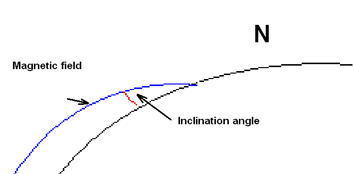

      Hello
      You should turn it in the plane of inclination. (head over heel)
      olsteffe
        Hi Olsteffe,
        many thanks for your reply! I'm sorry but maybe I don't have understood; I should turn the tube, with the wood support placed at the end of the tube (Picture-1)? Or, turn it as in the Picture-2?

          Like you show in picture 2, the vertical rotation.
          olsteffe

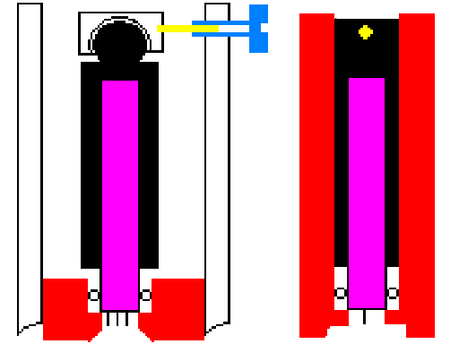

                I have just made a rude sketch of a suggestion for a sensor mount. It moves in one plane only using a M3 skrew inside a M5 skrew giving differential precision adjustment possibilities. One turn of the blue skrew = 0.4mm movement 1/4 turn equals .1mm and so on. both sensors would have to be mounted in similar mounts but orthogonal to eachother (90 degrees)

                    Hello
                    Just to clarify the direction of the inclination angle. It is pointing as shown in the sketch. A normal misunderstanding is that it is pointet into the earth from the north.
                    Best regards
                    olsteffe

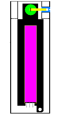

                        Sensormount II
                        Hello
                        I realised that the ball and socket is to complicated. New design suggestion is given.
                        Best regards
                        olsteffe

                              By the way, is there anyone who has comments or question on the sensor mount I have suggested. Please comment. I will try and find the time to draw it up in 3D and post it here.
                              Sincerely
                              olsteffe
