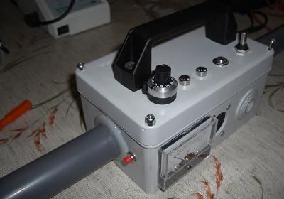

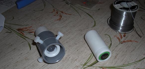

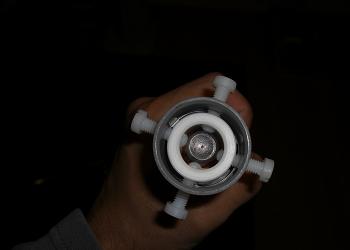

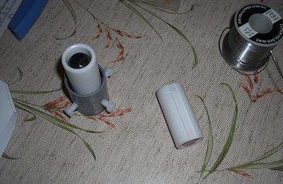

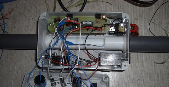

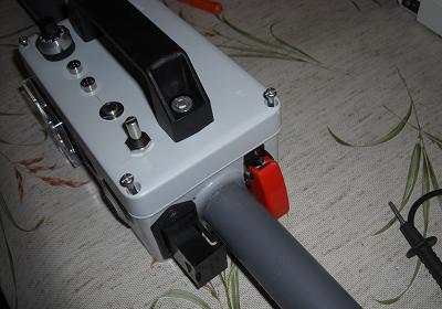

                          Thanks for your help guys .
                          Please find some pics of my mag. I have machined several parts in order to have as accurate alignment as possible. See below.
                            Wonderful! Do you have aligned the sensor? The mag work?
                            All the best, D.
                            P.S. Do you use the analog meter for the battery charge?
                              FGM-3 Alignment and Calibration
                              All the best, D.
                              Hello,
                              Unfortunatly, it doesn't works yet. I just have to align the sensors but I actualy don't have many time.
                              The analog meter is used to check battery level.
                              I plane to add a digital voltmeter to show a "live" value, as explained by Carl in previous mail.
                              Hope it will works soon!
                              Best regards.
