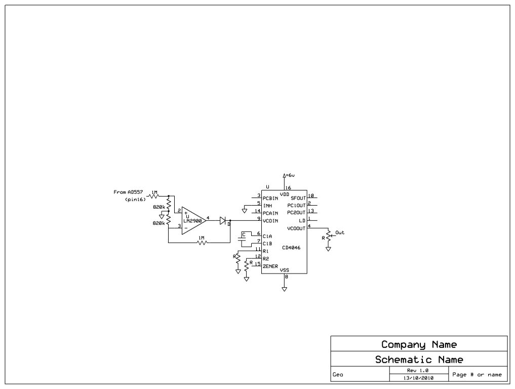

At low DAC out the tension on the emmiter of Q1 is low (0.45V).
Anyway, i found a solution
. I made a DC amplifier wit h gain about 1.5 and now is OK.
I used a Norton op_amp (LM3900) and now is OK. The VCO (with 4046) works from 0.01V to 2.5V (or 0.8 to 3.5 from pin16) and gives a frequency from 50Hz to 850Hz. I must give it a little more upper frequency and i am OK.
