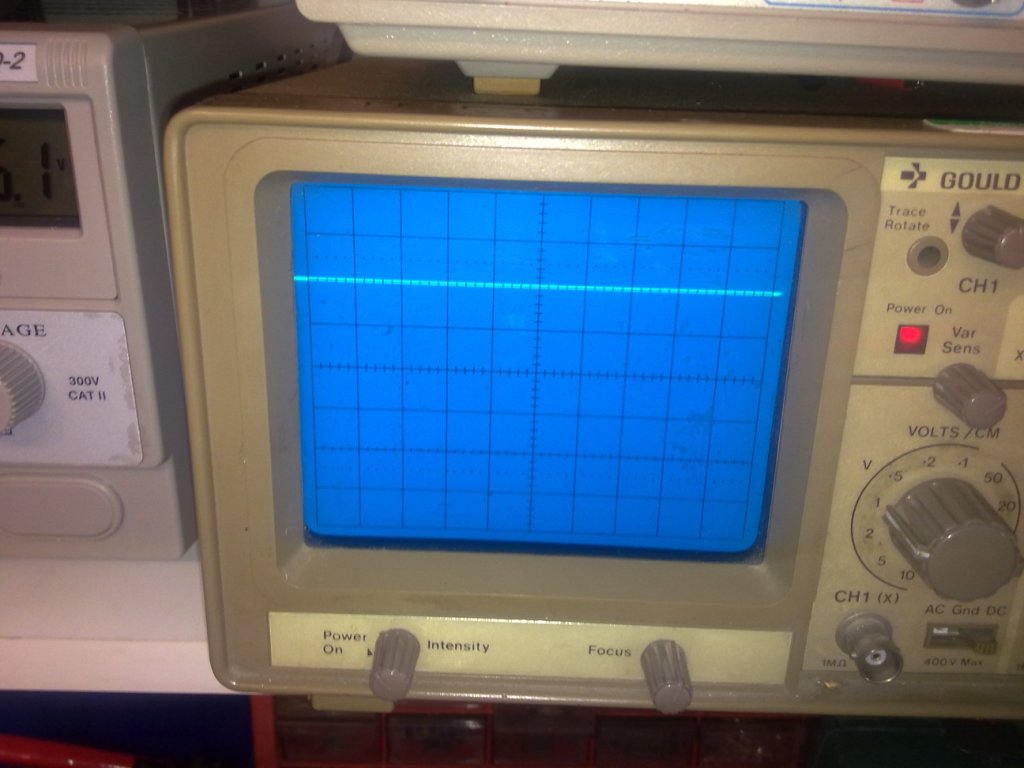

        I received the IC's, but i found the problem. Now i have another problem, this time with the VCO. I try the pcb without the SCL007. I connect the pin1..8 of the AD557 to +5V, and i short the R6. Pin 14-15 of DAC has 2.5V and the pin 16 has 3.2V.
        I take good waveforms at Pin 2 and Pin 3 of the LM393 but no out at pin1. I measure DC voltage at pin1 and it is 0.1V. I attach the wave forms from pin3 and Pin2. At Pin 2 the voltage is 4V and at pin3 the triagle if from 3 to 4.8v. Transistors are OK, LM393 is OK (i replaced it 5 times with new)...., so Where is the Problem???
        Any Idea!!!!

            Hi Chris.
            I tried with potentiometer 5K at R6. I had the biger wave at pin3 with R6 short. With R6=5K i have nothing at Pin3.
            U3 is not hot. I measured pin1 with all components near it but i did not find any sort to anyone.
            Tention of Pin2 is not more than Pin3. Pin2 is 4v and pin3 start from 3 and goes to 4.8. So there is some time from 4 to 4.8v where the tention at pin 1 must be "on". I afraid that the tentions are big, so the comparator is "on" at saturation. Who is your opinion??
            When the inputs of the DAC are to 0 then the tention at pin16 is low and i have output at pin1 (low frequency).
            I am very confused now

                Hi Chris.
                I will make the tests on afternoom.
                But the strange is other. I have at the inputs 2 and 3 of the comparator the exactly voltage references and waveforms as Carl says at his article. Why i have not signal at the output????? The case that i have exactly the voltages and waveforms as Carl says, means that all in the rear of the comparator work fine. I am afraid that at the limit the VCO don't work. I willl try it with Dac output at 1.3V or 0.7V.
                I will write again later

                    Hi Chris.
                    I found the problem but i am afraid that this VCO has big problem.
                    What is happening...
                    1. with R6=0 then with Dac out =0,01V i have about 60Hz.
                    2.with R6=0 then with Dac out =1.9V i have about 1800Hz
                    3.with R6=0 then with Dac out =2.5V No out.
                    If i will change the R5 (lower price) then i can do the Ic3a to give out with 2.5 v Dac out.
                    General if the voltage at pin_16 of DAC is bigger than 3.0v, then IC3a don't give signal at pin1.
                    4. With R6 =1K and DAC out =0.01V i have about 40Hz.
                    5. With R6=5K and DAC out =0.01V i have about 25Hz (not 5Hz who says Carl.)
                    6. With R6=5K and DAC out =1.9V i have not out at IC3a Pin1
                    In general worlds i see that this VCO is a 2 "speed" VCO. You can't make it with a fix resistance in the position of R6, to work from 5...10 Hz to about 2Khz. If i have the R6=5K so to have low frequency at small signal, then when i will receive a strong signal it will stop to Beep.
                    So i will try to change it. I want to connect a 4046 VCO. The main problem is that it begins to work with min signal in =1.4V about. We have at pin16 min voltage=0.8V and max =3V (with r6 near to 0V). So i need a simple circuit to add the 0.8v from pin 16 with a 0.6v from the power supply and to give me a 1.4v min.
                    Have you something ready???
