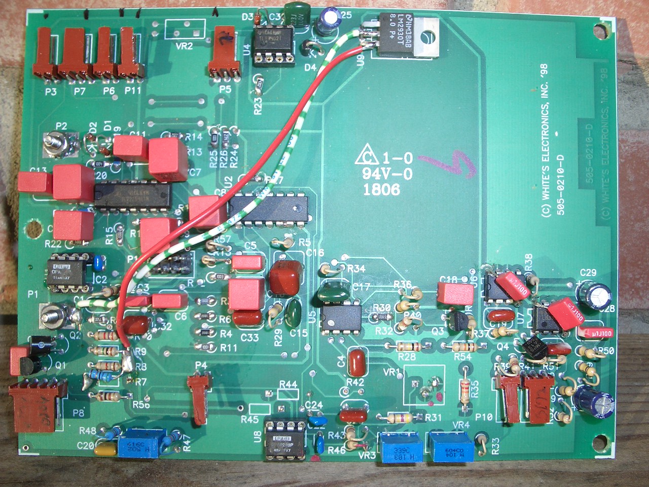

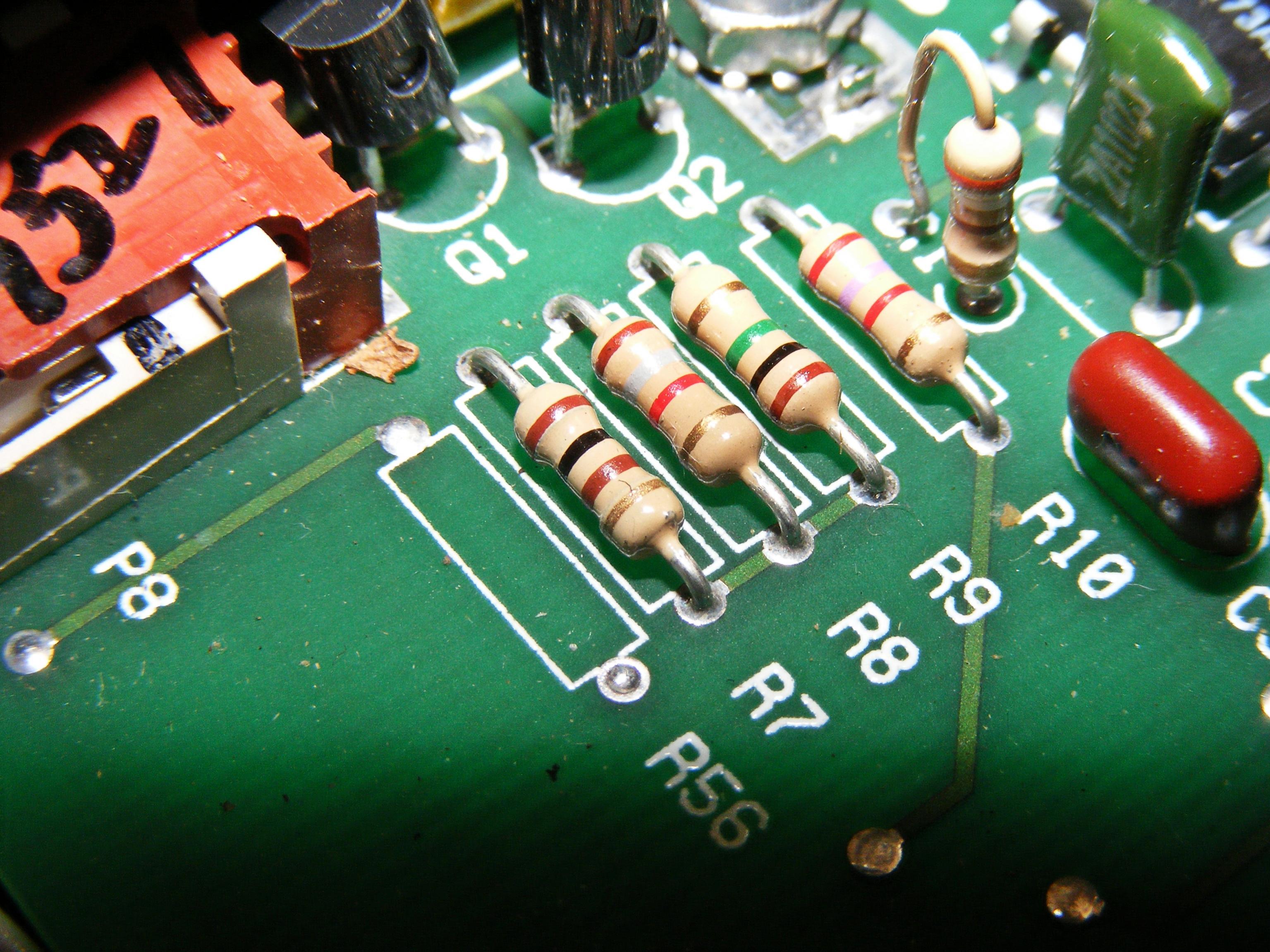

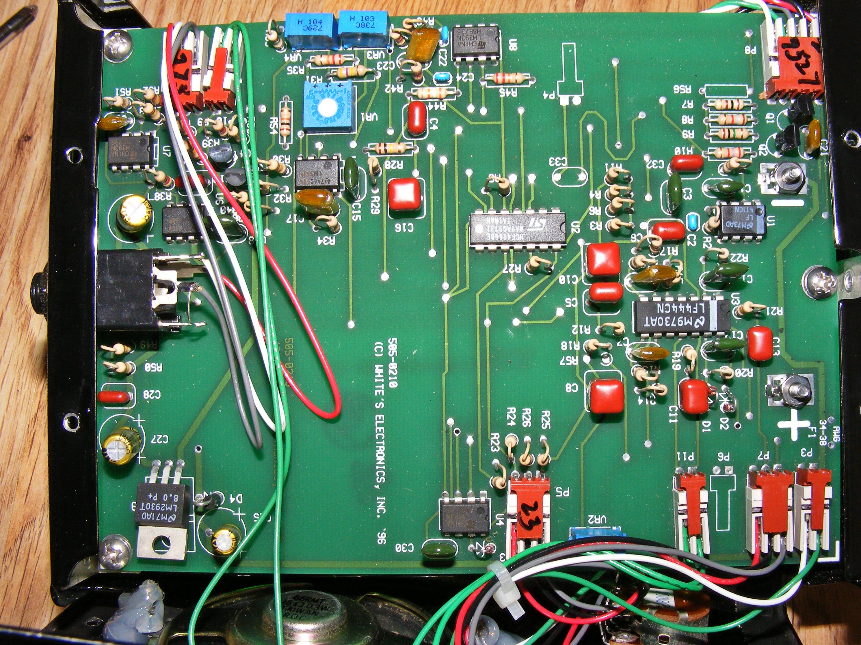

        • Hi guys.
          i own a White's Classic SL and would like to do MR Bills Mod to it. i am useless when it comes to what resister value is what etc. i have dyslexia. i was looking at the instructions at the beginning of this thread and was wondering about a few things........
          (1) Replace resistor R24 with a 2.2 Meg. You could have either a 470k or a 1.5 Meg there depending on when the unit was manufactured.
          i am not sure what those resisters values mean.
          my machine has 1998 under the battery flap.
          (2) Check resistor R7. If it’s not a 51 ohm resistor, replace it with one of that value. It’s most likely a 100 ohm from factory. Later manufactured units had 51 ohms.
          how do i know if the R7 resistor on my board is 51 ohm one or not.
          (3)same goes for the R32 SAT replacement. what resistor values do i need.
          my soldering skills are ok. i have done a fare bit of solder to this and that in the past. i have modified a minlab explorer before on to a straight shaft. but as i say resisters etc are just not my thing.
          if anyone could be as so kind as to show me/point me in the right direction as to the components that i need it would be so much appreciated.
          i have taken some photos of the board.
          many thanks in advance.

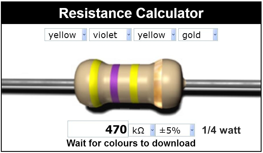

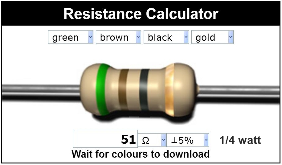

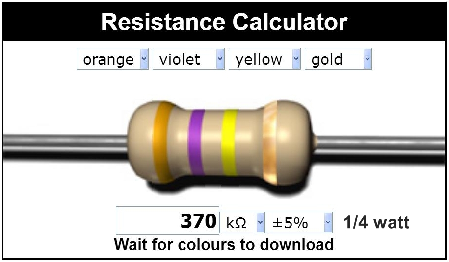

          • R7 is 100 ohm 5%.
            check this link for an easy tool : http://www.talkingelectronics.com/Fr...alculator.html
            • Hi again guys.
              thanks a lot Dutchie for that link. much appreciated....

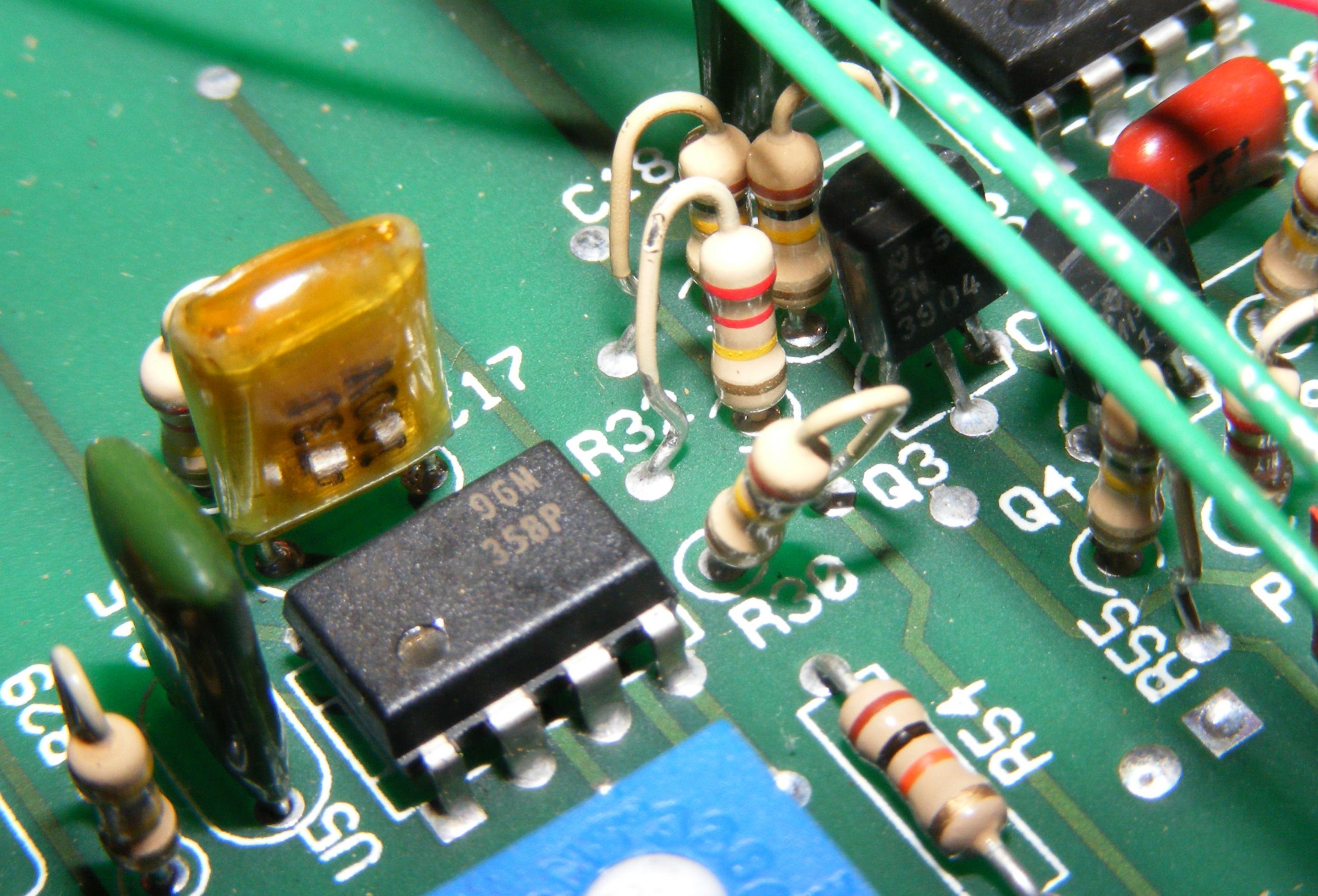

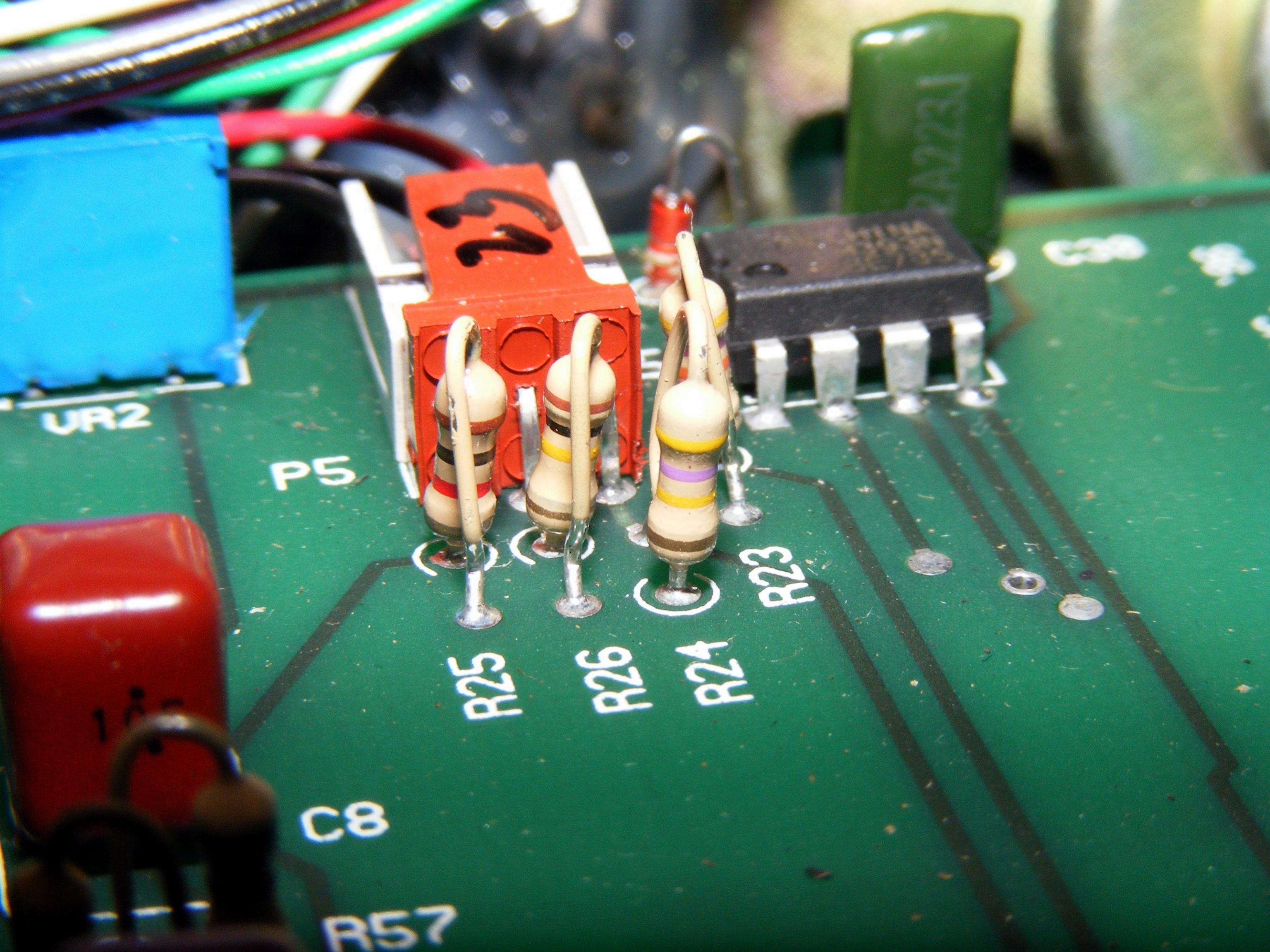

              please could anyone tell me if i have these resistors correct for the one's to change in the instructions.
              thanks in advance guys.
              • R7 is 100 ohm on your board.
                We can't see the color bands on R24 & R32, you have to take new picture.
                • chevesne here you go.....

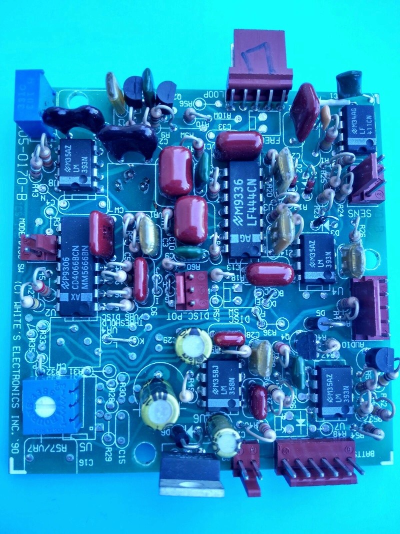

                      • Originally posted by keith777 View Post
                        i am very sorry Kt315 but most of what you have just said. i didn't make much sense of.
                        ok. no sense? i give you the pic and EVERY smd component on this board is a MOD. you see yourself my prioritet. NO BILL HERE.
                        • the board that you have just showing me. what do all them mods do to the machine? Yes there is No MR Bill there.
                            You have 470K for R24, and 220K for R32.

                              • Originally posted by chevesne View Post
                                thanks chevesne
                                so it looks like i only need to replace resistors R7 and R32 am i correct? plus and the potentiometers.
