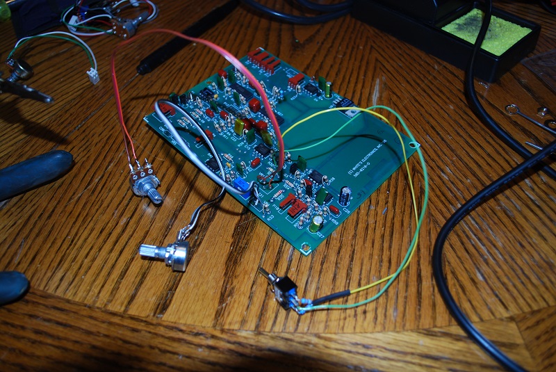

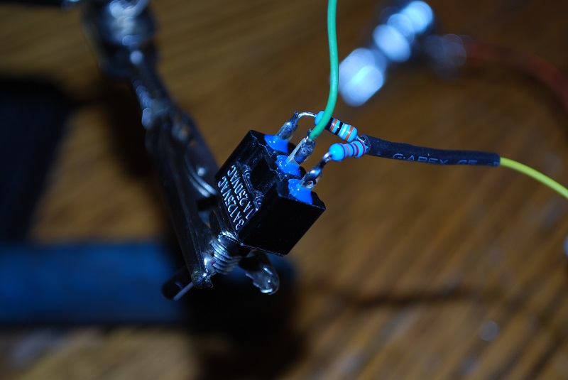

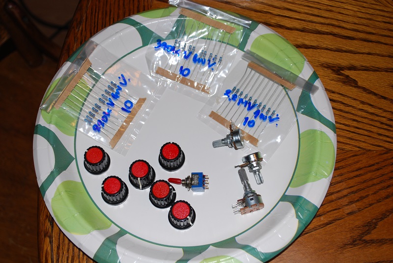

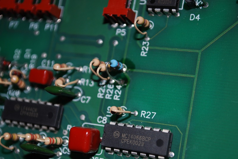

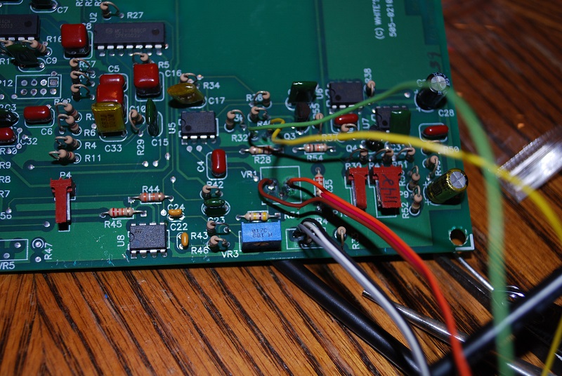

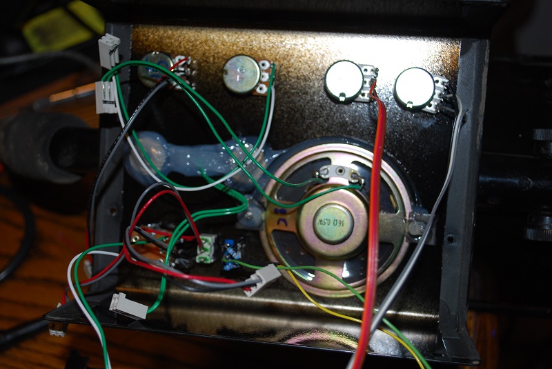

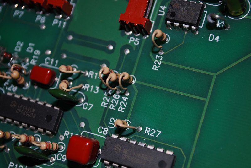

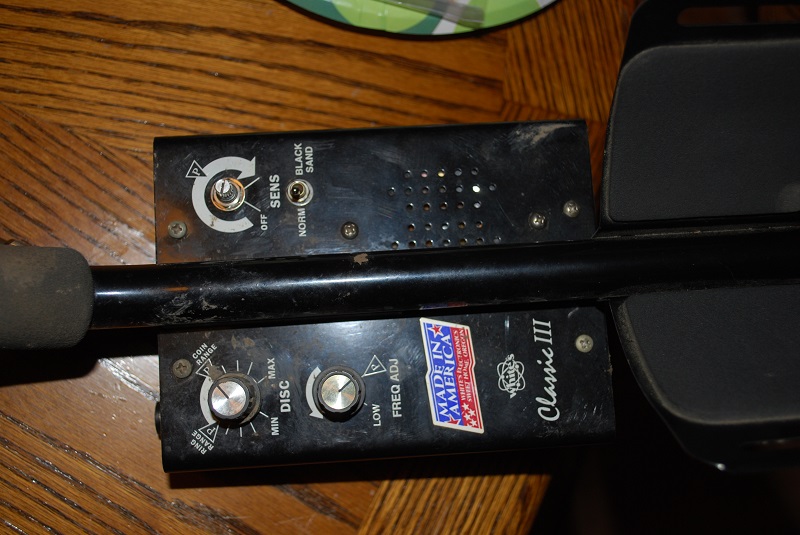

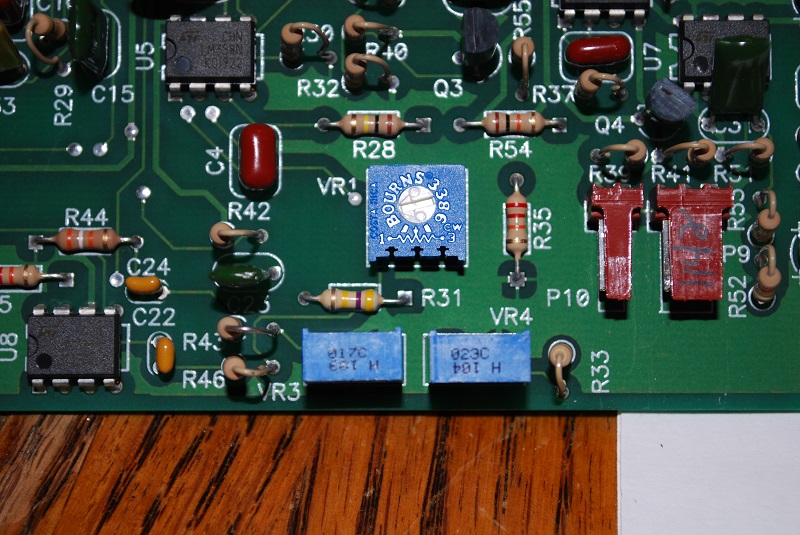

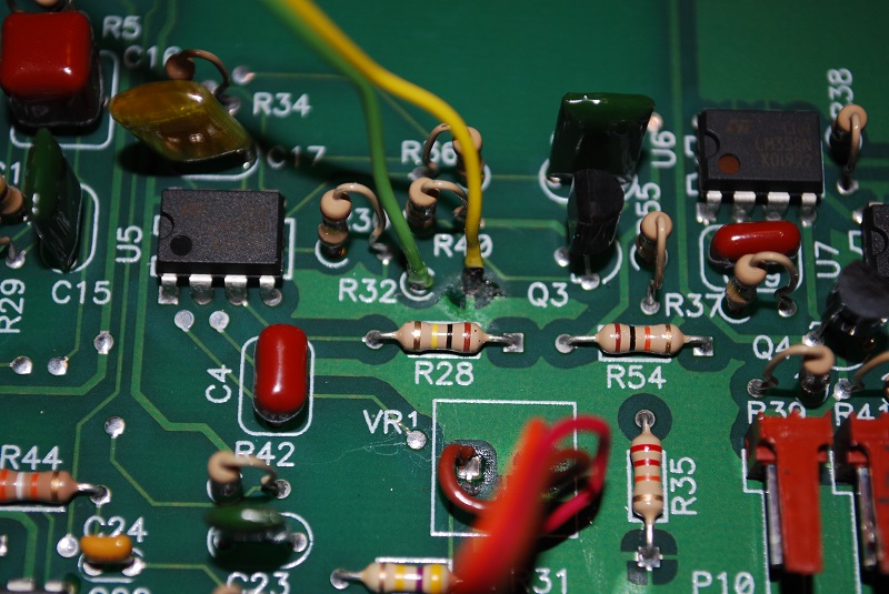

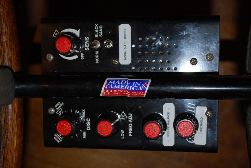

    you dont need the pictures really all the components are numbered on the board and the pictures you need are all ready on the the forum i did the mod with the numbers and then found the pictures
      I just finished it and it works great! Thanks Mr.Bill for all the help and info. I'm a complete rookie at this stuff but with all the help from reading on this forum I was able to get it done.
      Thanks again to all,
      Coin

        Missed one pic!!!

            Did you just use a normal drill for the knob holes?
            Rich
              Yep, But I used a step bit.
                three months ago I picked up a Classic SL/ID up at a local pawn shop, then found a Mr. Bill modded IDX-Pro on craigslist. So now I'm in the process of modding my Classic. I've done the pots, now need to do the resistors.
                  Oh yeah, what is S.A.T.?
                    nevermind... :-)
                      So what exactly is the "boost circuit" Bill advertised? I understand the external GB and Threshold and all, but is the replacement of a couple resistor values the extent of the work needed along with the addition of a couple pots?

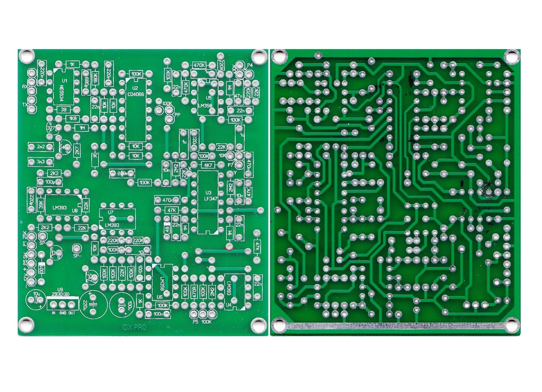

                          Can anyone upload PCB for IDX-PRO SMD.

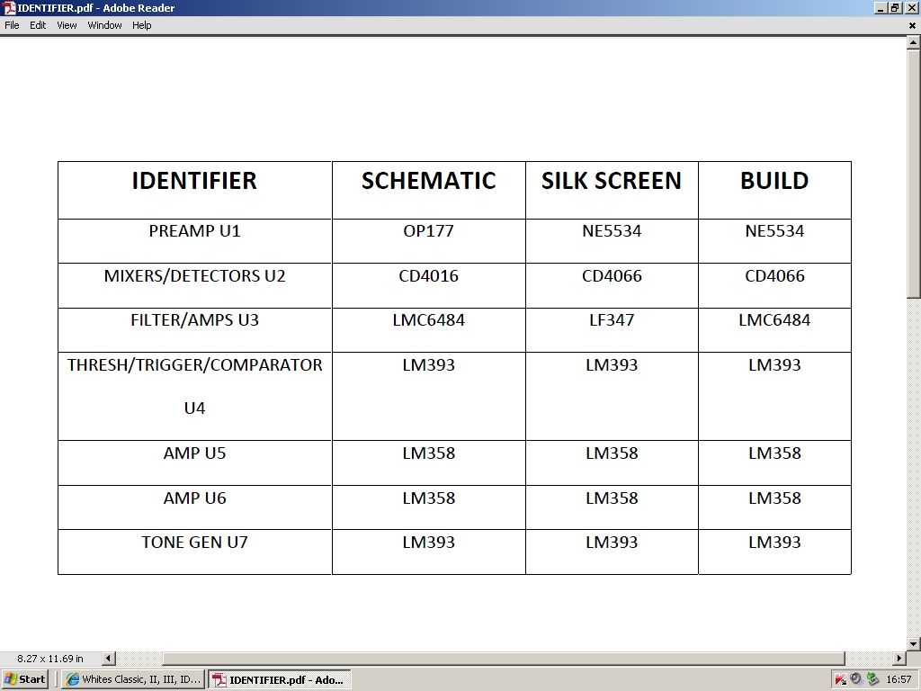

                                Some of these kits, the pcb, the parts, the silkscreen dont correlate perfectly.
                                Here is a look at IDX and what I built.
Name:	IDX IDENTIFIERS.jpg
