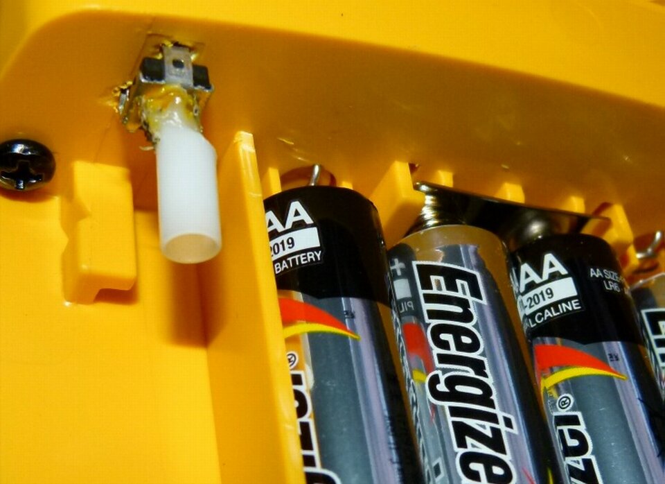

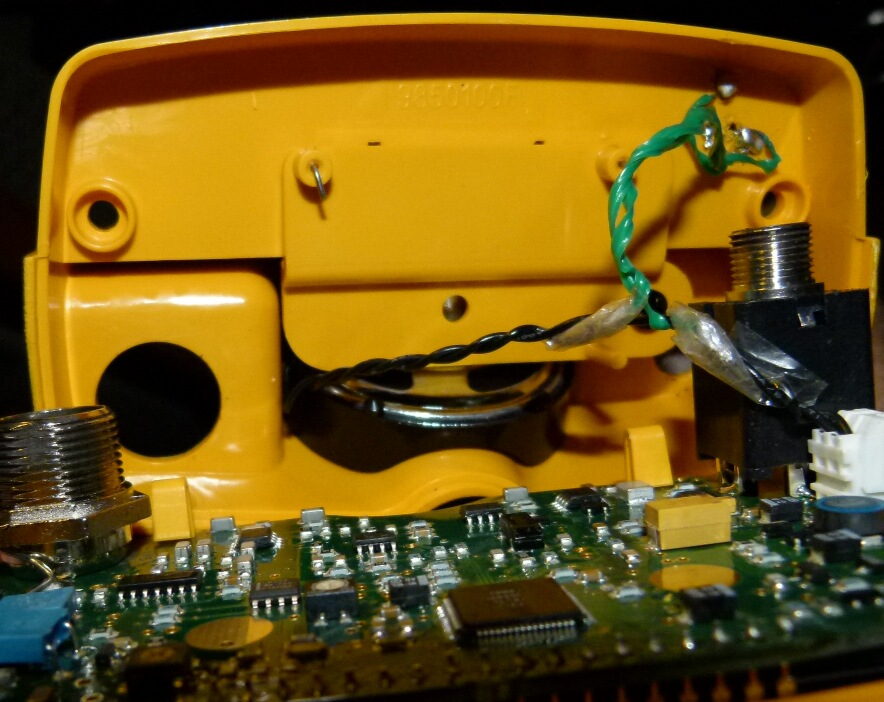

    Modifying the EuroAce to get speakers volume control is pretty simple:
    Needed parts:
    variable resistor with values from ca. 100 - 2000 Ohms
    2 wires, 10cm (4'')
    soldering iron and tin
    what to do:
    : unscrew coil-cable-connector, phone-plug and the both black screws
    : remove LCD panel unit that also contains the PCB
    : cut just one of the speaker cables, solder wires and isolate
    : melt 3 tiny holes through plastic near batteries (see below)
    : insert small variable resistor there
    : solder the ends of the both cables to the resistor pins
    (1: one of the 2 pins nearby; 2: the single pin opposite)
    : melt or superglue small plastic piece carefully to the resistor so you
    don't have to use a screwdriver each time to adjust the volume
    : check out that the new cable uses a free room inside the case
    : close cover and attach screws as they were before
    Good Luck!
    Note 1: This mod only affects the speakers volume.
    If you want adjustable headphonevolume use one like
    of those new ones that comes with the Garrett Euro-ACE.
    Note 2: Depending on the variable resistor you are using
    expect a slightly weaker volume on full as it is in orignial.
    Those resistors have minimum restiances from 10 to 50 Ohms
    depending on the model so volume will be slighly lower than
    without the variable resistor - but it doesn't matter much.
    Note 3: After mod. always open & close batterycase-cover
    carefully by sliding horizontally or you may rip off the knob
    or even damage the variable resistor.

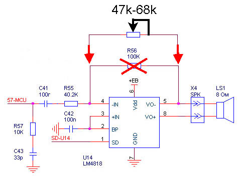

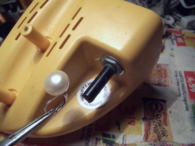

                you are interesting man. why you are so distrustful? nothing to blow out. my mod was been tested in REAL HUNTING AT FIELD. I write only I did by my hands about.
                  distrustful? Its obvious that your knowledge is limited however someone one said please don't confuse me with the facts I've already made up my mind. Just trying to help, Best Wishes

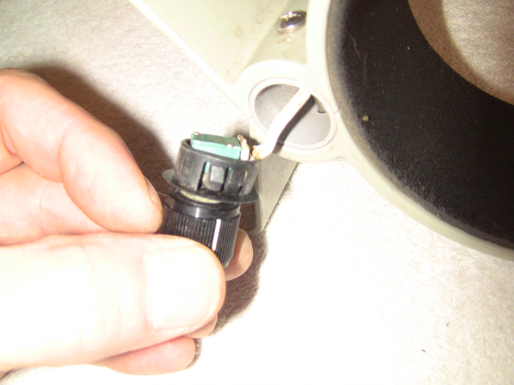

                    thank you TV Repair Guy. its obvious your help is appreciated. made an especial photo. hh Click image for larger version
                      @ kt315
                      Shure your solution works, nothing unusual there, as long as the involved parts
                      can handle the bypassing input. This way you can select a better volume range.
                      Another thing is the question: is it worth the more complexity at all?
                      For people who need the most possible loud volume output - yes
                      for most of the not expert mod interested ones - no
                      You may show us a little picture of the PCB how and where you have
                      soldered the contacts for the potentiometer.
                      btw. seems you have sacrificed your headphone-socket for the potentiometer...
                      @ TV Repair guy
                      What are ya talking about " (y)our knowledge is limited "?
                      If you have problems with such simple electronical solutions what are you doing when real problems occurs?
                      The expenditure to modify the PCBs amp-circuit for directly volume-tuning is far to high and risky
                      compared with my simple and therefore effective and great "mod to go" solution!
                      If you wanna dim the light in your living room do you use a variable resistor with triac diodes (dimmer) directly
                      before your lamp or do you call the electricity provider it should serve just 50 Volts instead of 230?
                      Sorry mate, but better criticize such things if you have real good arguments and if you can explain them
                      correctly and well understandable for everyone. We have had already enough persons who wanna make
                      everyone believe there fancy Long Range circuits or devices are real working etc.
                      The only problem that could occur with the by me described methodic is that the resistor or the poti
                      can burn if the volume power has really a huge amount of watts: don't use a 0.25 watt variable resistor
                      to regulate the P.A. of a Rock'n Roll concert that way!

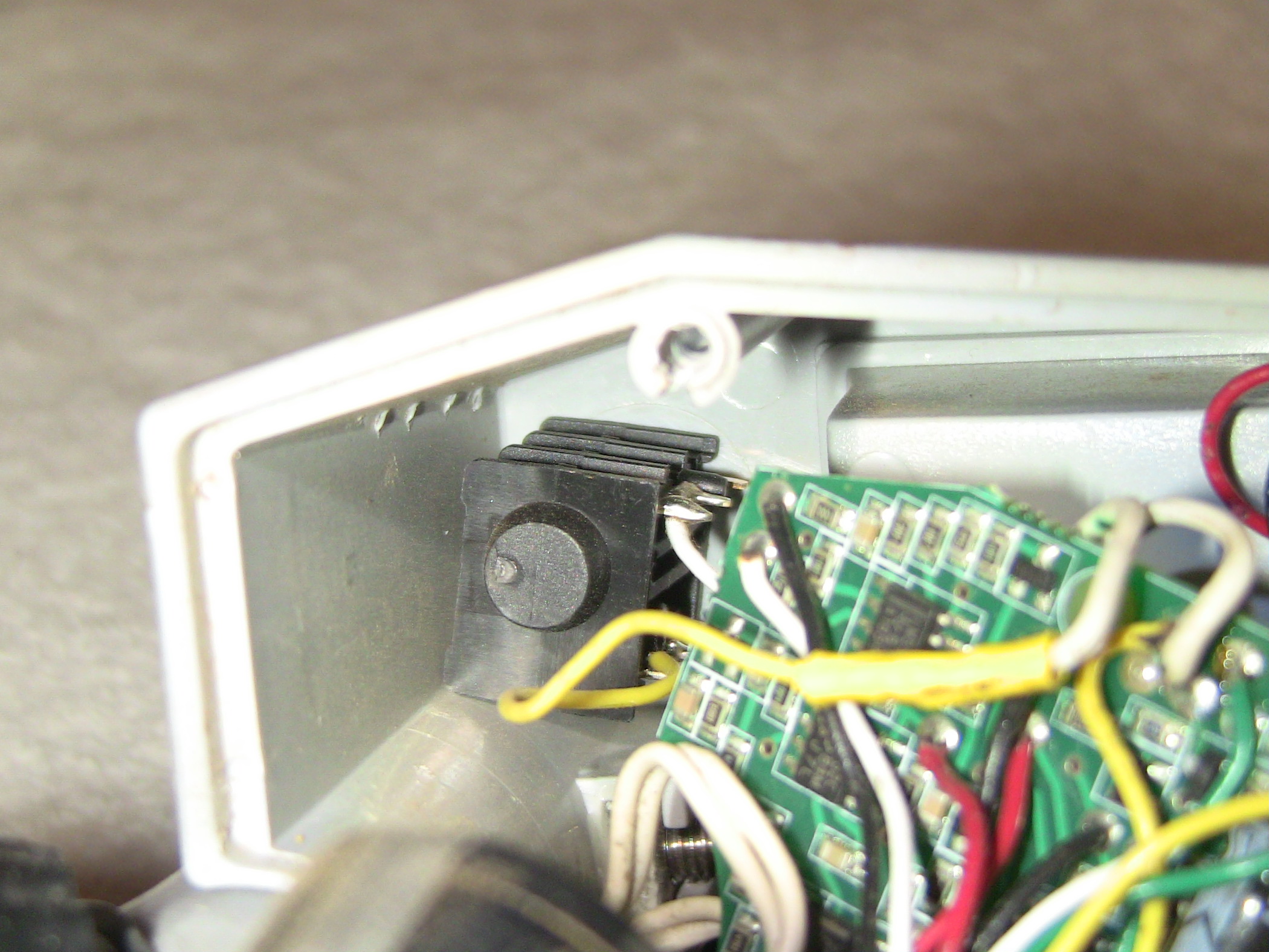

                          The method that I used to install a volume control in my Cibola was to tap the audio output before the headphone jack by removing the yellow wire from the PCB and connecting a very small dual (stereo) 10K pot, paralleled to increase current capacity and lower resistance. I couldn't come up with any other logical places to locate it besides the butt of the shaft. (5K may not be ideal but it was handy in my junk pile) Obviously wired in series before the HP jack. As long as the audio amplifier sees MORE (or equal) resistance than the speaker, there won't be any problem. Having audio taper would be better but this has been working fine for over a year.
                          Cheers!
