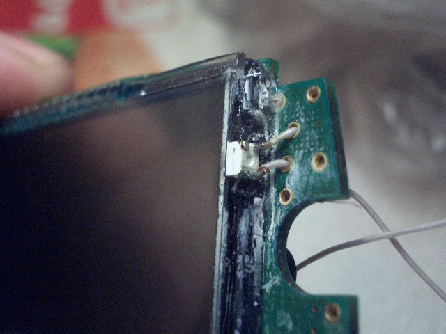

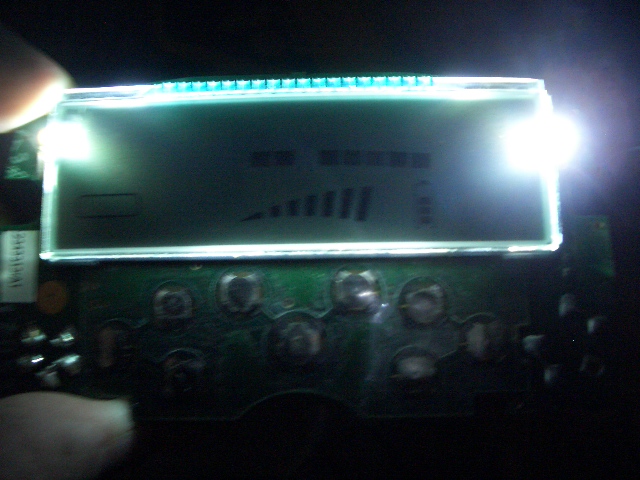

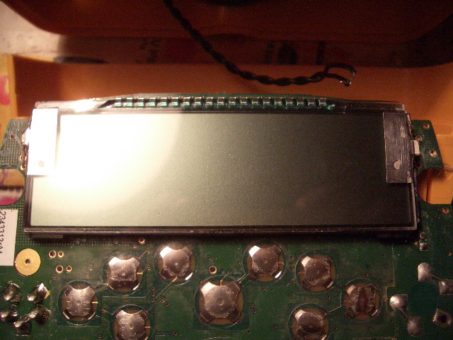

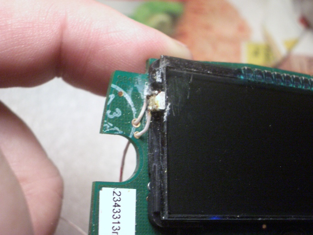

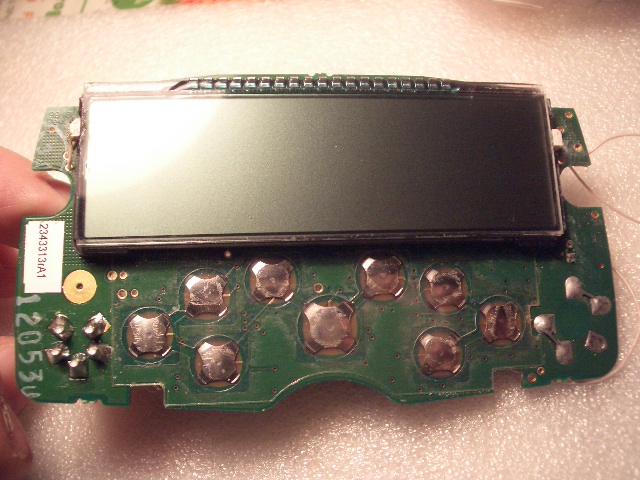

      follow mod - LED brightened LCD. take the idea.

          This LED-mod is a real good job and nice inspiration.
          Of course I suggest to attach a little push on-off switch.
          kt315 you may open an extra thread for that display-modification.
          btw. I'm planing to make the Garrett Pro Pointer LED on-off switchable.

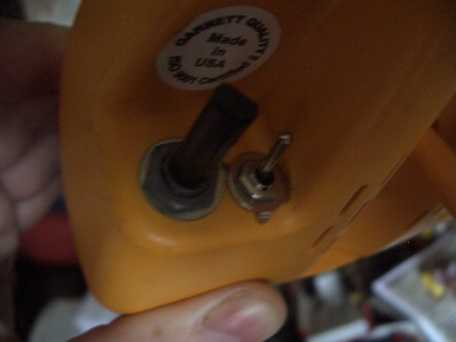

            I do not see a reason to open new thread. here - the sound level pot and the mini switch for LEDs on back side. Click image for larger version

              Other people should find those mods - hopefully with the search function
              or by renaming the title. Easier if the title describes the full content or
              a thread contains not multiple mods.
              btw. usual only Garrett GTI 2500, 1500 and GTP 1350 have LCD with backlight.
              And as a refinement of your mod there would be the possiblility to adjust the brightness,
              especially if you're using one of those ultra bright LEDs. And another very good idea:
              One switchable ultrabright LED on the front of the ACEs nose for
              having an integrated little flashlight for nighthunting-sessions.
