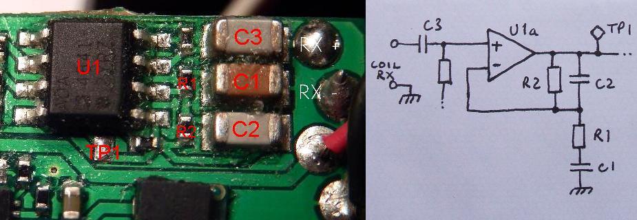

              I still think there is some gain changes worth trying on the circuit-board. With this PCB being designed for a large coil, it possibly has a lower amplifier gain to match.

                    • Yes, but don't forget, almost every other machine out there has no idea what size coil is stuck on it, and they don't misbehave as a result. The most likely thing that is different between the different coils is the gain of the amplifier - lower for a big coil, higher for a smaller one, at a guess.

                                Regarding your RX coil pre-amp. Here is the circuit diagram. To increase the gain, your two obvious choices are (1) decrease R1; (2) Increase R2. You have to keep the time constants R1*C1, and R2*C2 the SAME. So one obvious solution is to halve R1 (add another R in parallel with it) and double C1 (another one on top of it). R1 is likely to be 47 - 100 Ohms, C1 probably 470nF. R2 is going to be 10 - 50 times larger, I should think. Doubling gain will give +14% air-depth, roughly. With your null not being super, any more gain may possibly cause problems.
