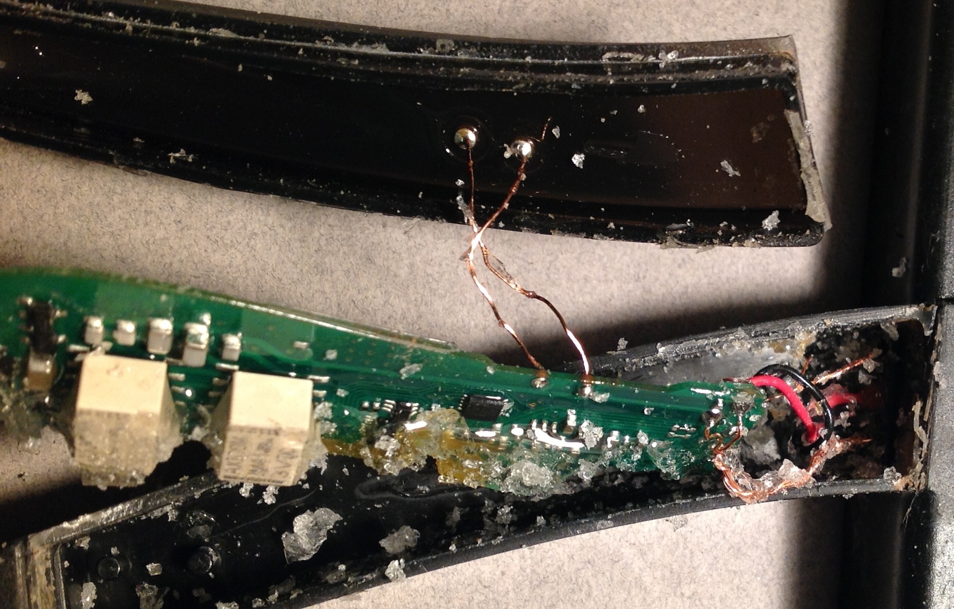

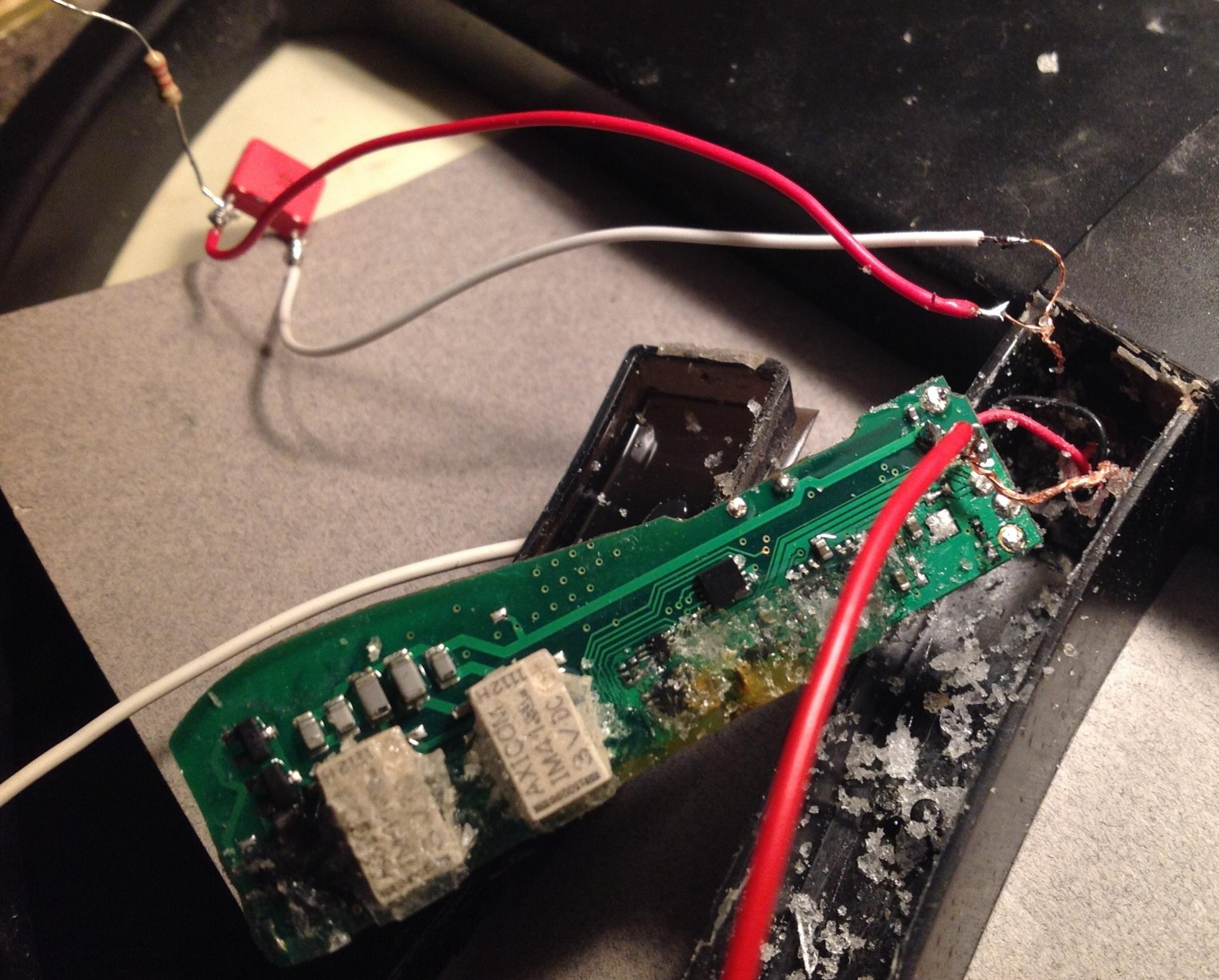

I hope some could help me with this idea.. I know that its a little crazy and exspensive.
The idea is makeing a small XP deus coil.
How ! Open up a working Deus coil and separate the electronic from the search coil RX and TX.
Deusfan.fr open one coil some years ago.. http://xpdeusfan.free.fr/deusinside/
Find the connection from the 17.6 khz RX/TX. Measure the RX / TX at the Deus coil.
Buy or make a 17-18 khz small coil, like the XP Goldmaxx 5x10" or SEF 5x8" or similar...there is close to same mH and resonans Freq. Maybee fine tune with a small capacity (18khz down to 17.6 khz)
Use coil cable and put the electronic in a small plastic box up at the stem close to the handle.
What would you experts think of this idea.. Could this work, If a small coil could Be found or maked.
