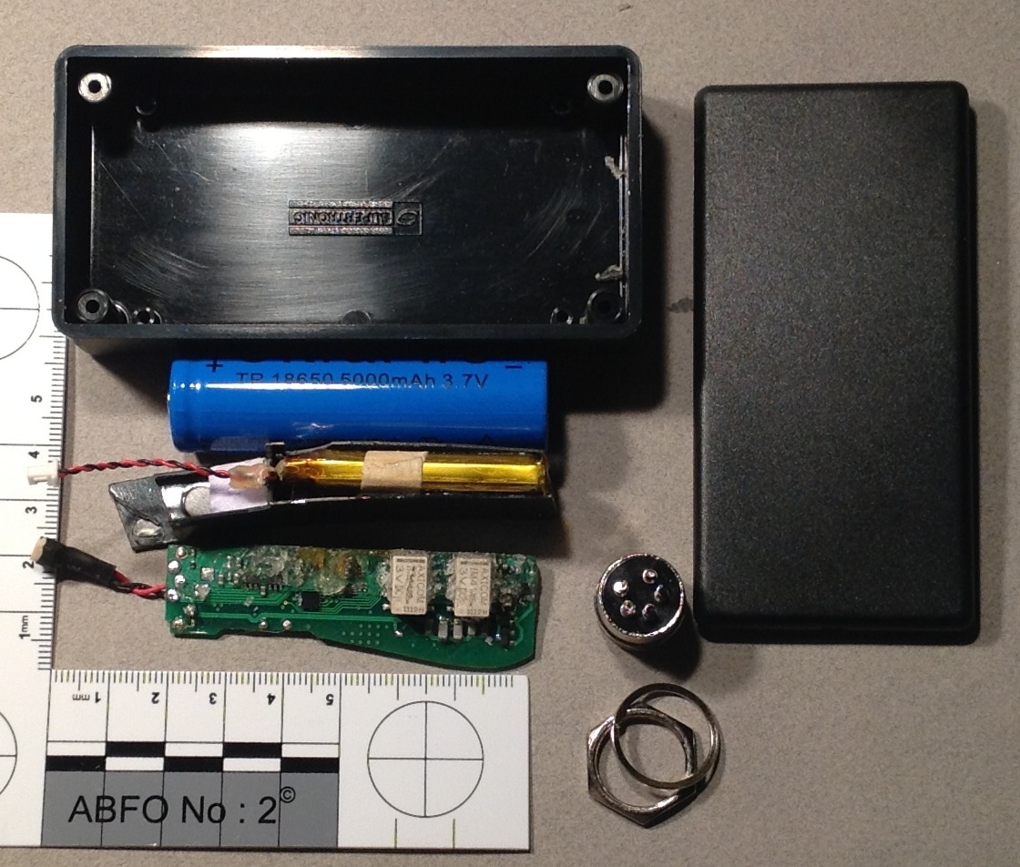

            One idea, if you're fitting the electronics in a new box, is to replace the foil-pouch LiPo cell with a larger capacity better quality one, like a 18650 LiIon cylindrical type.

                Skippy- Good idea with the 18650 cell. But I'm not sure that one them will give longer time. (18650 = 3-3500 ma best ). test needed.

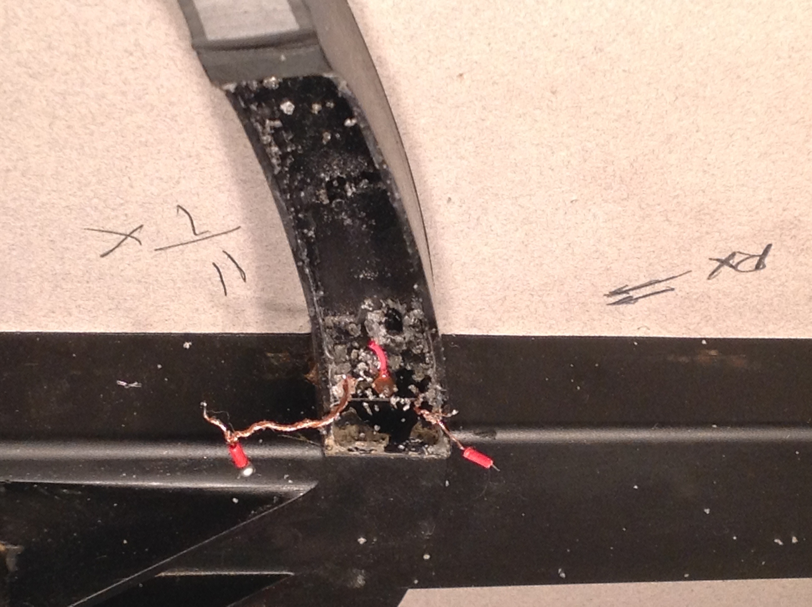

                To you all.. Okay making my own small coil is the way I go. Because I didn't damage the XP coil, and still got the cobber wires TX and RX to connect a cable, I could start with a cable at the XP coil, and see the project works. I still got my own 11x13" Deus coil to test how much lose I got.
                I got one Questions ! There is no wire to the Shielding coming out to the board !! I can see that the ground at the board is connected to the cold side of the TX.. Is this a good idea, be the shield connecting at the Coil cable ? I think I saw this Once before. !

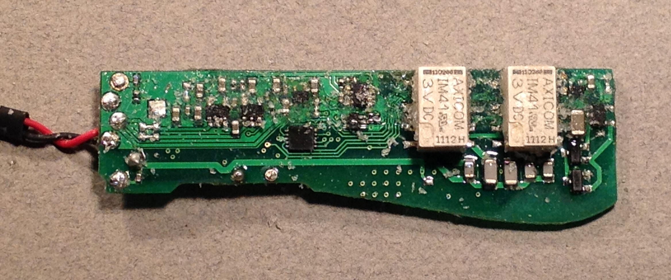

                    Hi - a few questions/observations for you..
                    Was this one working OK?
                    If yes, i would scope the Tx drive and the Rx amplitude and phase so you have a reference to aim for.
                    Also
                    Consider the screen options and connection point for your modified version..
                    The suggestion in discussion is that the relays are switching caps in for various frequencies - what I find hard to believe is, these relays take about 200mW - so say in lowest freq - all caps in - both relays ON thats almost 1/2Watt - this doesnt add up to me.
                    Could someone confirm if audible click occurs on freq change?
                    I suppose the relays could be latching type with small magnets in - so pulse to toggle state - no keep alive current required??
                    The other thing that is odd, the published frequencies and freq shifts available does not sound like LC tuned Tx (as too precise published numbers) - I suspect the Tx wave is derived in SW and passed out to the drive electronics to coil.

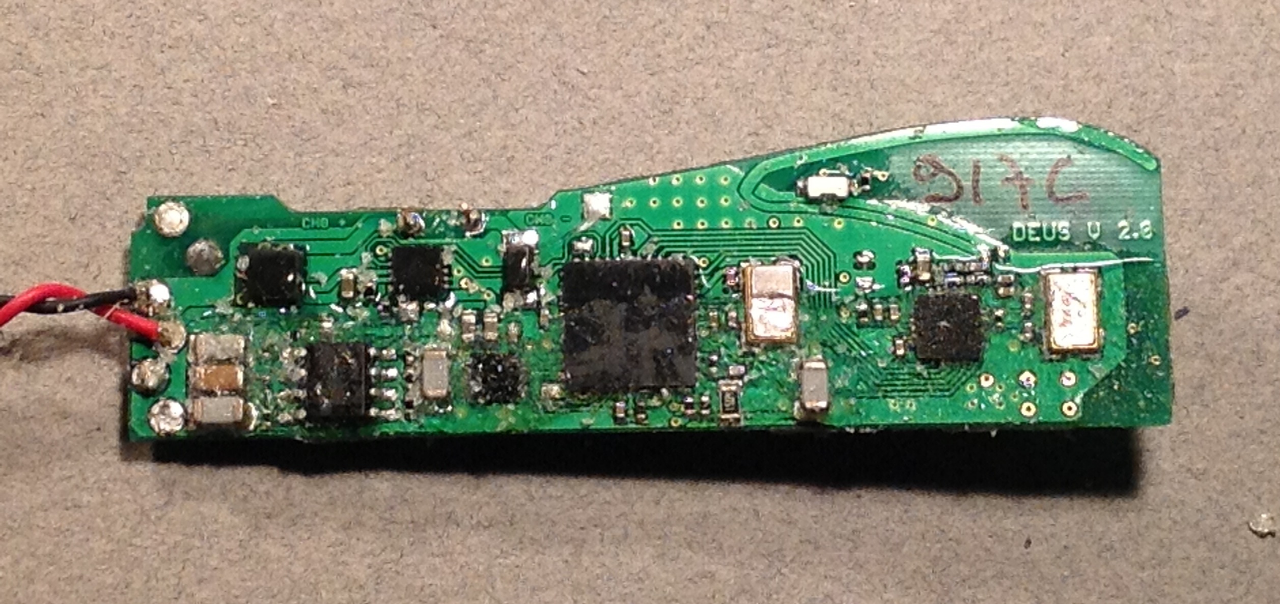

                    Can we get image of reverse side pls.

                            Relays are latching type, Axicom IM41, looking at this board picture, my best guess is, actually only TX is resonant, need to be, driven from 3.6V battery, probably series resonance, then Rx is non resonant. Making DIY coil for this seems to be relatively easy assuming some form of software implemented electronic coil balance is not used. Reducing coil diameter by half and recalculating no. of turns, total wire length, and resistance will be only some, roughly, 20% lower, I don't think this is fairly significant. Will be nice to see some scope measurements, or macro mode photos of cleaned board.

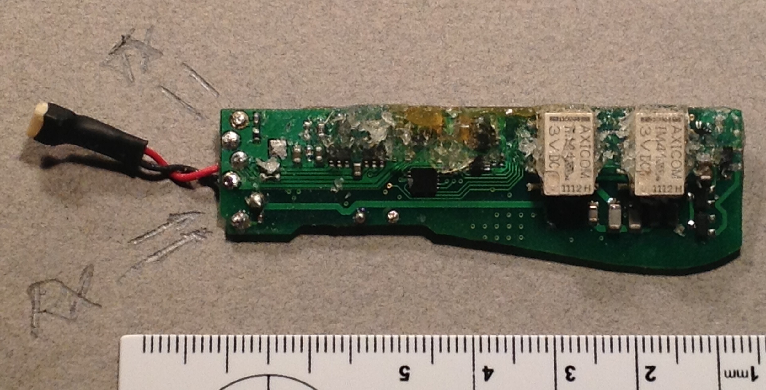

                              Picture reverse side of the board is uploaded, see down. Sorry can't remove all the silicone.

                              I can allso hear the relay's swiching, changing Freq.

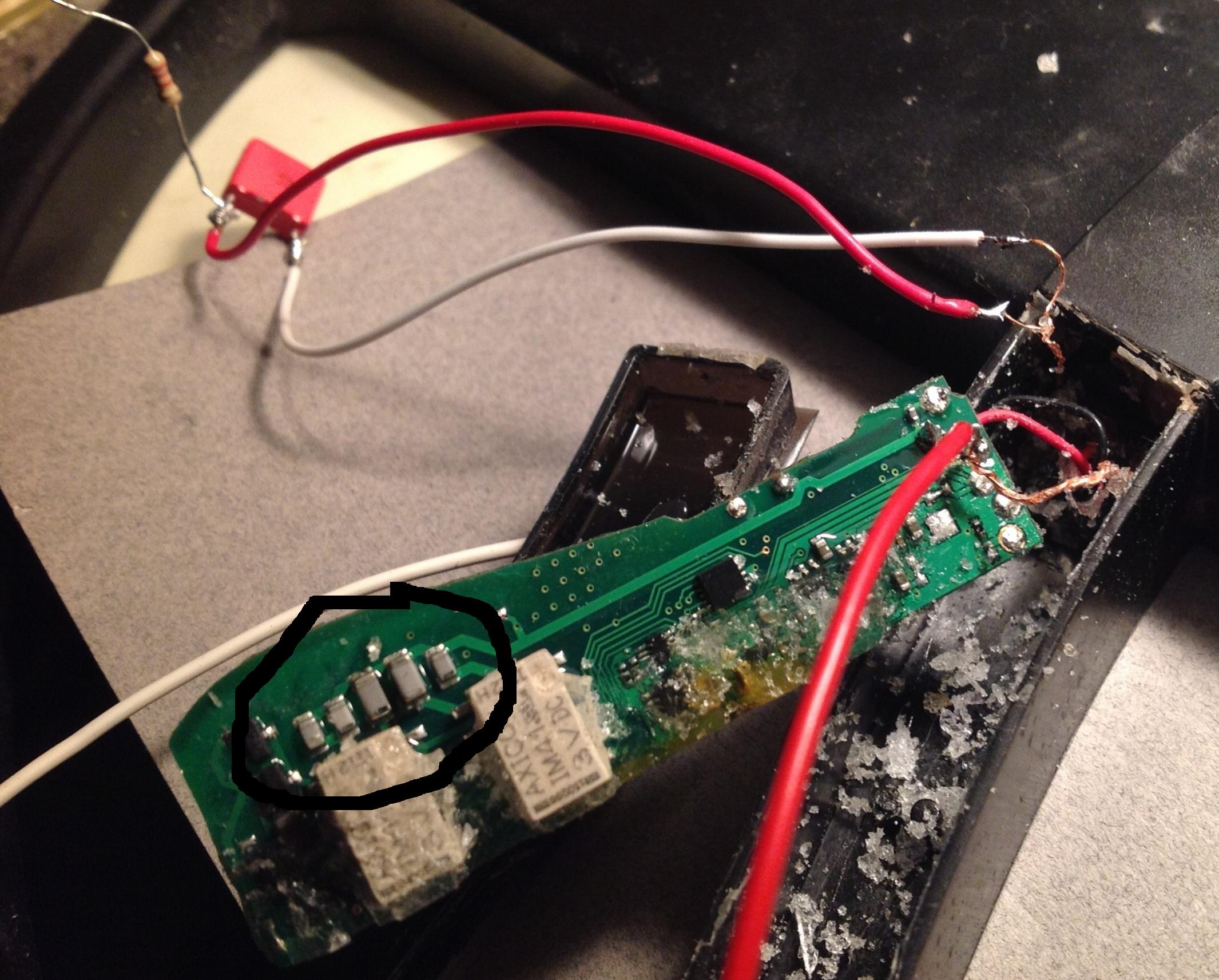

                              When I did the LC test to find resonans... First with a 6.8 NF and then a 15 NF, I noticed that the peak was lower that I'm used to working with some other VLF coils.. I was using a 2.2 Kohm in this test. I dont know what you call it, but it seem to me that the L is wide...!

                              Battery can wait.. First make this project work. But you properly right Skippy. (1000ma).
                              Next step must Be to scope this XP coil. One little problem. I removed the Battery cable, but some result should come out.
                              Step 2 is to connect a cable to the XP coil, and work with that.. Ground, shield, and learn.

                              the bigest problem would Be the shielding. This matter I had problems with before. And in this case, the XP coil dont seem to got a shielding wire connected to the board. I'm confused..
                              Henrik.
                                Probably just the receive coil is shielded, and the shield is connected to the cold end of the RX coil. It's possible the coil case is conductive, graphite loaded (could you check for resistance with a meter?), and there may be a connection to this somewhere out of sight. This would likely connect to RX ground, too. It would be interesting to see how the voltage on the TX varies with the "coil power" setting. I assume that the receive gain (software, probably) is adjusted accordingly, to give the same sensitivity, eg if TX voltage is halved (1/4 power consumption) the RX gain is doubled etc.
