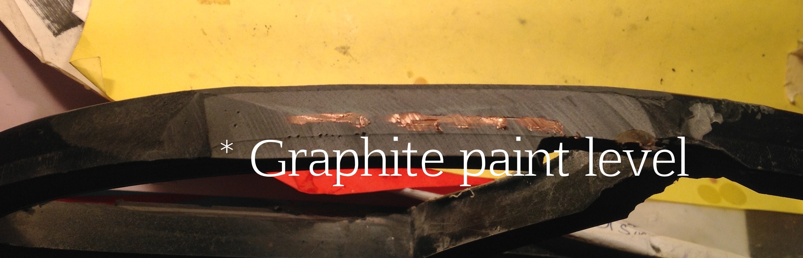

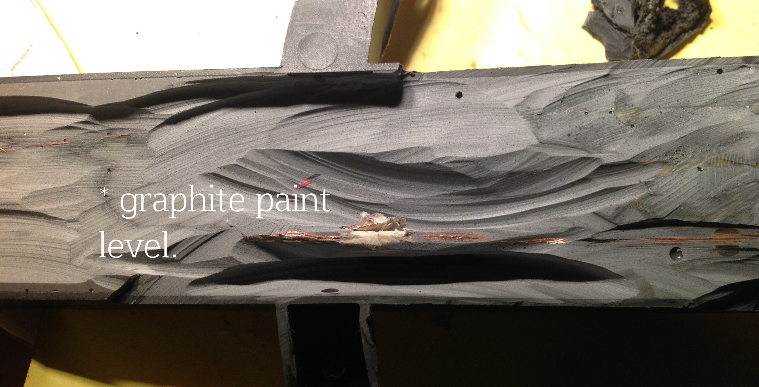

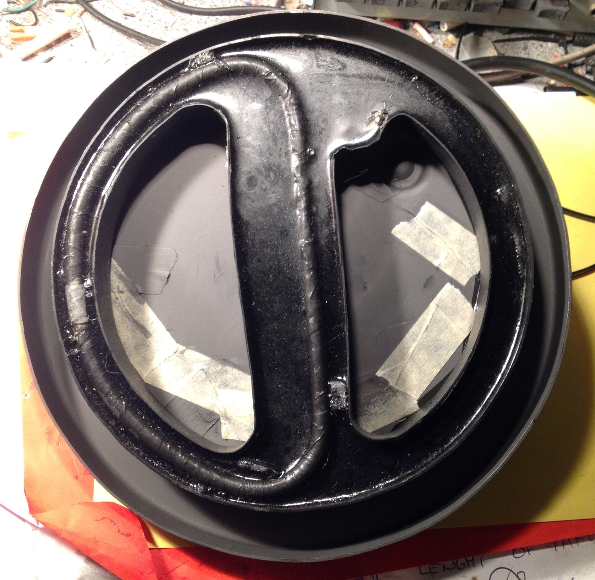

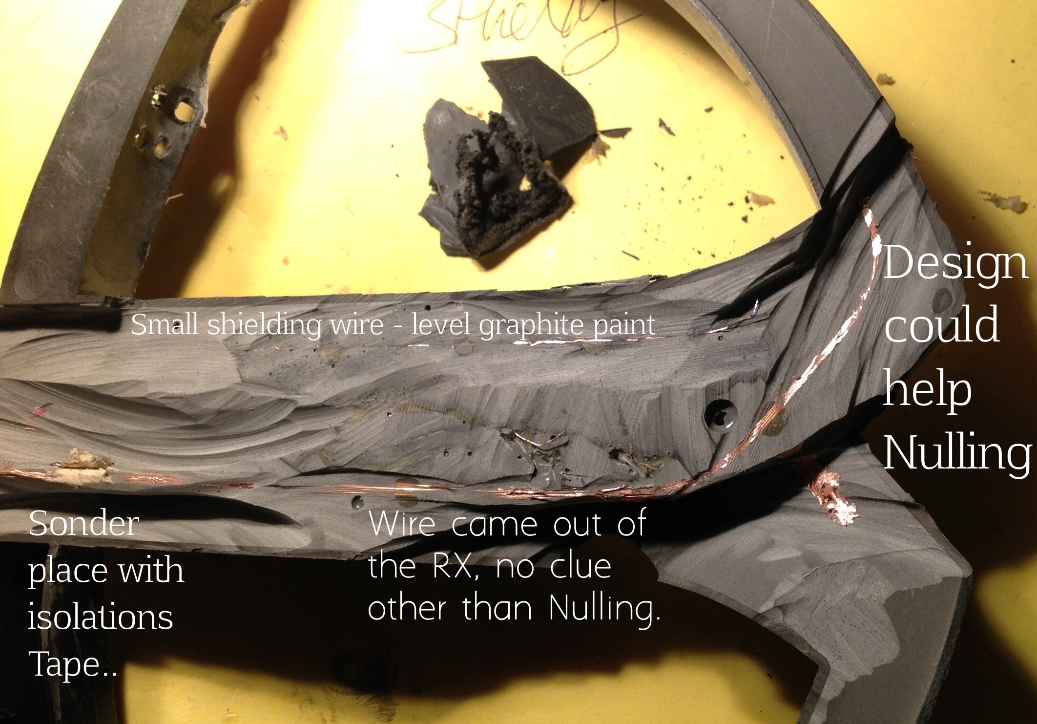

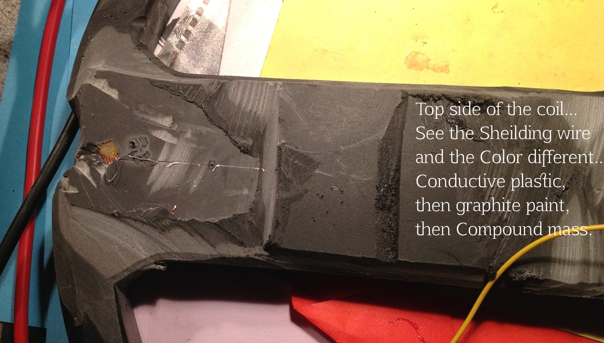

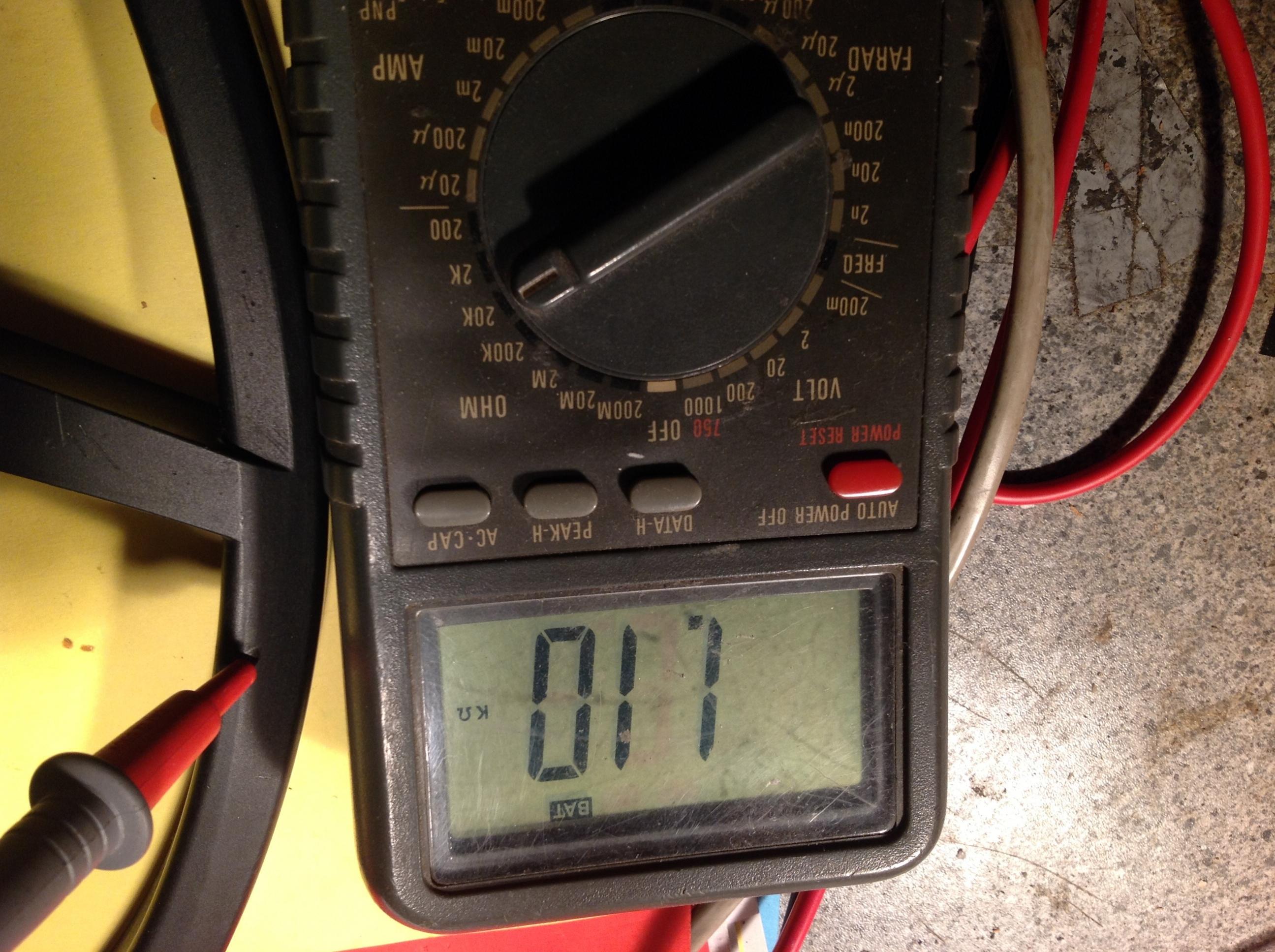

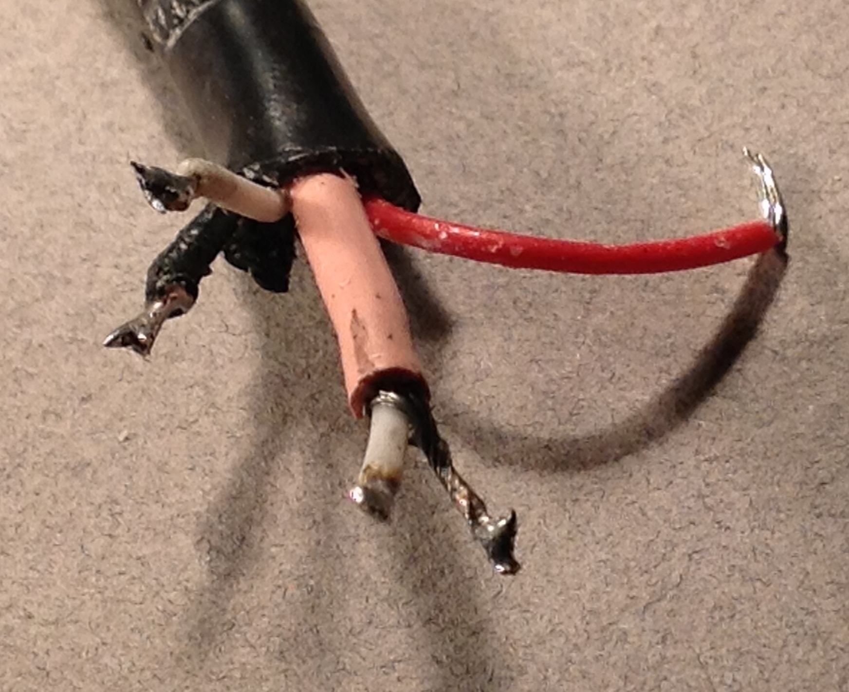

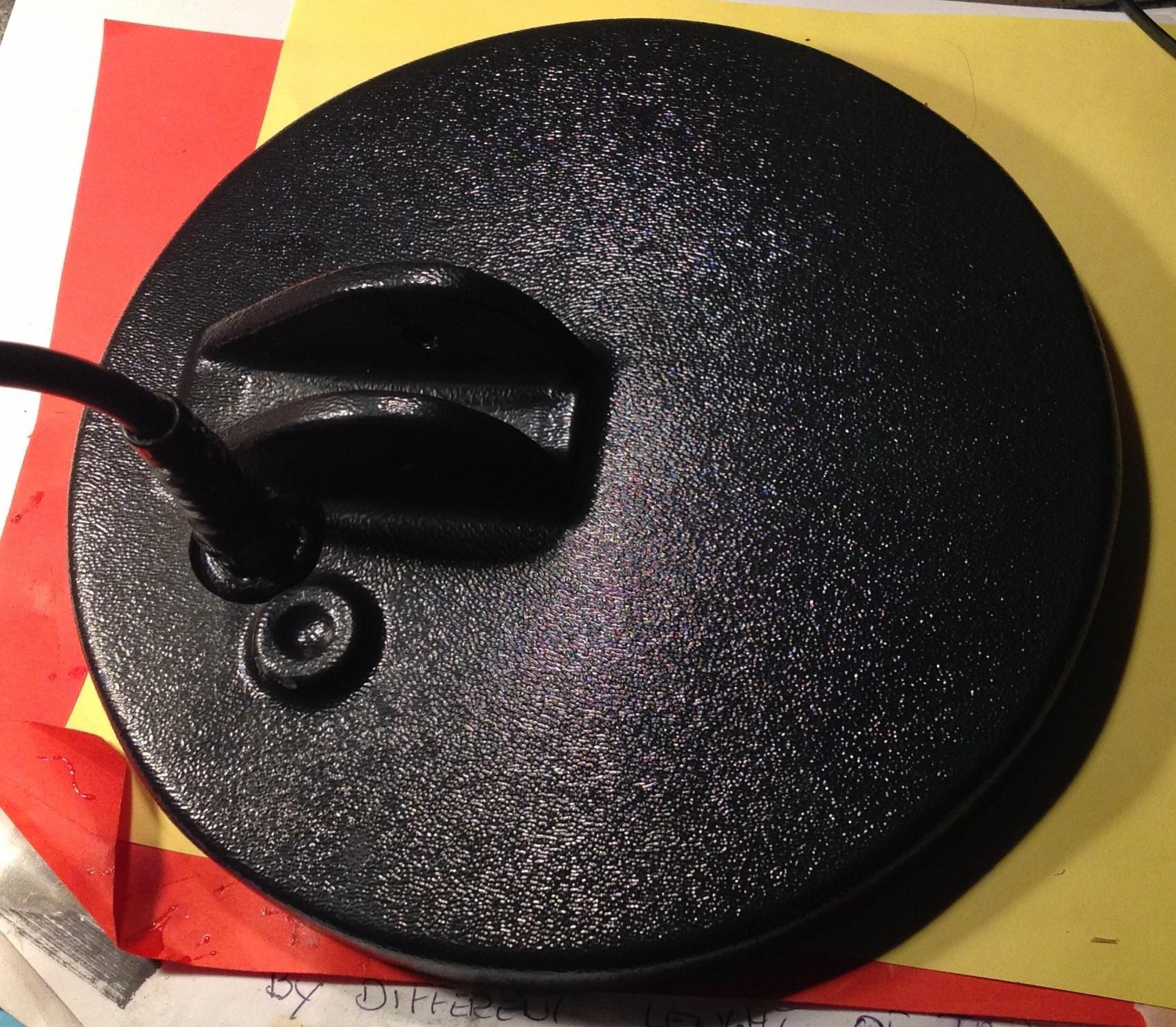

Hmmm, Yea ran into that problem with my first THREE coils.. Mine were not for the XP though, so cannot help there, but maybe your grounding configuration.
Wet grass was driving me nuts until I changed wiring configurations. The cure I came up with was using a Metallized Mylar survival blanket and keeping Tx and Rx shielding separate all the way to the cable connector on the control box. Below are llinks to my "wet grass" testing.
Bad coil : https://www.youtube.com/watch?v=XhRboS639no
Fixed coil: https://www.youtube.com/watch?v=7UBOca3btMw
