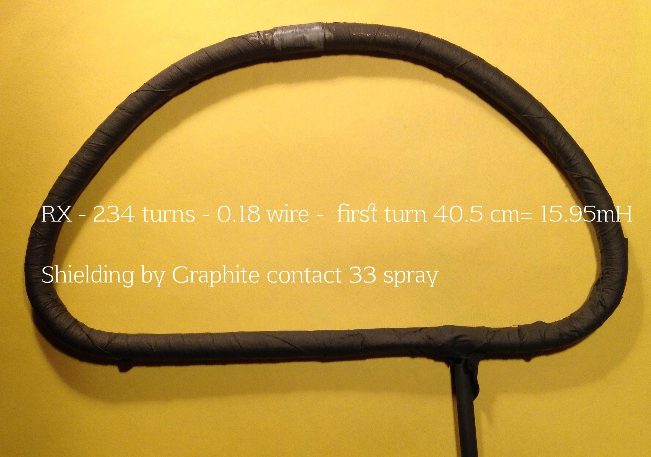

                      Just now the first try of shielding at the RX is drying up. Ive made a new version combinated with some old tradition Sheilding.
                      Graphite spray at some tape with a Very Very thin cobberwire (solderbar). Paint - Dry up - paint - Dry up, until I get around 1 kilo ohm approxly. Made a plastic tube and cut it in two parts... This is made to make the RX coil Very stable and to get a distance between the windings and the graphite (capacity). I remembered to make a tape, to avoid the Sheilding makes a loop.
                      No clue If this will work. If not its easy to remove and try another version.

                      • It's a good idea to twist the two wires from the RX coil together, from the coil to the screened cable. This will reduce EMI pickup.
                        • Done Skippy, even they are Very short from coil to the connecting at the cable.

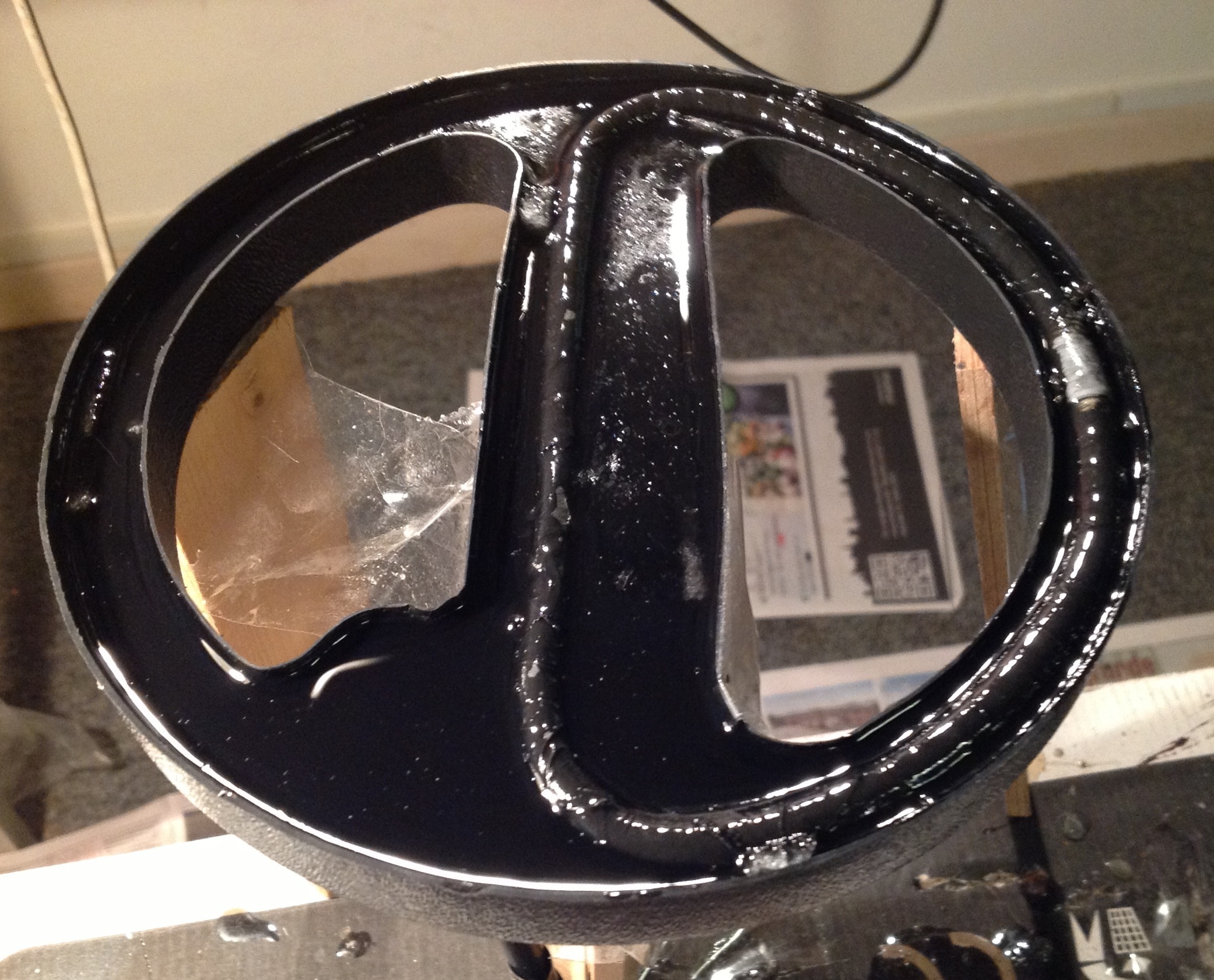

                              I got some more good news. You all know how difficult it is to keep the perfect Null while the sealing is drying up.
                              Mine had now been drying up (I closed it last Night) some 8 hours and this morning it still with the perfect Null. It had not moved anything. This recommendation fra Donald B with the Black 2 component Compound is perfect. Thanks Don. http://www.circuitspecialists.eu/bla...ating-compound
                              I hope that I dare to test the searchcoil outside after work this evening.. But the sealing needs 24 hours, so it could Be stupid to try anything before its proper dry. Just in case that I need to finetune, I havn't fill the Shell up 100%, it still need some 4-5 mm.

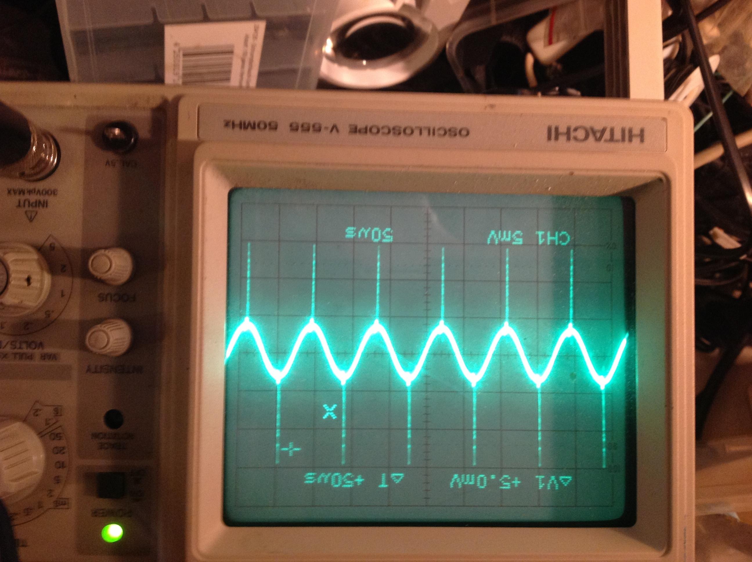

                              thats why you can see the RX Very high up at the picture 1. (Maybee a little to high)
                              The Null is 8-10 mv PP. not bad. Picture 2.
