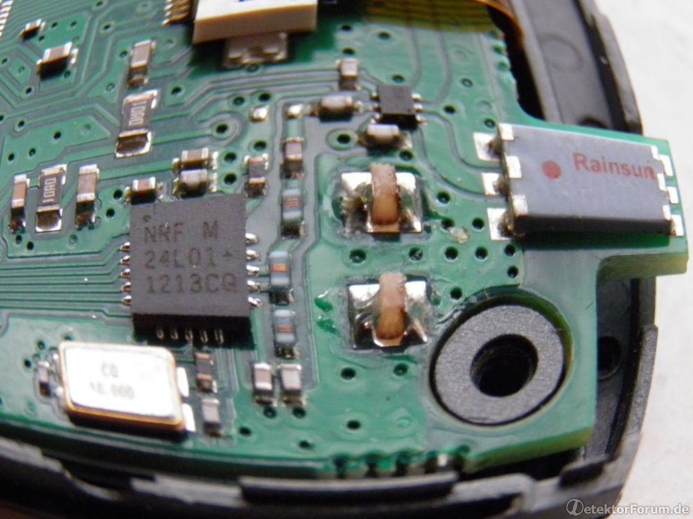

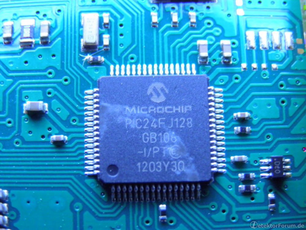

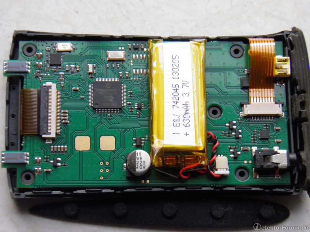

  • does anybody know what chip is used inside the deus' remote control box (probably also some sort of PIC) ? Maybe somebody has opened it and took a picture of the PCB?
    • No - not the Remote.
      • found some more pictures of the microcontrollers inside the headset and remote:
        The chip for wireless communication is a nRF24L01, maybe one could build a custom remote control ^^

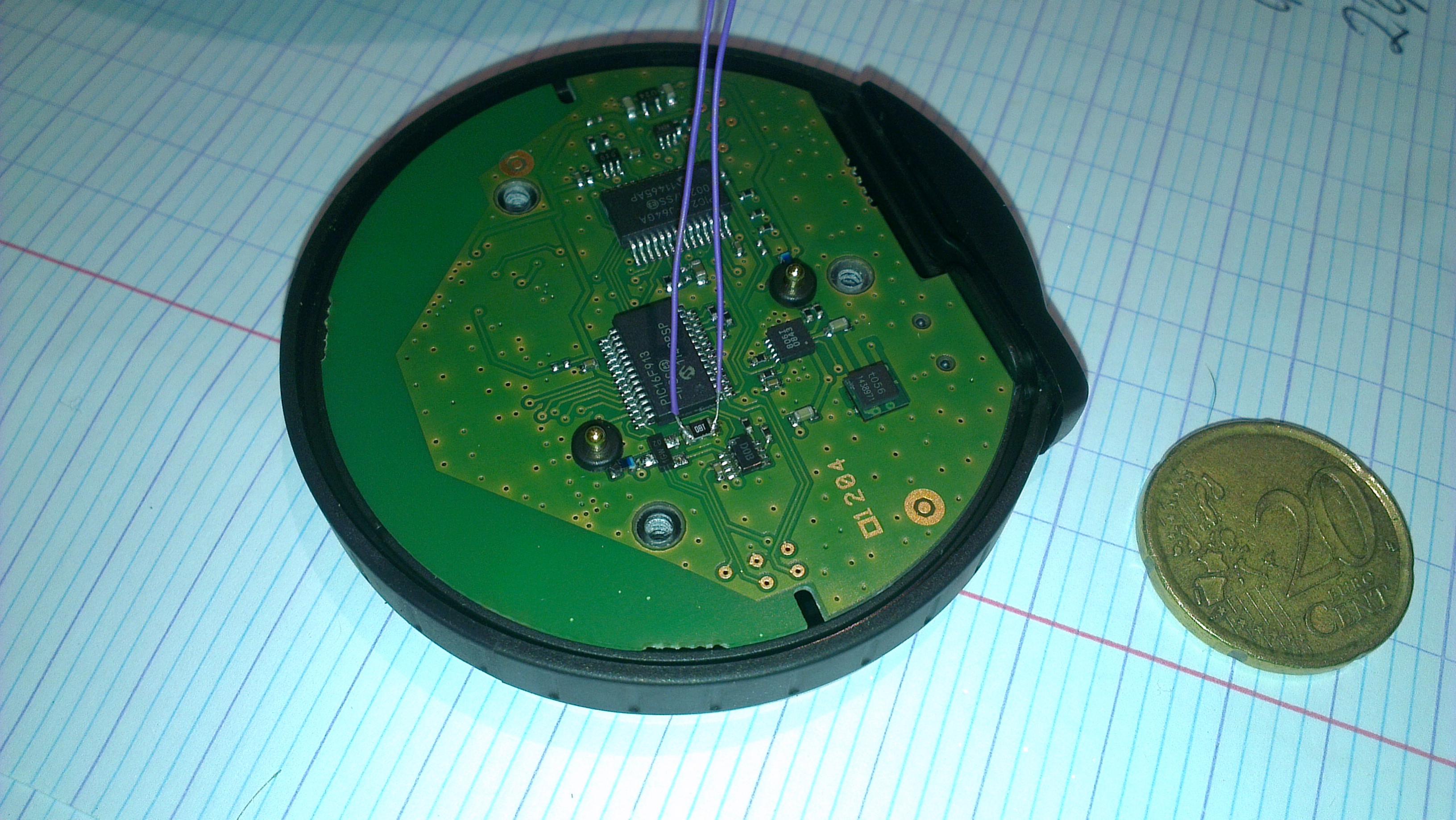

        • @Henrikas: Did you see any amplifier for the TX on the coil PCB?
          • Hi Sled
            No I did not see it. There was a lot of silicone I didn't remove.

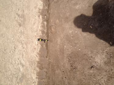

                              • Thanks Skippy..
                                The articel by danskowski was new to me. Very Very Interesting and many "aha" and thats why.

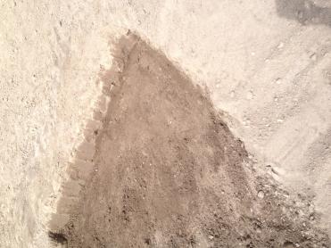

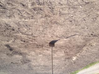

                                I had my self a similar exsperience with the Viking silver coin hoard I found. First 3 coins came up (Shallow) and then it stop..no more signals only a lot of Iron. Then I startede to dig iron in the central area and no 4 coin came up.
                                I knew that there had to be more deeper down (or masked) but I couldn't find them, and I tryed 2-3 detectors and small coils. No succes. Only chance to find more was the hard way, taking dirt of cm by cm and dig ALL signals.
                                The 3 pictures showing a area I worked with. It was hard working but Big succes, "one" more coin came up.
                                It could had been masked or to deep, I dont know.
                                The end of story after the museum came in, and the hoard (spread one) was up some months later, it ended with 42 Coins.
                                This exsperience the summer 2015 was really a eye opener, to the subject IRON (or trash) is masking.
                                Okay masking depends the coin size or other finds, compaired to the iron close og just near. In my case those coins only was 20 mm and had the weight of 1 gram silver. That not much and properly the reason it was difficult.
                                ps. Sorry the pictures turns up side down or 90 degress.. I dont know how to turn them.
